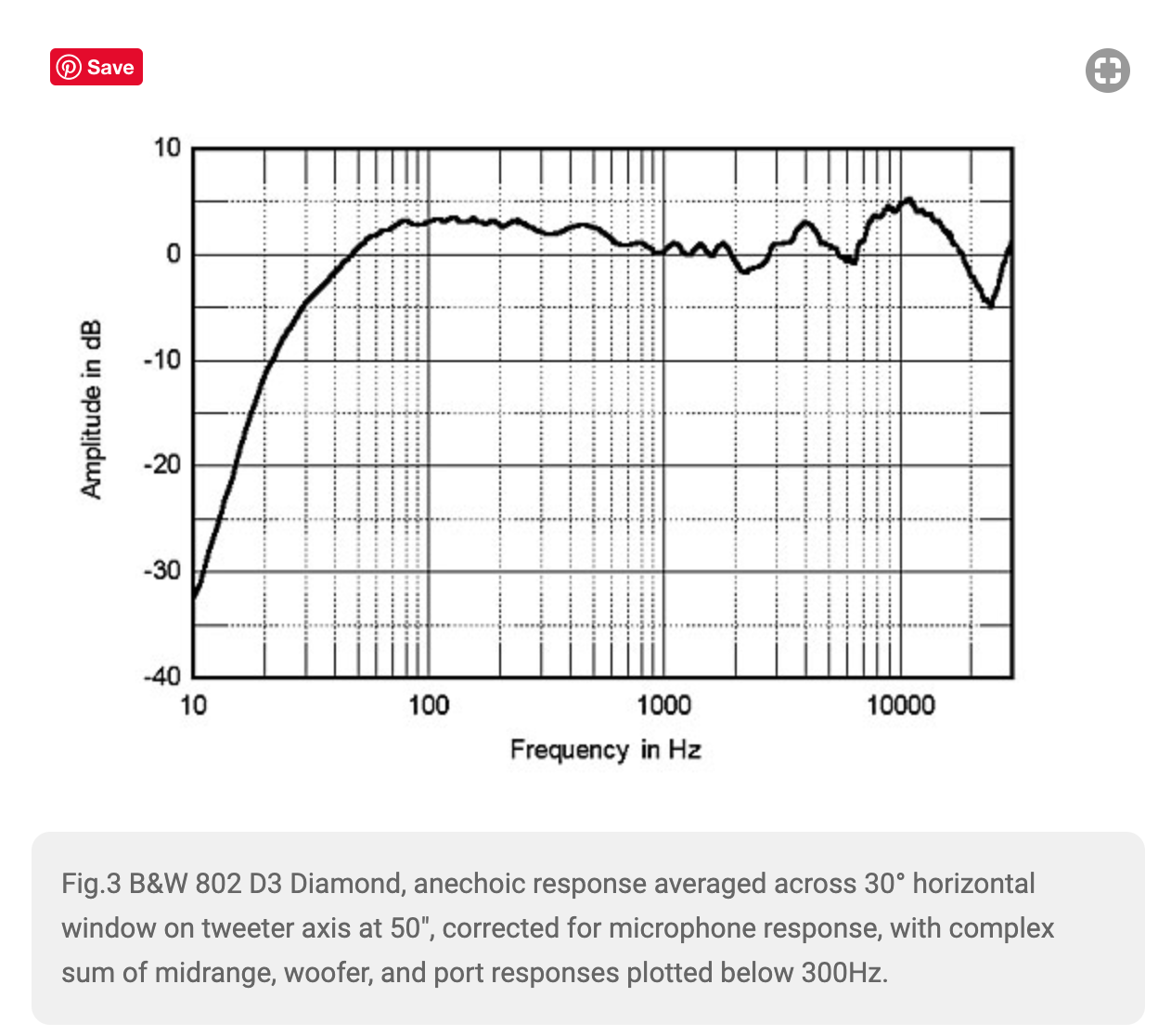

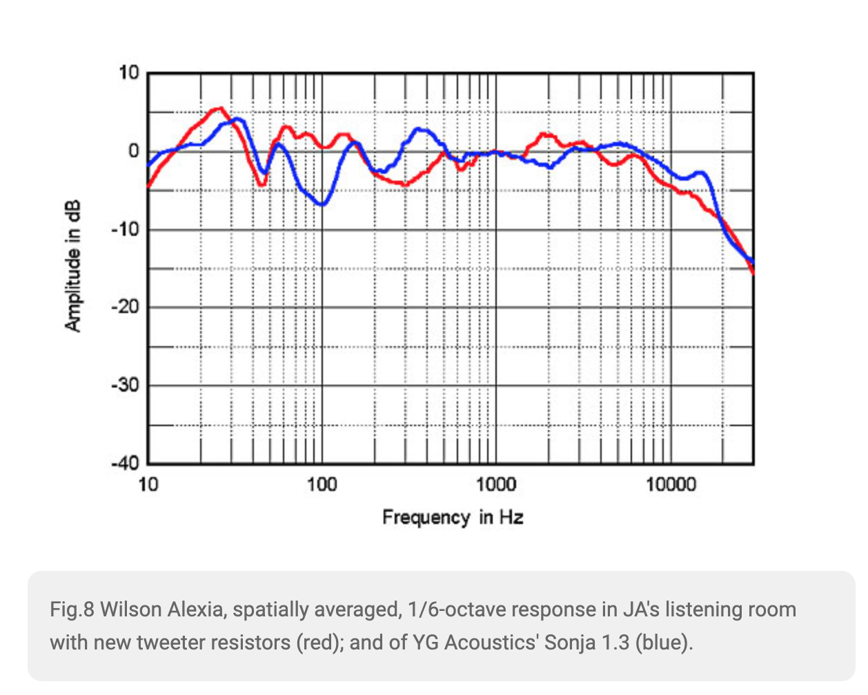

Eric I think the frequency response curves look good.
This is the frequency response of the Bowers & Wilkins 802 D3 Diamond, a 2019 Class A component according to Stereophile magazine.
The Bowers & Wilkins 802 D3 Diamond retails at $22,000 the pair.
Bowers & Wilkins 802 D3 Diamond loudspeaker Measurements | Stereophile.com
I would want to do some eq on this set of responses and look at where they are pitching their 0dB reference in this design. Speakers further down their range look far worse than the results you are getting
