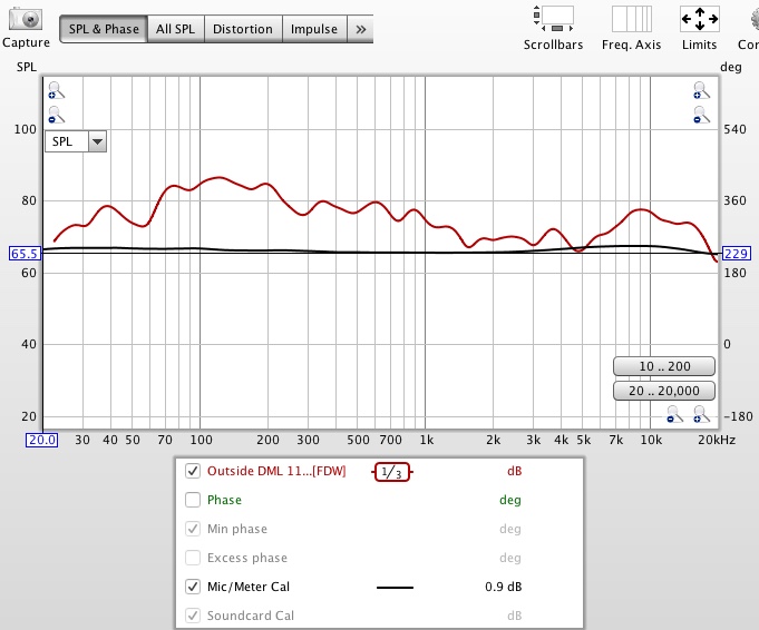

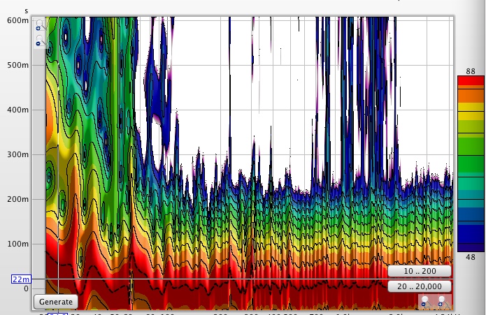

frequency response of my panels
Here is the REW measurement of my panel it is near field ~1 meter in front of the panel and input set to 65dB I have done some DSP to achieve a "flat response" I will have to get back on what the frequency setting are since it is a home brew DSP using a TI DSP chip...
The spectrograph is not the current experiment of just one tone as it is the sweep frequency measurement. The sweep frequency measurement is showing a pretty uniform sound field emitting from the surface and then start to see the reflective effects of the surrounding.
Steve
