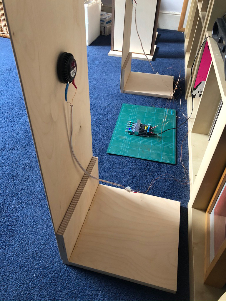

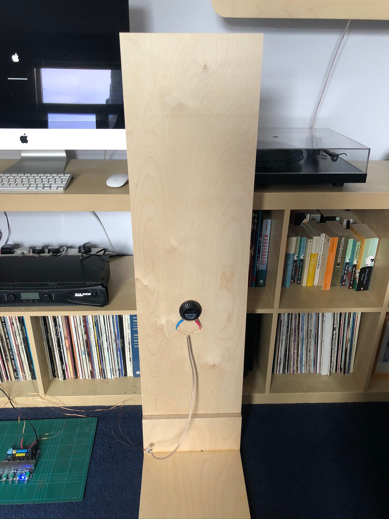

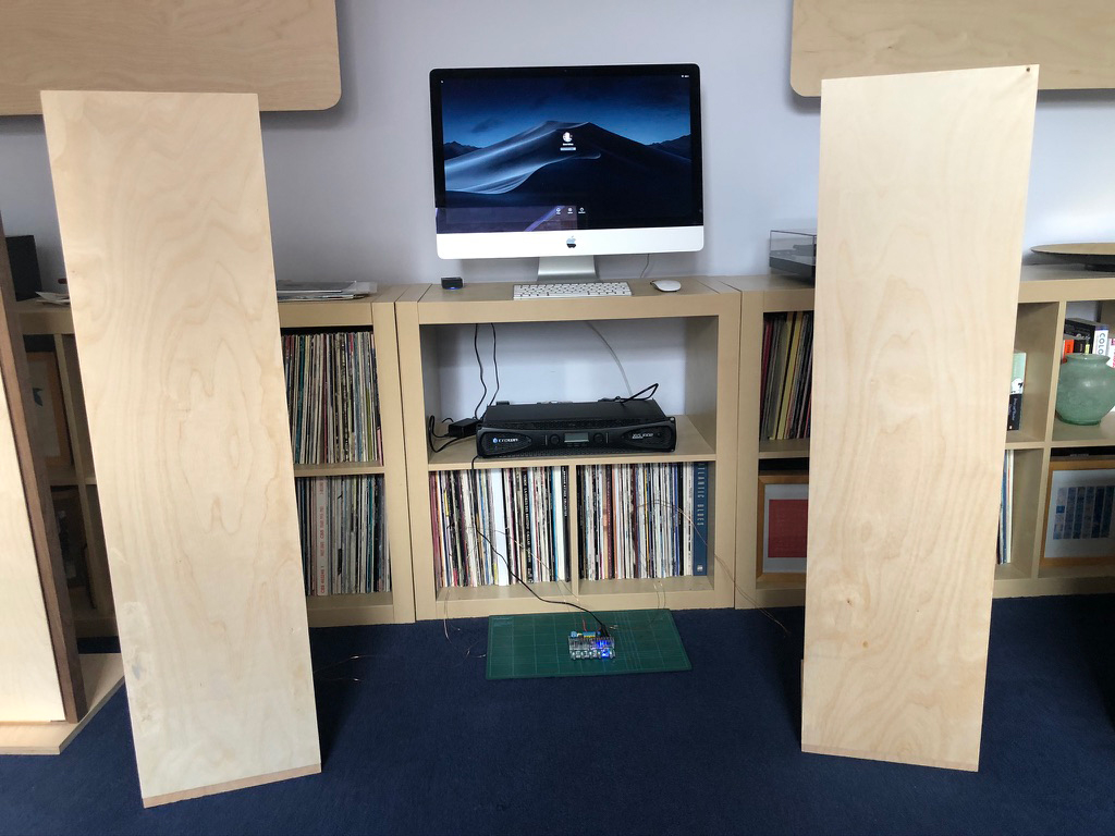

I tried another experiment today which some of you might be interested in.
A couple of comments first on my design objectives because I have not always made this clear.
Firstly, this started off and remans an experiment to see if you could get good quality sound from a format that would fit into the average home, which forces you away from the accepted best ratio of 1:1.618.
Secondly, along the way I stumbled over a ratio that had a better bass performance than my large 1200 by 600 panels, which came as a surprise to me and was not a design goal but an interesting discovery.
But having discovered a new ratio with potential I want to push this ratio as far as it will go, not to be controversial, but simply to explore the boundaries of what will and will not work with DML’s. Thats because I have a hunch that this technology is remarkably tolerant, and offers us a huge design space to explore.
That includes discovering how minimal you can make a floor stander before it stops performing.
In a previous life I developed design methods that strove for the utmost simplicity, which is why I like the suspended approach for all its problems.
So this is as far as I have got to date. A tall panel on a simple stand. No frame. No Spine. No damping. Just tall Scandinavian Birch ply and an exciter.

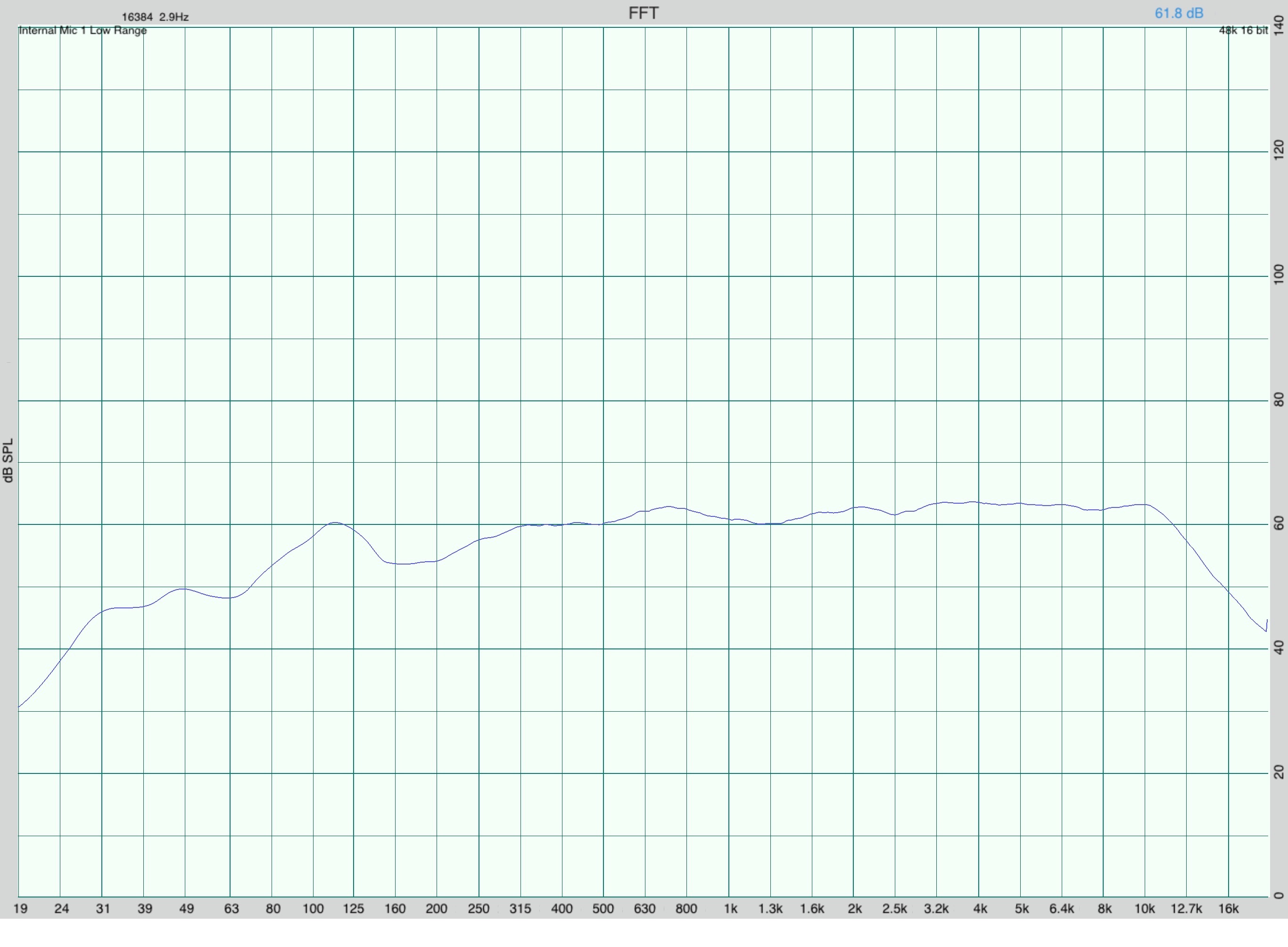

I have included an averaged FFT scan of the raw panels response. I have also included a couple of very rough recordings so you can hear for yourself. They are not great recordings as there are noises off ( including a Spaniel snoring) and the room is inevitably having effecting the sound. Listening live the panels sound cleaner and more spacious, but it will give you some idea.
The recordings includes a small amount of eq at 60 Hz and 30 hz to level up the frequency response in those regions to mimic the response of my Bowers & Wilkins CM1’s

Hi BC,
Thanks for uploading the sound files. I love the look of your "Tall Blonde" speakers - perfect name for them. You need to play some Diana Krall to go with that. I got a sense of real bass from that. The vocals however, seemed to lack a bit of midbass - it might just be the effect of the room though. Your FFT shows a very uniform response so I am surprised it sounded off on the vocals. What amp are you driving this with? If you can try and connect a decent Class AB rather than a cheap Class D that would be interesting to see if there was a difference.
Regarding constructon - we are now looking at a simple cantilever support from the entire bottom edge. Is it glued along the whole edge? I wonder if for instance, a sheet of wool felt along the bottom edgee and clamped with spring loaded bolts at say 3 places might make a difference to allow it to resonate a little more freely? But this has now a classic 1/4 wave cantilever and the bass might actually go deeper relative to the length because of it. This may have double the bass extension of a floating board which is at best, a 1/2 wave resonator due to the freely supported end boundary conditions.
Is the recording made with something like a deidcated XY mic digital sound recorder? If you ever get a chance to do that - it makes a huge difference in the stereo presentation. They are getting a lot cheaper now (like a Zoom H1n). Years ago, I uploaded lots of sample sound clips on my Virtual Blind Audition speaker threads and ran into a DIYA max file size limit of 1.8MB. It seems to not be such a low limit and they now allow .mp4 file extensions. Back then I had to rename mp3 files to .asc files and people had to rename them to listen.
Thanks!
X
Thanks!
X
Hi BC,
Thanks!
X
Thanks X!
The recording is done on an iPhone and I agree the vocals sound a bit off to me as well. I get much more air and tonal richness listening live. I have just received a UMIK-1 mike today so I can get serious about measurement and recording. Better next time I promise.
The panels are just taped to the base upright using foamed tape-1mm thick max. I agree a damping layer between panel and base would be better. I am going to explore this format more as I think it has potential. More news latter on that.
Currently I am driving them with a tiny Class D. I have a Copland Valve amp for serious listening but the baby D does a good enough job I feel. It’s also much easier to lug around when I move the panels into different rooms. I also have a Hypex amp, a Crown which is surprisingly good for the price and some of the original Tripath modules that took the high-end by suprise when they were launched.
Thanks for the feedback. It’s always helpful and together we make progress.

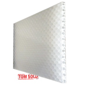

The PP honeycomb panels (with polyesther top) are even lighter and stiffer then foam panels, but would they be better then foam?
0,65kg/M² - 10mm thickness - €36 + vat. (2500 x 1220 x 10 mm)
Gluing wood veneer on it instead of glass or carbon fibres, sounds like a good idea to me.
Burnt,
Way cool. That's too simple NOT to try myself. I assume the panels are the same dimensions as your original framed "tall story" panels, correct?
Birch Ply DML Panels - 300mm by 1160mm by 4mm B/BB Grade
Maybe even the exact same panels?
How did you attach the panels to the base?
Thanks,
Eric
Yes Eric the dimensions are the same. The panels are stuck to the upright face of the ply base using three strips of 50mm foamed double sided tape. I am experimenting with elastomeric damping on the edges immediately adjacent the exciter as with heavy bass the edges flutter visibly
Just to add that I am seeing a displacement of up to 3mm on the exciter without a spine. Doubling up the panel and exciter brings that back to manageable levels and four panels, which I admit sounds nuts, and we are back to circa .75 mm maximum displacement which is trivial. This allows for very high volume with bass without stressing the exciters.
Although that sounds like a lot of panels if you are wall hanging them it’s feasible. I tell the wife I am planning an art installation.
