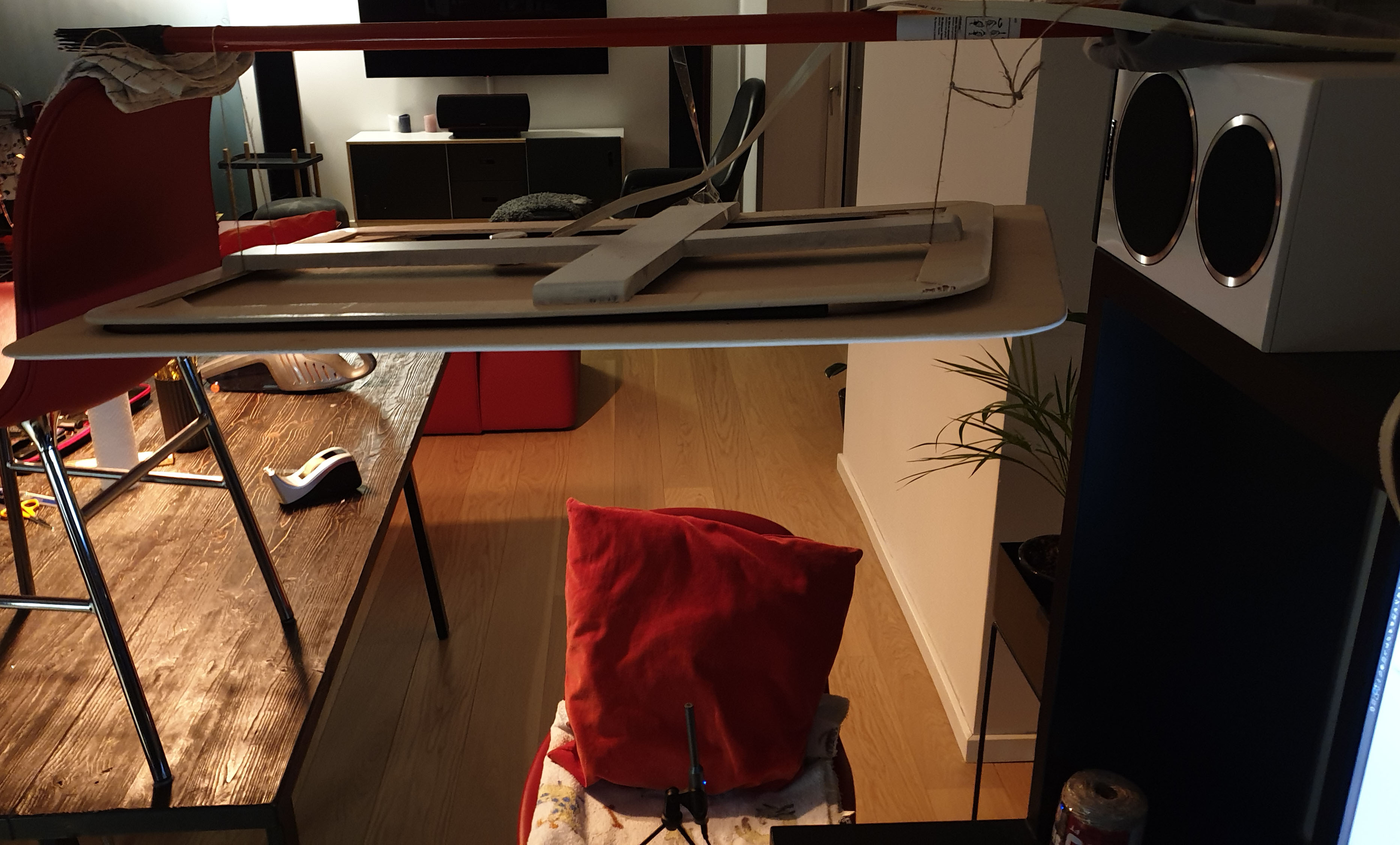

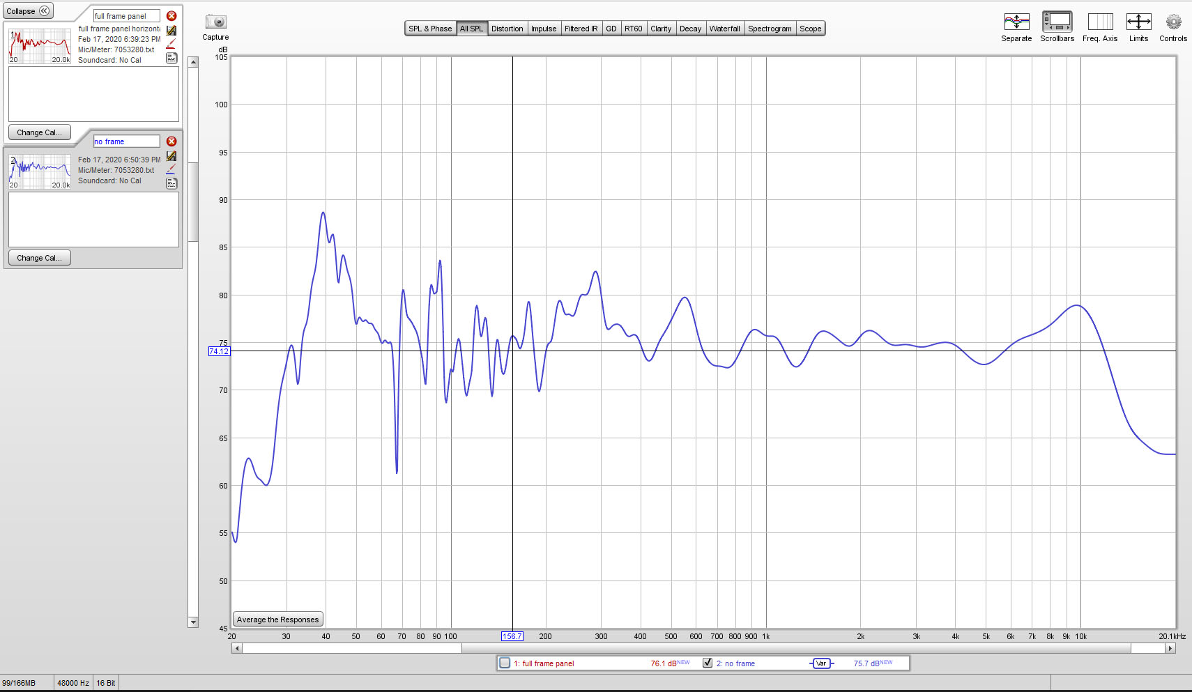

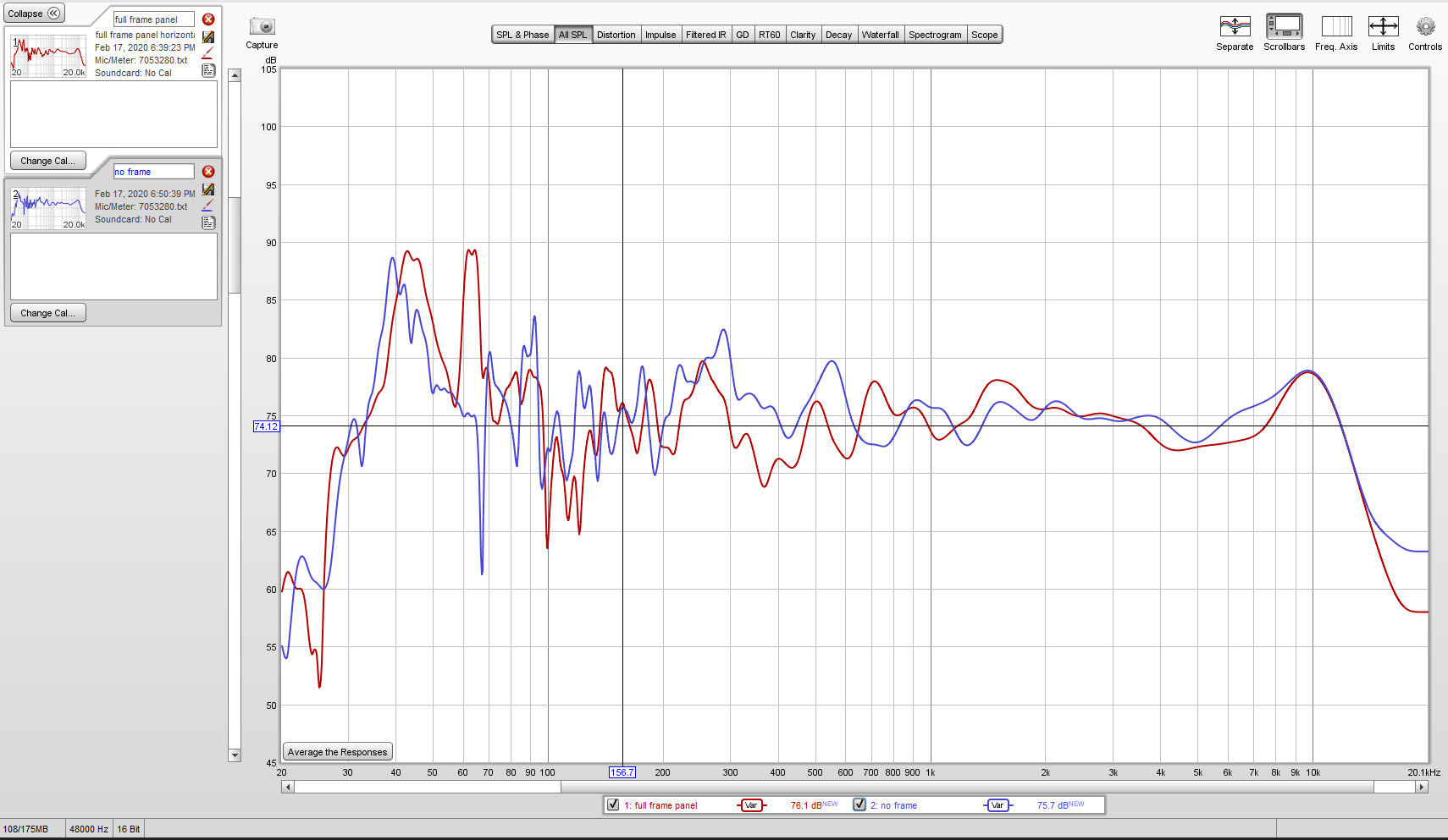

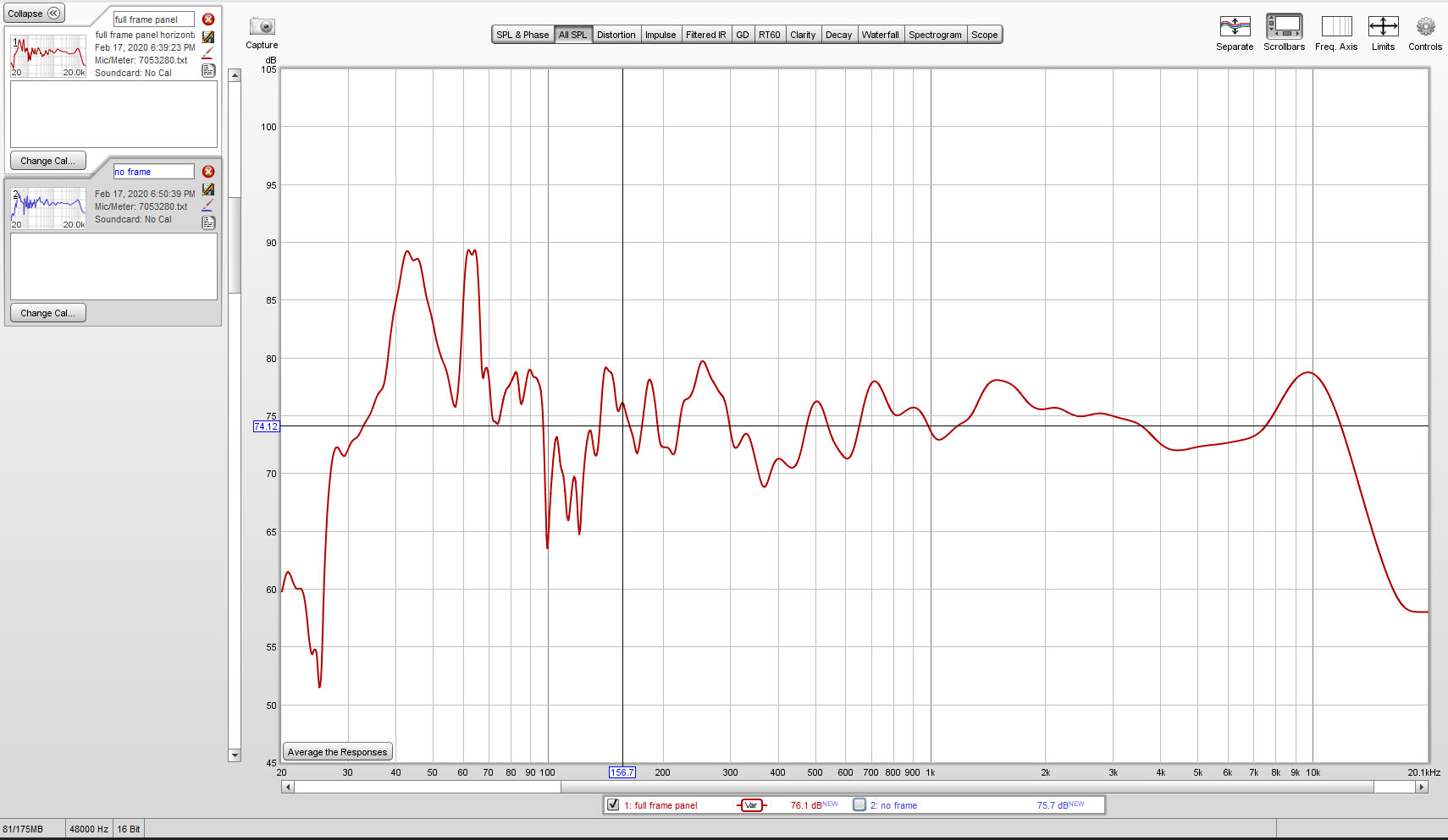

I finally got a moment and got my Umik1 up and running.

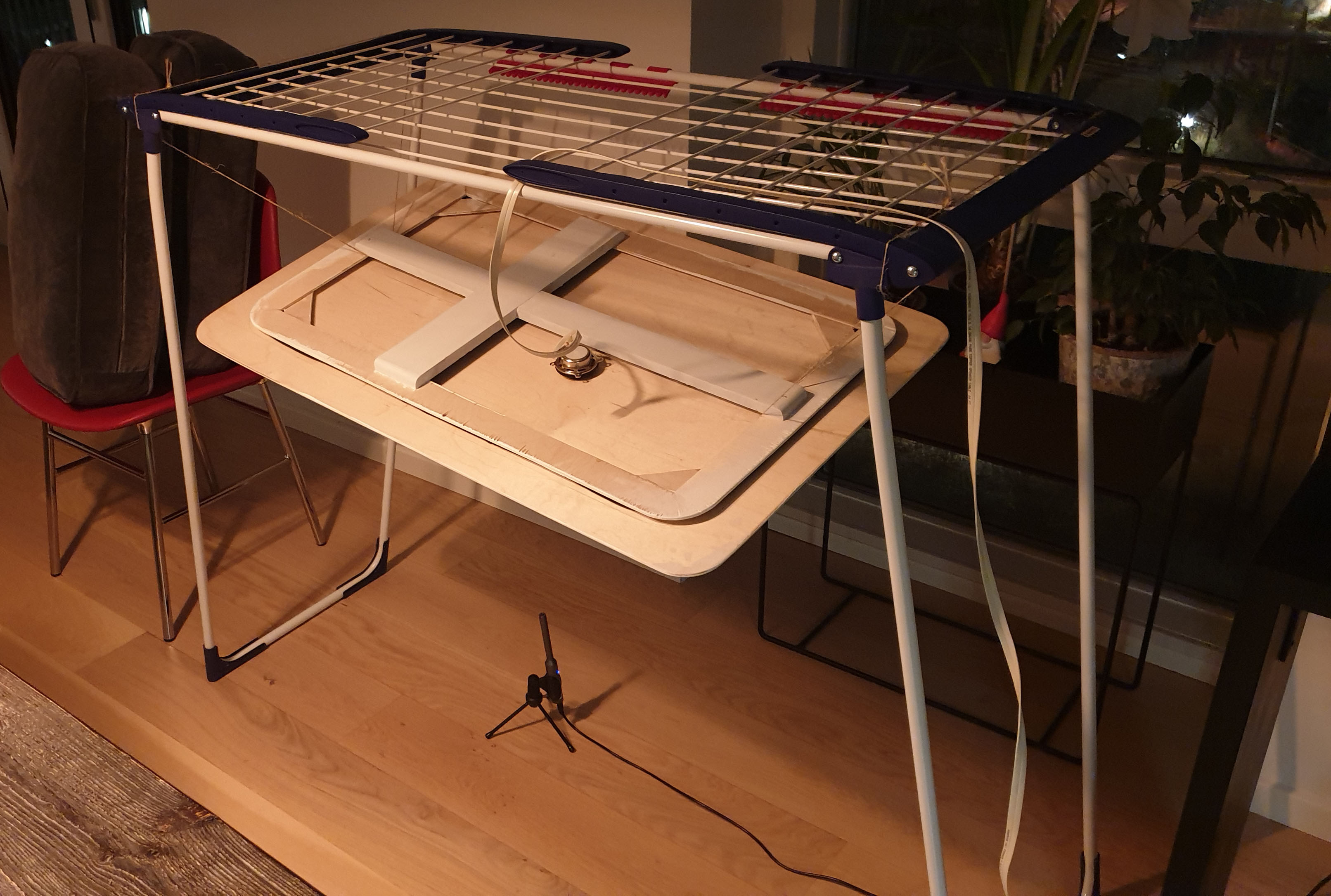

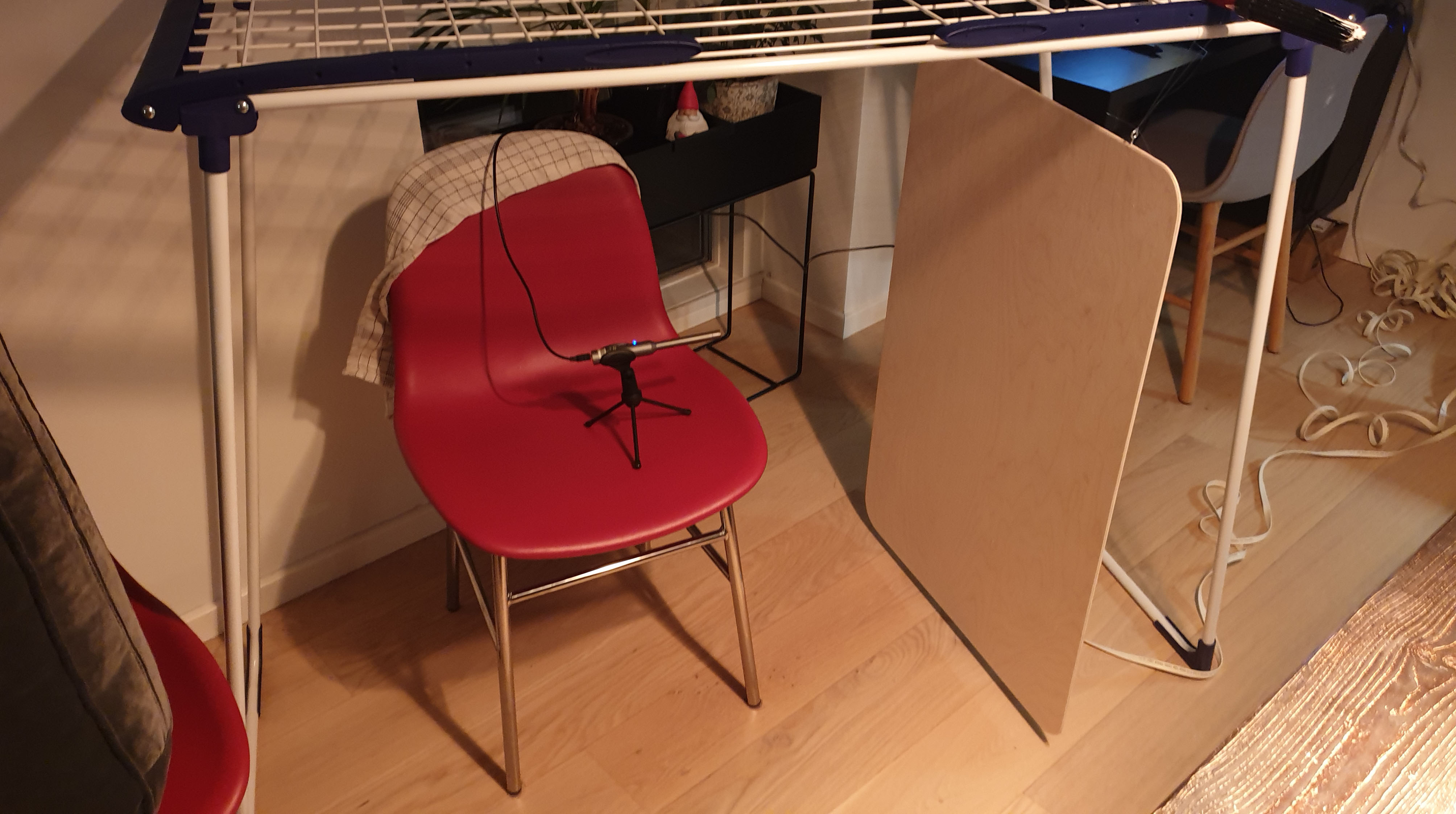

I tested my very simple panel with no frame against the same panel with my prototype frame (not edge mounted).
I preferred the simple panel with no frame from my last comparison listening session, but now have some measurements to back that up with.
I found that a tall drying rack is an excellent testbed for horizontal panels.
Red is the framed horizontally mounted and blue is unframed hanging vertical.
No EQ has been applied.

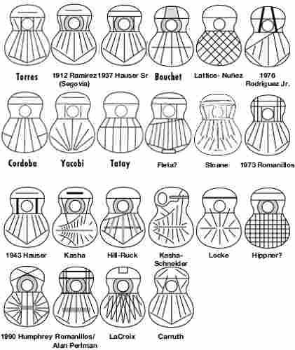

Just Google it, top quality concert grade instruments, usualy very expensive guitars are doubletop designs. But I am not aware of any factory made panels... only luthiers make it for guitars...
Good panel probably would be double top classical guitar board - nomex honeycomb sandwiched between two thin sheets of solid spruce or cedar. Doubletop guitars play louder...
The solid sheet of spruce or cedar looks to be thicker then the Nomex honeycomb. If the skin is too stiff the Nomex honeycomb wont bend as easily therefore less bass.

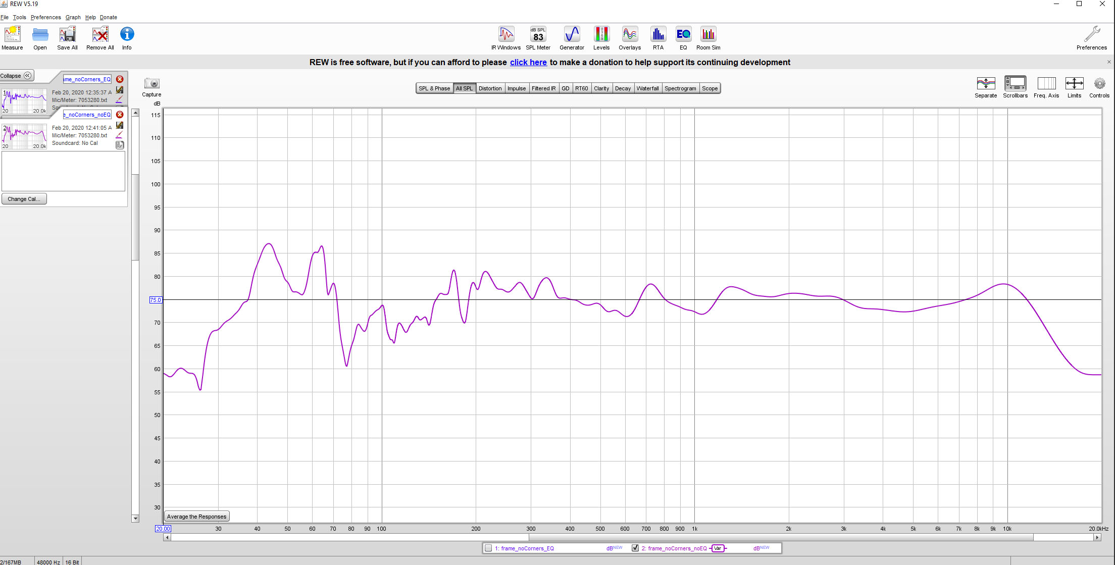

I'm looking for some plywood board REW measurements to compare to.
Does anyone here have any? I've done mine around 75db from 20-20.000hz.
I'm trying to manage where my expectations should be in terms of low frequency control and output and where to cross over on my 60cm x 90cm 5mm thick birch ply panels.
Right now i'm getting a nice mid-range and a high frequency that I can manage with EQ, but up to about 200hz the curves are not pretty.
I'd like to cross over closer to 80, but I'm concerned that will not be feasible.
I'm still fiddling with designs to improve the low end, and while my first framed mount (mounted 2 inches from the edge) was not great, i'm still considering an iteration of this, as they seemed to implement better control in the lower frequencies.

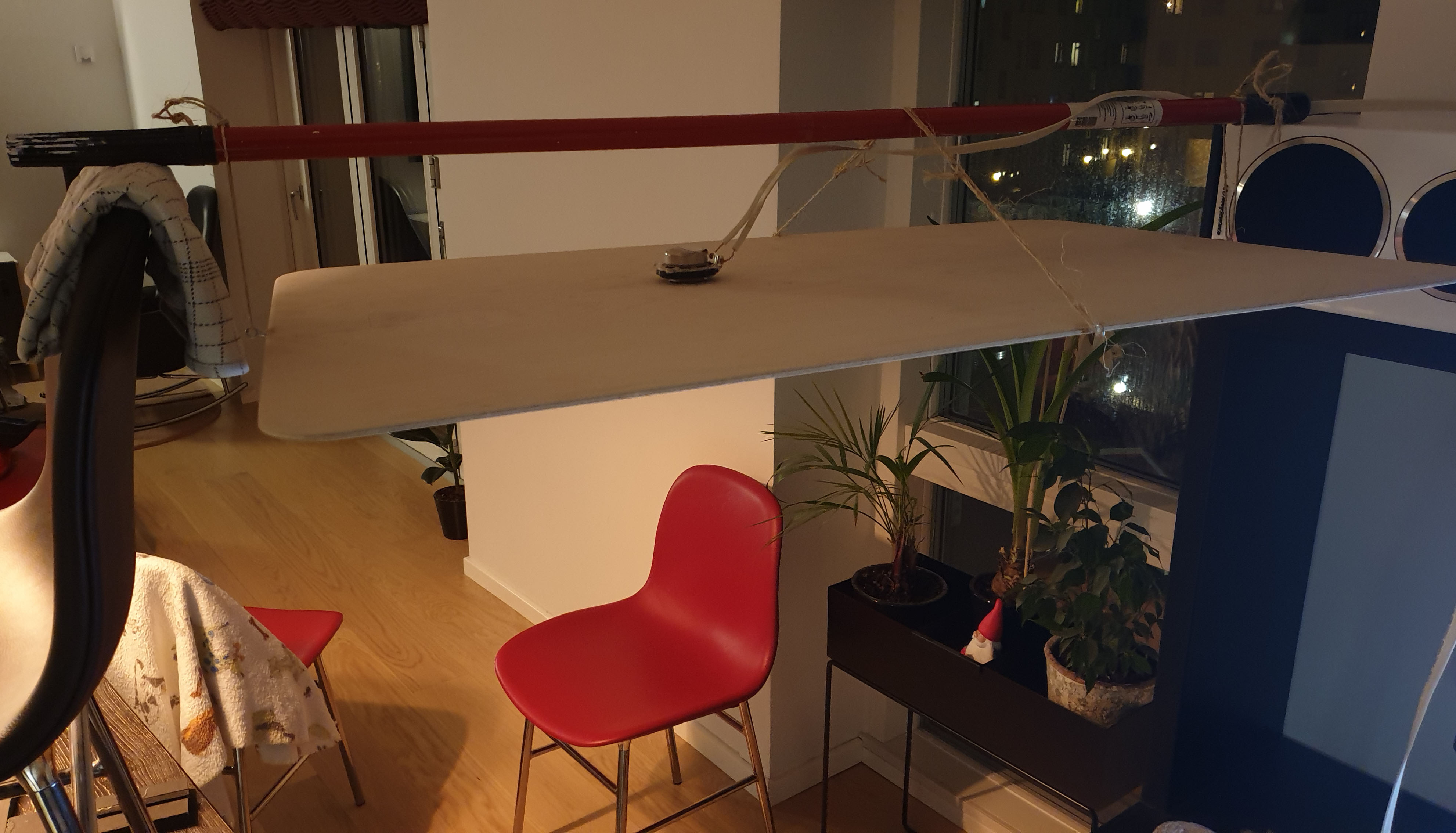

Also, i've tried mounting them with strings both vertically and horizontally, and this unsurprisingly only works well vertically, which is not how I intend to apply these panels.
My next attempt is to reduce the amount of rubber on the frame to limit the over dampening I was getting from my poor frame placement, as was mentioned here, about 60% on the long edge and 75% on the short.
If this doesnt yeld any improvements, I'll be doing a frame closer to the edge and compromise the WAF!

What happened with the horizontal panel and vertical strings? I was skeptical it would work mainly because the strings would be going slack whenever the panel flexed up, then suddenly go taught when it flexed back down. Doesn't seem ideal, but that may or may not be the issue you faced.
It's not unusual for DMLs that the the low frequency is bumpier than high frequency. The reason frequently cited for this is that the density of modal vibrations of a panel is much greater at high frequencies than it is at low frequencies.
But I wonder if something else isn't influencing your observation. I noticed that in your REW plots you applied VAR smoothing. That's actually a choice I've never even noticed before. But it apparently applies less smoothing at low frequencies than at high frequencies. Of course, there is no "right" or wrong smoothing, but some make more or less sense depending on your objective. I tend to use Psychoacoustic smoothing most of the time, because it supposedly most closely mimics how our brains process sound.
Maybe you chose VAR purposely, but in case you did't, I wanted to call it to your attention.

Thanks for the reference to your build, I remember seeing it a while back when i was going through the whole thread and thinking it was a very nice solution.
I went ahead and removed the rubber from the corners, it's now roughly 60% on the long side and 70% on the short.
This made quite a big impact, and I feel like the lower range also went into EQ-able territory and it's generally flatter then I expected.
It's still a little more lower in output then the free hanging one, but It can still play louder then I need it to, it will just need a bit of a volume boost along with the EQ on my receiver.
I'm using Var smoothing because I picked that up from a youtube video (6 minutes in):
YouTube
Apparently he is claiming the same thing as you 🙂
I saw another video that I cant find right now which claimed that var-smoothing was more correct when creating a correction curve for DSP. I honestly don't know which are accurate, but I got used to seeing this graph now and got a feel for it.
Graph is the measurement without EQ.
Picture with the framed panel is the result of the attached graph.
Picture with the stringed up horizontal panel was not great, as previously mentioned.
