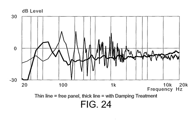

Great find twocents! The image I have attached from the patent is exactly what Veleric is talking about.
That patent may indeed have been where I first got the idea to try substantial damping. But this article is the one I was thinking of:
The effect of different combinations of boundary conditions on
the average radiation efficiency of rectangular plates
https://eprints.soton.ac.uk/369232/1/Eprints.pdf
I'm not sure how I found this one originally. Maybe it was from you, Burnt.
Of course, as said for the paper I just linked to in my previous post, my interpretation may be flat out wrong. But it looks to me like a pretty high level of damping should at least theoretically be favorable.
In the case of this article, they are talking about the intrinsic damping factor of the panel itself, and not local or perimeter damping.
The paper seems to be suggesting that if the correct amount of damping is built into the panel (say on the surface, or internal to the structure), the panel would provide louder, and smoother frequency response.
If true, I think one big challenge would still be to get that damping without adding too much weight to the panel.
Eric
