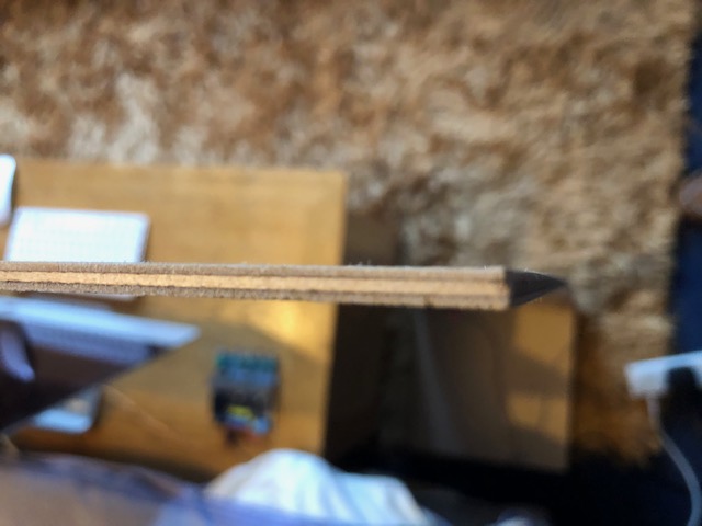

One concern I would have about the tall blonds is that they would be pretty susceptible to warp with changes of season. That's an additional reason why I personally would lean towards a frame for a plywood panel.
Birch ply is probably the best plywood in that regard, but still even that warps. The more plies the better of course. I'm curious about your 4 mm birch, however. As far as I know, the typical versions of birch ply are 3 mm (3 ply) and 6 mm (5 ply). I haven't seen 4 mm at all. How many plies are yours? Did they come from a specialty source (model aircraft?).
Eric
I got the sheet from here Eric
Russian Birch Plywood Cut To Size
The specification was BB/BB, EN 636-1, EN 314-2 Class 1
Not a lot of help where you live I am afraid but perhaps the supplier could put you in touch with the Mill to see if they ship to the USA?
On warping I will wing it and see. The loft room goes through some major changes in heat and humidity over the year so it will be interesting to see what shape my bigger panels are in when I get back to France in a couple of weeks time.
You could always try Gaboon Marine Ply which is highly moisture resistant.
Three layers Eric. I have attached an image of the layers. It was an interesting question in that I had not paid much attention to the board build. It looks very similar to the board construction for the panels in France which are still my favorite panels in terms for frequency balance and bandwidth.
The larger panels here in London have a different construction, three equal thickness and same density ply. The French panels have a softer core ply than the outer plys.
Burnt
