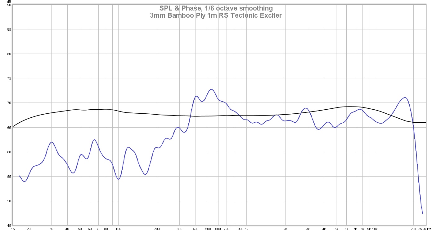

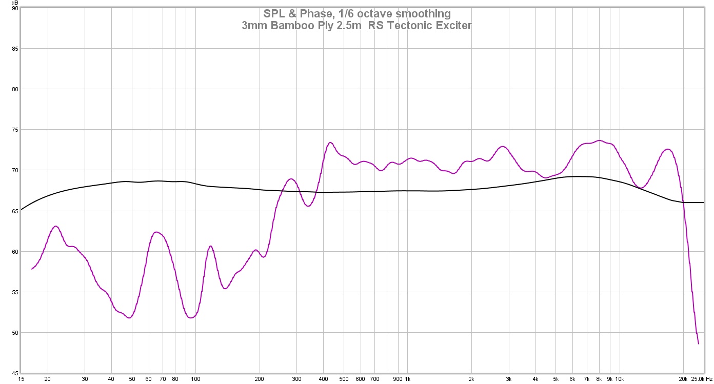

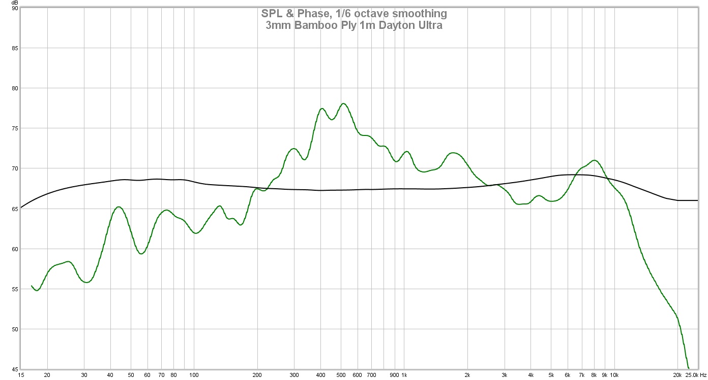

3mm bamboo ply measurements
These results were from test I did about 4 years ago. Shown is the result for the Dayton Ultra and a Tectonic Exciter that was available from RS Components. It is now obsolete. The panel was 525mm high by 385mm wide and the exciter placed according to standard dml theory ala NXT.
Bamboo Ply Panel Ponoko Cut Dayton Ultra Exciter 1m on axis loosely held vertical.jpg142.7 KB · Views: 468
Bamboo Ply Panel Ponoko Cut RS Tectonic Exciter 1m on axis loosely held vertical.jpg143.1 KB · Views: 474
Bamboo Ply Panel Ponoko Cut RS Tectonic Exciter 2.5m on axis loosely held vertical.jpg147.9 KB · Views: 480
