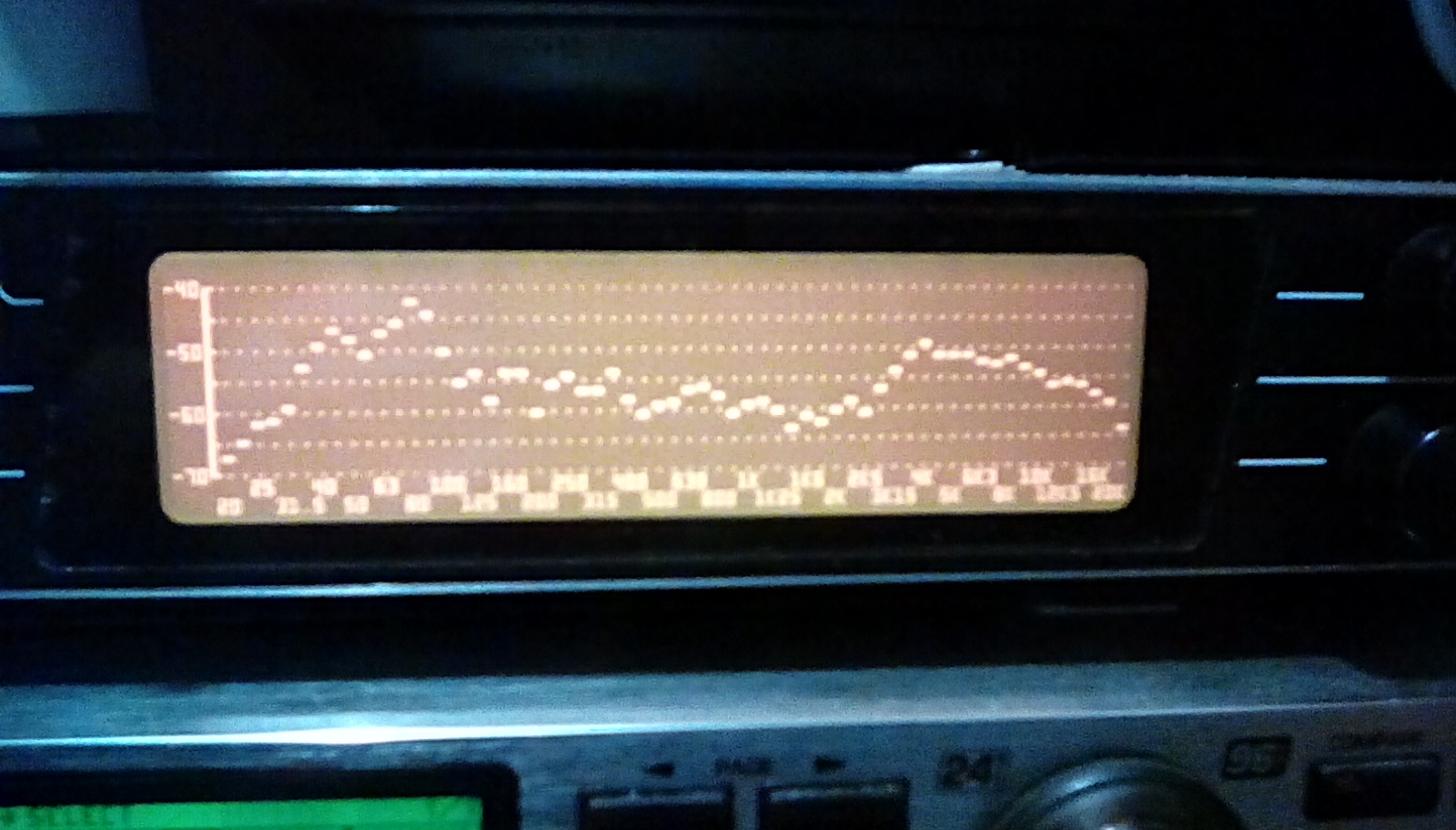

Aaaaa
Aaaaaa!
I presume that a picture will be separate from this post at the bottom .?
Just testing
It should be a picture of the response from the exciter area at the bottom of the tall panel at about 6 or seven inches moving the mic up and down the lower half .
Steve

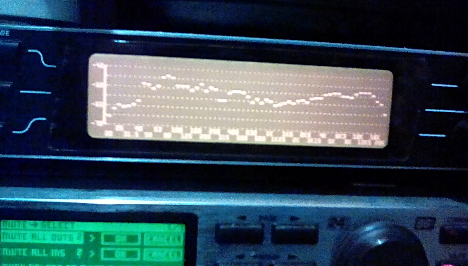

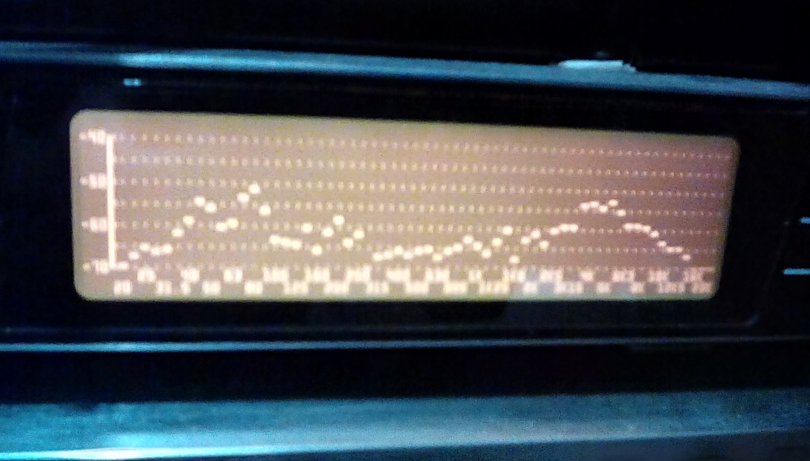

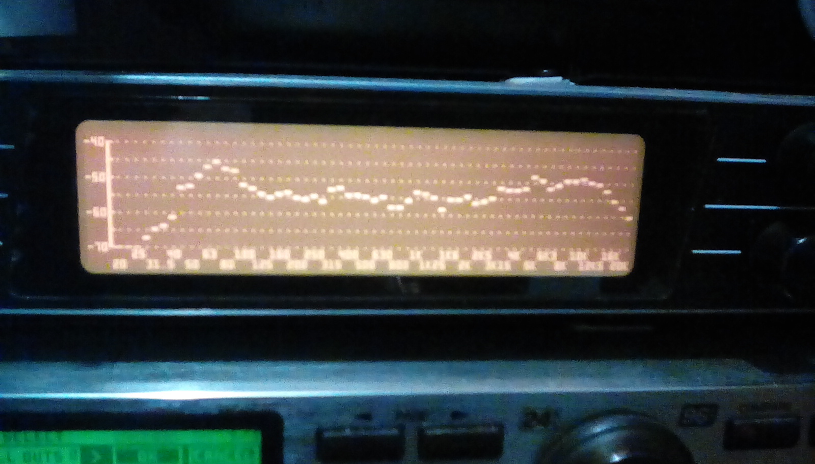

Pics tall panel
Ok good,the first pic on the left is the same as before but the top half only,the half without the exciter on,I haven't shown it but after The last let say about 6inches The LF below 100hz disappeared off The screen!!
The second pic in the middle is the panel turned over so the exciter is at the top,the mic as before up and down the bottom half.notice the increase response
Now the last pic on the right,same as before ,a nice looking response and the response below 100hz held up all the way to the top edge of the panel !!
I hope this isn't as confusing to you as it is to me,I'm used to putting my notes with the pics,hope I've got it right
Steve

Tall panel
I also tried my usual 4/9x3/7 positioning on the tall panel ,this made them sound rather anaemic ,a sub would have to be used or eq.
I have to remind everyone that this was a 5mmm panel with a 10watt exciter held on with double sided tape,I am in the other room posting this and wouldn't be surprised if the exciter has fallen off!
Not bad considering.
Steve
Steve
I agree with gro sand that fr response on the right is excellent. Considering the panel size and the exciter you are using that’s a remarkably even response.
I am sure I have not understood you but in your first image did you sweep the frequency? If it’s not too much bother a low frequency sweep on your big panel from say 30 to 100 would be very interesting.
Burnt

The pic on the right just shows the total response output of the top half of the panel ,it is not a fixed point measurement,if you moved a fixed point mic (usually placed in the middle of the exciter position) to the left or right by a few inches the response would change considerably,so where should you place your mic to find the real output?
For me it is around the room and best of all your seating position.
You could have a very good near field response but when you move out into the room it all falls apart! ,Also different panels (eps ,xps,ply, carbon, whatever,size shape,you name it) will have a different in room response ,the worst usually happens below about 300hz or so ,in my experience anyway.
This is why I usually have my LF speaker,not sub, running up to the 300HZ region no matter what panel I am using ,this smooths out the suck outs dips in the room response.
How low I let the panel go is all dependent on size (4inch up to 5ft) and how well it can cope with usually very loud music, including close mic recordings and electronic music,my exciters can get very hot with heavy panels,small panels will tend to vibrate heavily and buzz if used too low.
