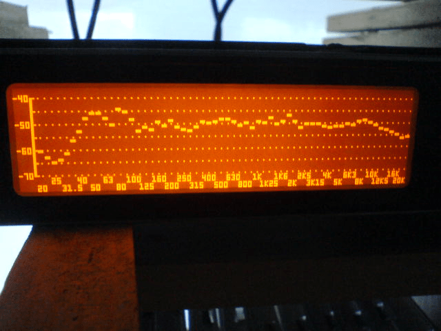

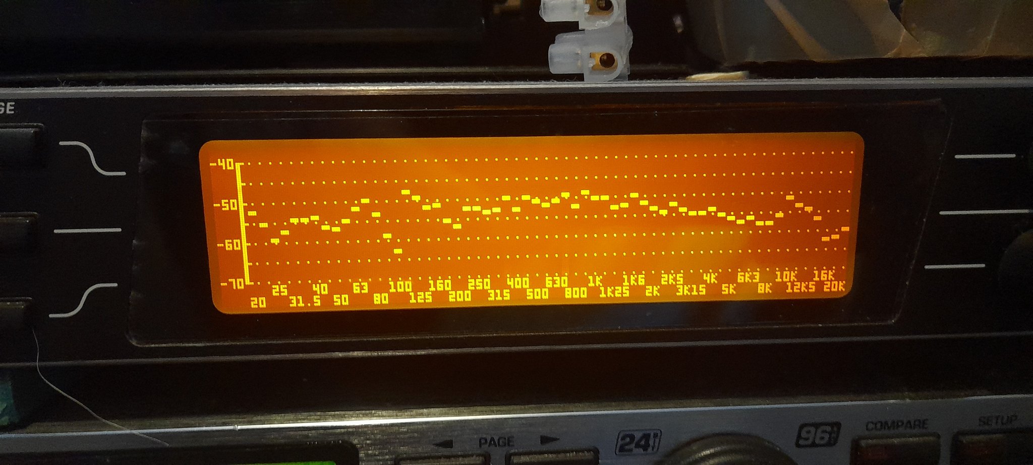

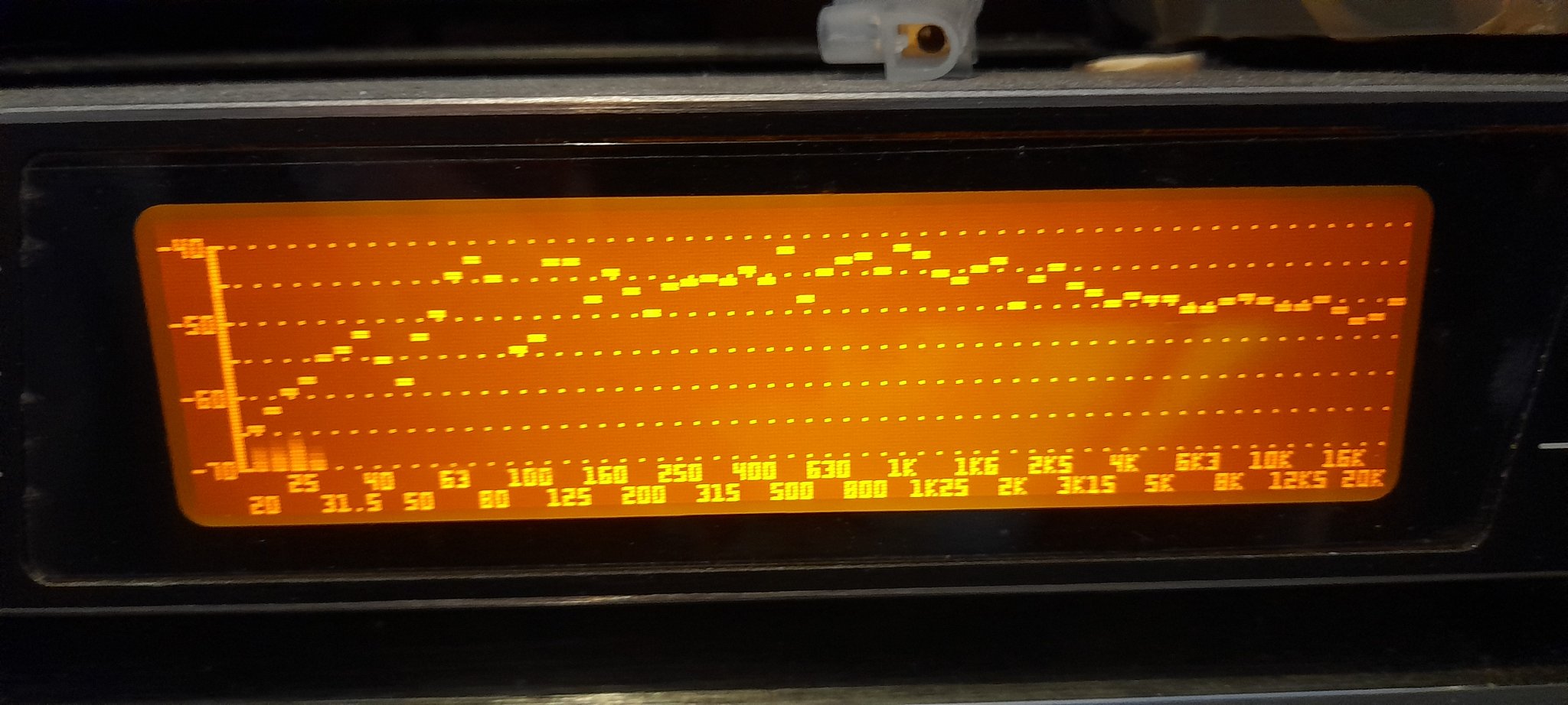

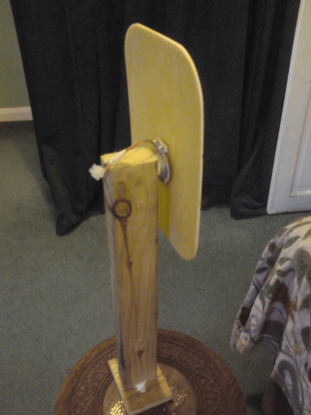

The pictures show some of my panels I'd tested.
The 5x2ftx1inch probably 70 grade? Response is shown in three pics at 1ft, and 10ft into the room,with and without the transmission line LF units.
As can be seen ,a pretty flat response can be achieved without eq.
Steve

So I brought some panels home this weekend to try out in place of my bookshelf speakers in the lounge. Safe to say it was a frustrating time as I couldn't get them to sound good. In my workshop they sounded great and I thought they had potential to replace what I have at home.
I spent a lot of time trying different positions distances from walls, heights and angles but always found they sounded too spacious without a good centre if that makes sense, they were in phase by the way. I had all but given up when I thought to try a blanket over the backs to limit the rear output and thankfully that was the answer. I was relieved to find a solution, now to make semi closed backs and stands for the panels.
The lounge is around 5 x 7m with carpet soft furnishings, curtains a sloping ceiling and large opening to kitchen one end, I thought it would be fine as it's pretty dead reverb wise. The workshop has an uneven fabric lined ceiling with fibreglass batts so much better absorbtion of the reflections I guess.
Anyway I thought this might help someone who has 'too much' space in the sound of the panels.
