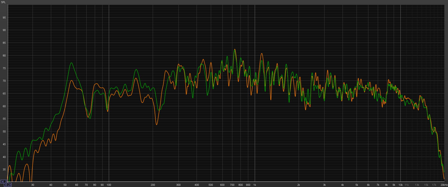

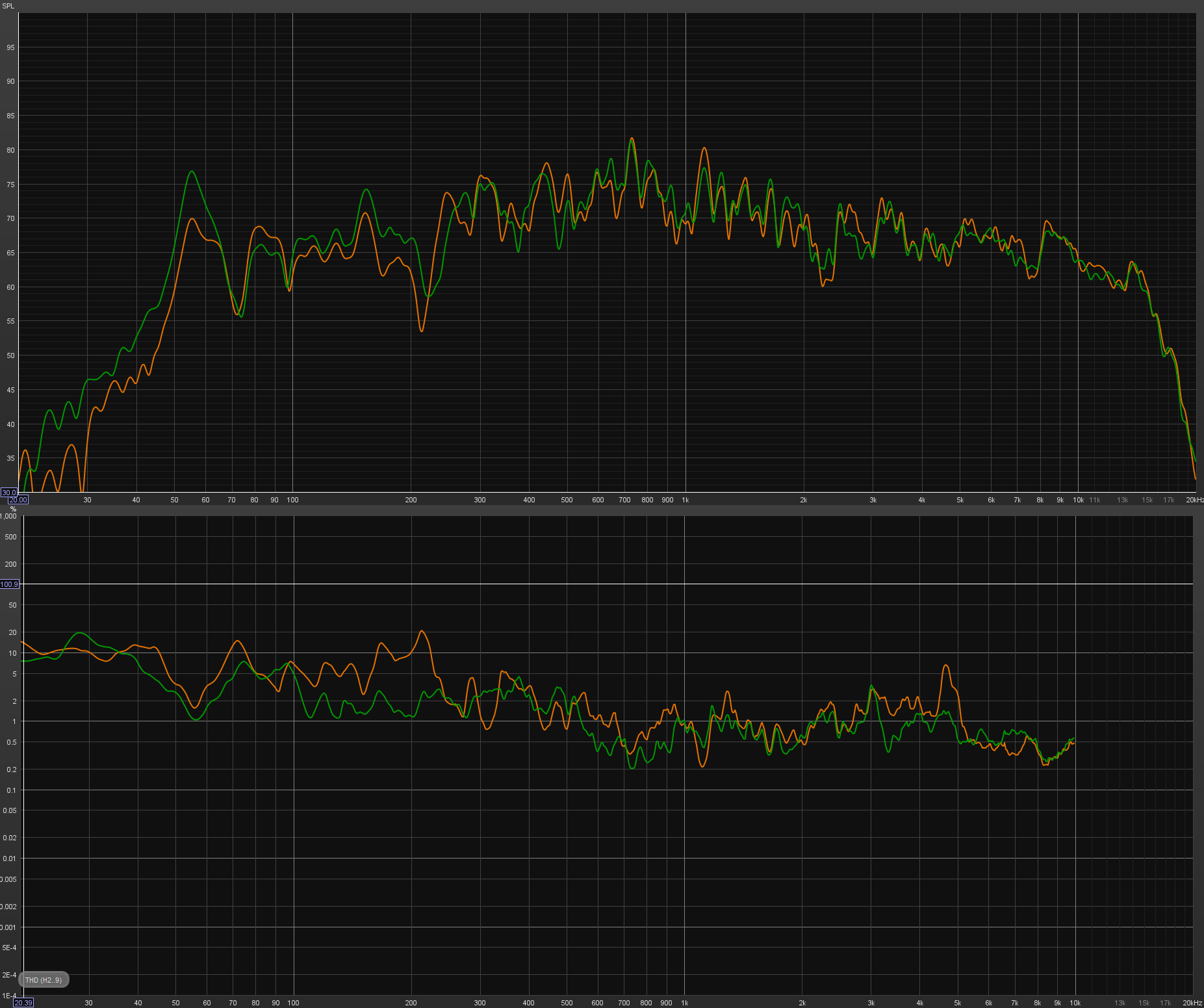

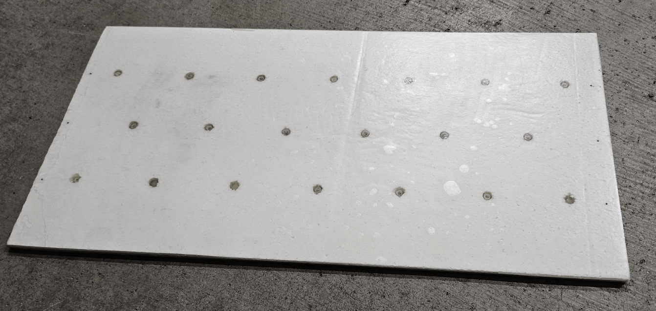

I had an opportunity to quickly do a loud test today with one of my panels and after just 1 minute of run time at ~95dB at 100hz my driver started smelling and feeling quite warm :unsure: I also had a lot of noise from my duct tape surround flapping...
Here are some photos of the panel.
I'm not sure what the 18khz peak is from, my measurements were pretty quick and sloppy as I was just curious on how they were working out with the new coating and the epoxy to attach rather than the superglue which was weakening the EPS. I was happy to see they improved in the low end after sanding as I had been disappointed in the 300Hz up previous measurement. Otherwise the mounting etc was unchanged.
I burnt out one of my 25fh exciters doing a high spl test recently too, I had turned down the bass on the amp but forgot there was no crossover to limit LF, short term around 100db at 1m, it ripped off the eps and the voice coil melted through too whoops.
Another mistake was when I didn't have any epoxy so tried to attach the exciter with JBweld, I hadn't considered that it had steel filings in it and when I tried it the next day some had been attracted to the magnet and into the voice coil gap.

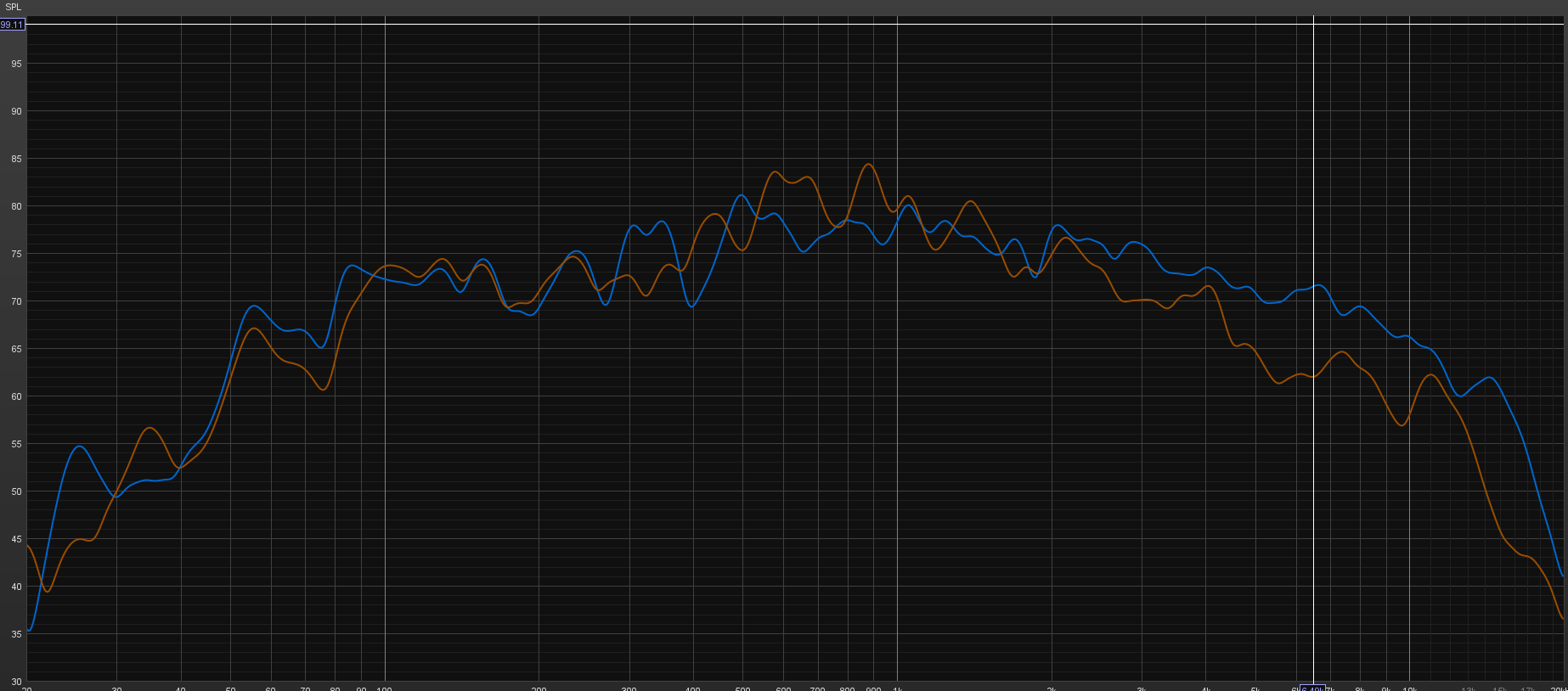

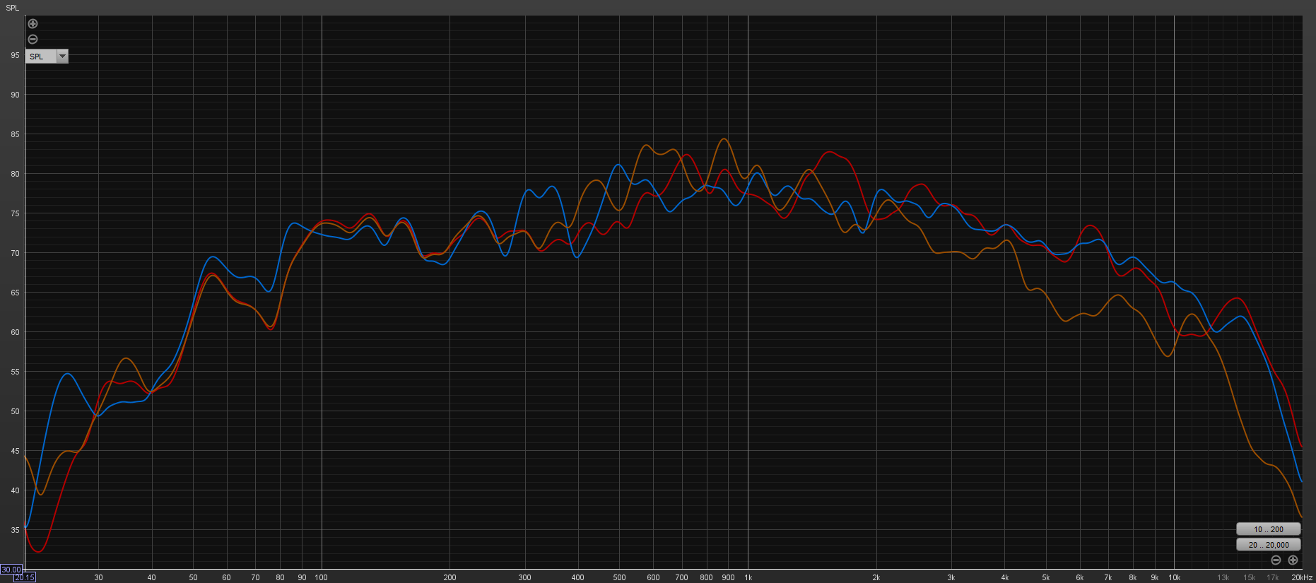

I just did an inside & outside test and the results are mostly as I expected except for a few new dips revealed in outside measurements. Idk how to explain the huge dip outside at 400hz. The reduction in the 1k-6k range is just 'meh', but that 400hz dip could be a problem? 2.5khz often shows up in tests I think it might be exciter related.
I setup in my living room for the test, then moved outside by picking up the whole heavy frame and hauling it out. I don't think any component was disturbed during the move. After seeing the 400hz dip I moved the whole setup back inside to retest and the 400hz dip was gone. Here's the results with red being inside and green being outside, mic at 6ft (2m) for both:
The inside test waterfall does not show any unusual stored energy around 400hz. I did repeat tests and moved mic a few inches and repeats of that, all show same results. I also measured outside at 3ft (1m) and it too shows the same dip (purple is 3ft, green is 6ft):
Note: I did not test multiple panels or mounting adjustments, I just used what I already had on which was a 10"x22"x0.5" XPS panel with thin epoxy on both sides and a full duct tape surround, and a solidly braced driver pressed into the panel enough to tension the duct tape a bit. Not played too loud because turning my AVR's volume from 60 up to 70 would cause a whole lot of noise from duct tape.
The only difference between inside and outside that I can think of was the mic stand. Inside it was around 20" off floor on the front edge of a couch cushion. Outside it was about 26" off the ground on a hollow plastic tee-ball stand. I should have tested different mic elevations outside and a sturdier stand but I didn't think of it at the time and I'm not hauling everything out again to try that :p The yard is about 35ftx45ft with 6ft tall wood panel fence on 3 sides and 2-story house on 4th side, panel was roughly in the middle of yard.

420Hz wavelength is 809mm (30"). Look for an 809mm reflection somewhere. It could be from the reflective path from the ground to the mic, or from the panel to the ground. How high was your panel above the ground?
It's possible that the reflection gets swamped by other reflections when you're measuring indoors.

The dip a 400Hz is strange. Have you had a look to the Impulse response to check if there is an unexpected reflection?
Christian
The bottom edge of the panel is about 18" off the ground, and the bottom of the baffle below it is about 12" off the ground. So the center of the panel is about 28" off the ground, and the exciter should be around 30" off the ground.
I guess it probably is a ground reflection, thanks for the hint. I don't think it could be anything else. I see the peak of that 420hz dip shifts down to 400hz when the mic moves closer which I think makes sense for ground reflections given the increasing ratio of bounce path length to direct path length.

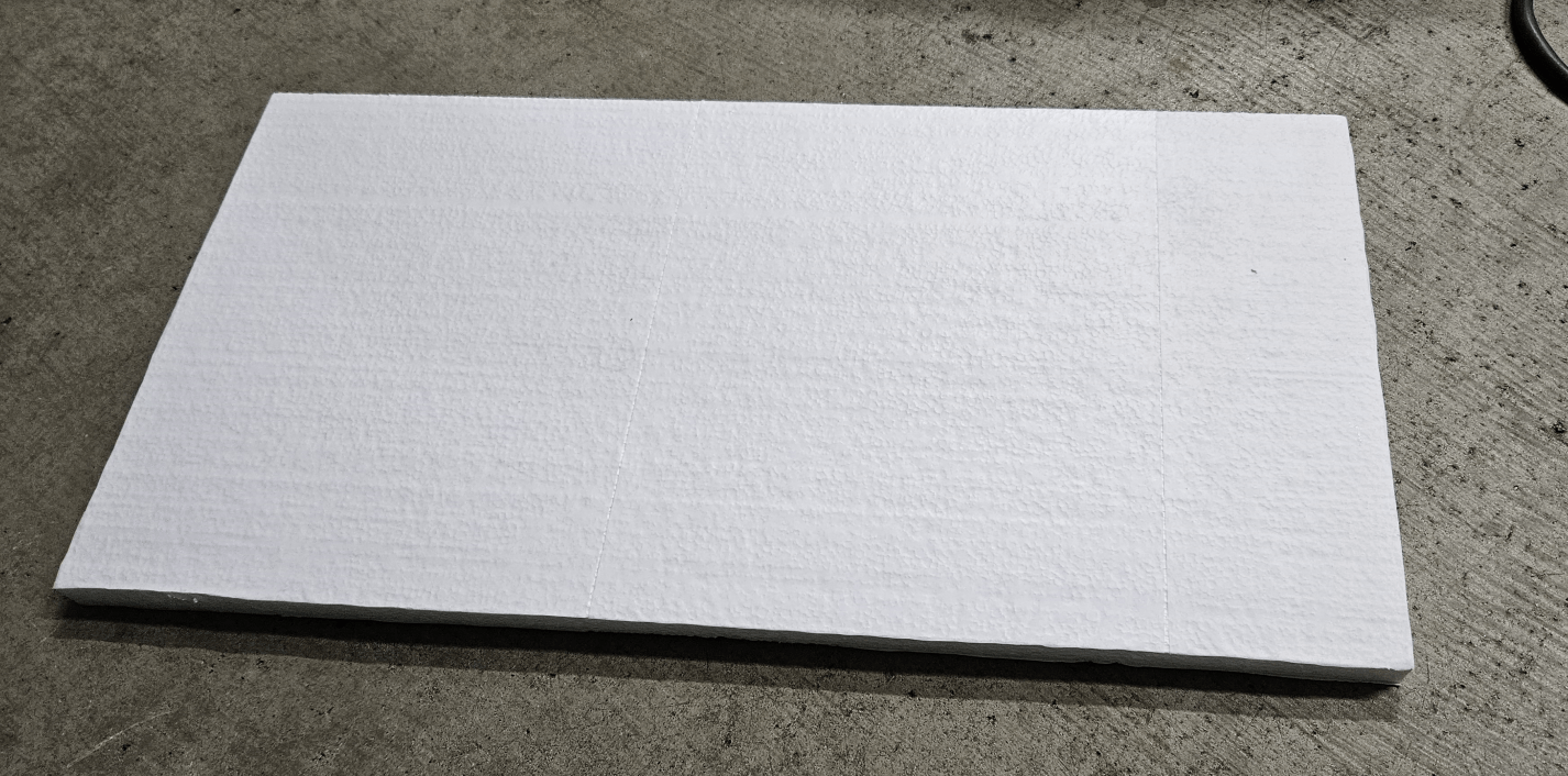

@homeswinghome - correct about dimensions. 29 kg/m3 XPS sanded with light epoxy coating. Weighs 110g iirc. Full duct tape surround covering the 1/2" gap to the 2"x6" wood frame with the 6" wide faces showing to the mic.
Reactions: 1 user
Understood. Your frame is wide compare to what we usually see here : +2x6" in addition to the membrane... It might help to the good bass extension. I think Eric has also large frame but in the other direction.
With such weight and density, the raw XPS panel is 50g (360g/m²) so one coating layer is 30g or 220g/m² which shows again an important part of the weight is in the coating. Your panel areal mass is 800g/m² which means a not too low efficiency.

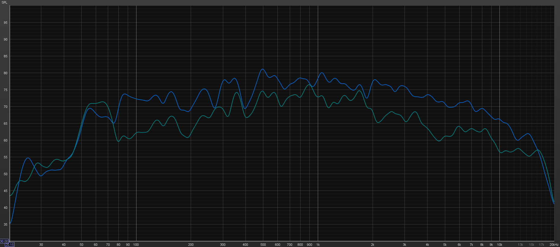

When I commented the measurements from Joskaz, I was surprised by the level of the 1st reflection :
I was even more surprised when I made just after some measurements.
Here is my panel with a polypropylene membrane in association with a tweeter (a FT17H, so a bit directive)
Almost no reflection... and now an EPS panel at exactly the same position with the same mic position
There is a stronger reflection...
Which in my opinion shows the DML throws some high frequency energy at a large angle... which is expected by the scientific papers about DML (important lobbying at high angle at the coincidence frequency)
After that, I updated my REW to last 5.31 version. From 5.30, REW offers more variant of wavelet spectrogram. So I come again to the idea to check the content of the response around 0s but now also at the time of the first reflection and it appears that just after 0s, there is a hole in the HF with a peak (rather flat) at the same frequency at the time of the reflection. Here is the example of my EPS panel.
To be verified if it is a plausible value...
Even if it is not the coincidence frequency, it is interesting to have a better look to the content of this reflection... I read somewhere that DML are not fully suitable (even if it work not so badly in my opinion) for an accurate stereo imaging because of this particular increase of the energy in HF at high angle.
