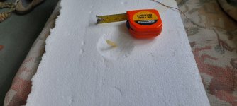

Hey Steve where do your 1cm thick light (1 lbs/cu ft) eps panels fall in this comparison? Size and low frequency extension? Thanks.
My smaller picture frame panels also goes down to 40hz

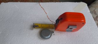

I am still intrigued with the x19-4 as it only weighs 30grams , and will suite very light eps, and also may be able to support itself for longer without sagging?
It also has a very good spec, if it is to believe?
Steve.

Those 19mm exciters have small magnets. I can't find the weight of a DAEX19CT to compare but the force factor of the XT19 is higher which is good for the efficiency. Even if better than the 19CT is about 40% less than a 25mm...I am still intrigued with the x19-4 as it only weighs 30grams , and will suite very light eps, and also may be able to support itself for longer without sagging?
By curiosity, I just run very quick simulations with PETTaLLS without any fine tuning to compare a DAEX19CT on a 30x50cm light EPS panel to a DAEX25VT on a 3mm plywood of the same dimensions. Both with exciters at 0.37/0.37, 1W, free magnet, free edges (FFFF). I did that to have an idea of the resulting efficiency (light panel with a low BL exciter, heavier panel with a higher BL)
The simulation shows the global efficiency are about the same.
The output I didn't expect is the roll off of the 19CT has a more important slope... what I can't explain. May be because of the higher stiffness or the lower magnet mass of the 19mm model
This reminds me I observed similar behavior while testing panels with a 13CT at home. I was expected with them a better HF extension than with a 25mm, which was true by rejecting higher in frequency the effect of the voice coil diameter but I was more surprised by the effect on the bass cut off.
Christian
