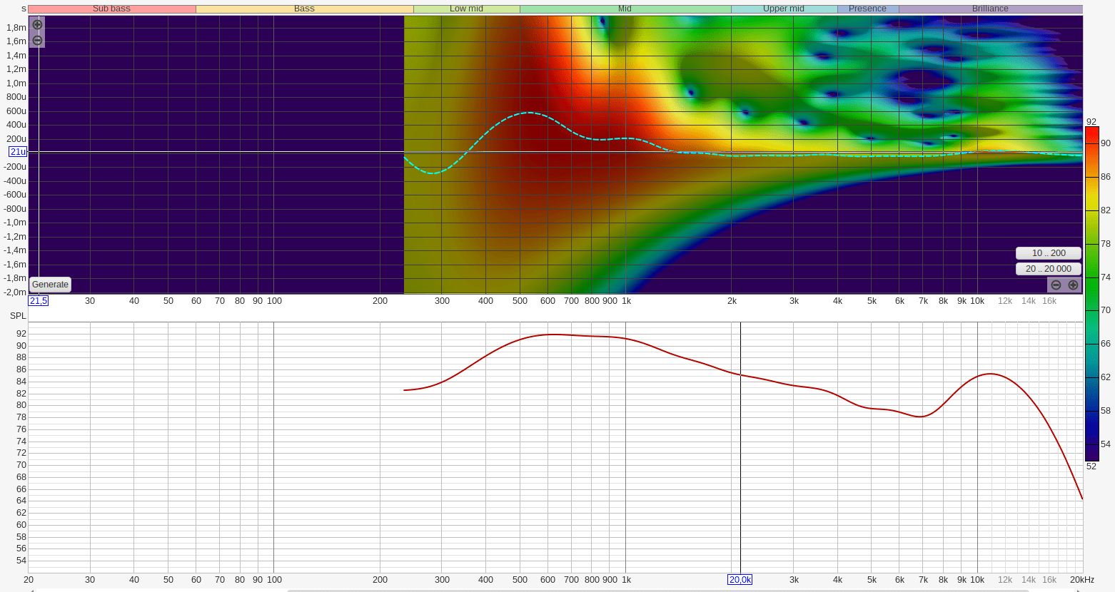

You can pick up ringing in the spectrogram on REW. It's rare to get resonance or ringing at such high frequencies.
I won't say the panel below is a good panel but for training and understanding the different phenomena it might be a good one... it is a 30x40cm sheet of 10mm EPS PVA coated only on the exciter side. The resonance of the central area is visible in the 10k area. I modified this area and changed this frequency. I can't recommend the solution I applied as at the end, I created a peak at 6kHz identified by REW as distorsion...
Due to its early roll off, this panel suffers also probably of a to light material or of a too low shear modulus.
It might be all of that is no more visible on stiffer and or heavier material.

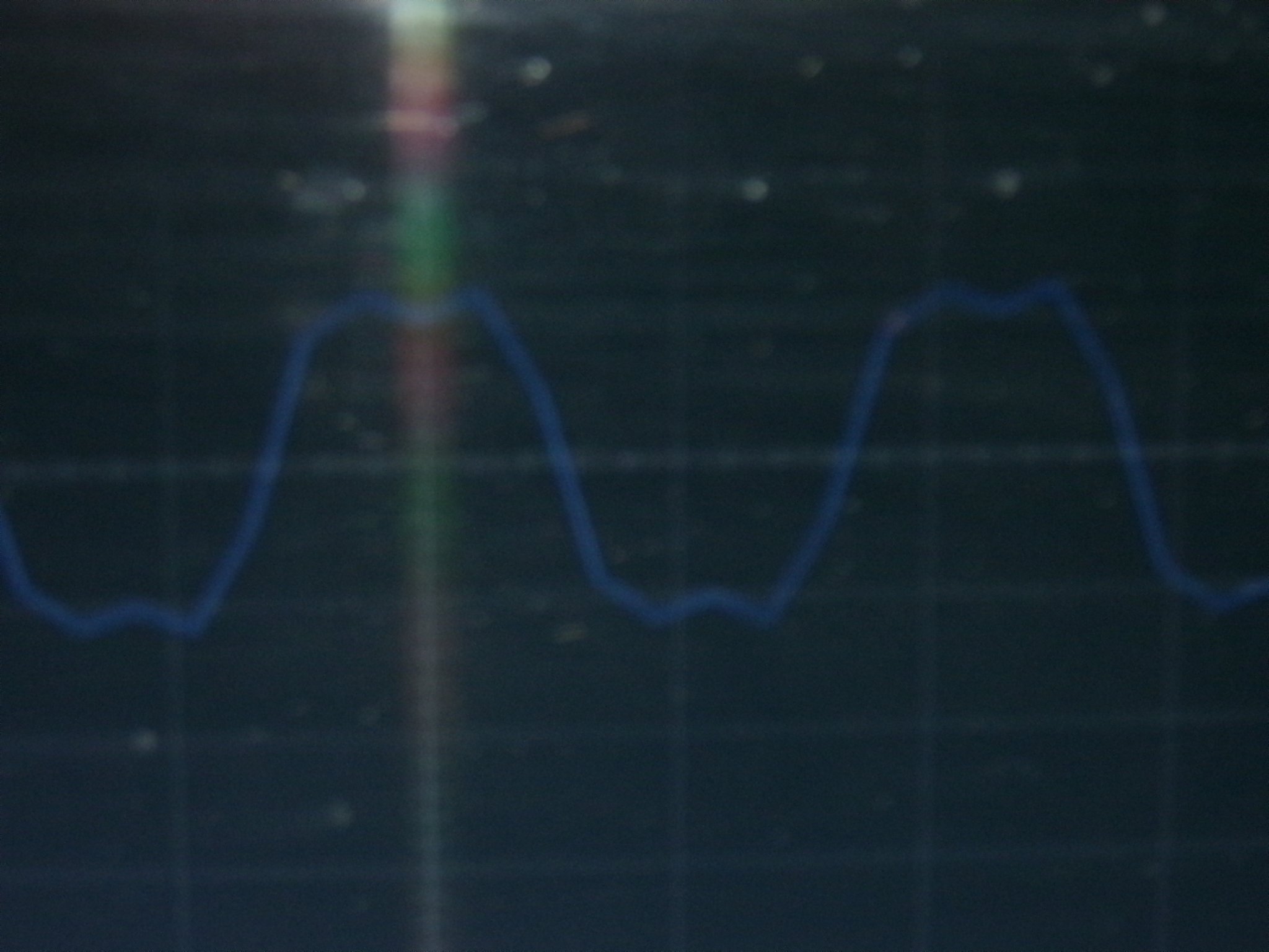

I was referring to 5Khz not 10, and the 5Khz square wave coming from a signal generator >
this being a test scenario to compare the HF performance of a DML compared to a high quality tweeter.

Please before you come with claims like "not true" take the time to verify. Anyone can quite easily verify what I stated for themselves, which makes it a bit silly to argue against it.
Again, where is your analysis showing the issue? And where can you see the issue in my response graphs?
This is not from my signal generator - test equipment.
This is a 5Khz square wave from my laptop line out > through my amp to speaker output >
