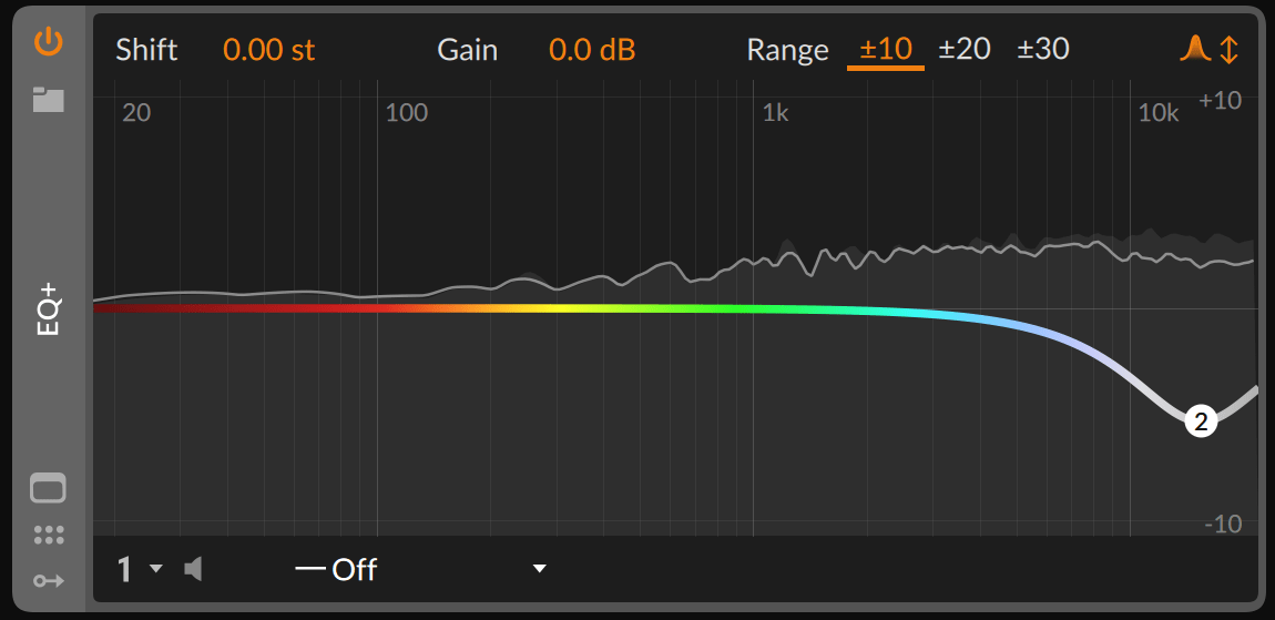

For example, here is stock EQ in Bitwig, with an EQ with default 1.0 Q applied at 15K:
As you can see 10-20k is just a very little part of the display, and the 1.0 Q cuts the whole top octave and more.
The reason both the display and Q factor is scaled like it is is that making fine adjustments above 10k is typically pointless. The space between 10 and 20k is not only less important because it is beyond what hearing is focused on and only contains high order overtones from instruments, but also one octave is one octave. So 100-200Hz is the same interval as 10-20kHz, and you have the same problems to fit several EQ's and need a very narrow Q if you want to affect part of the octave only.

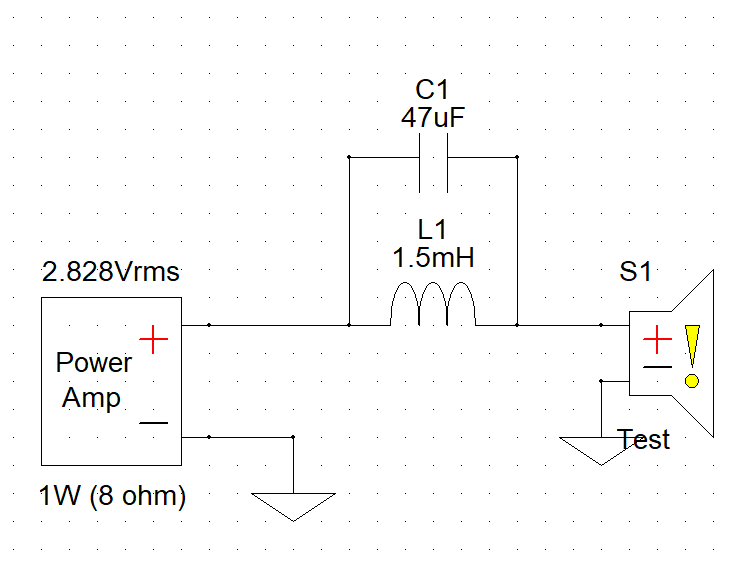

Hi there folks 🙂
I have been reflecting on my experience building my DML panels ( which now sound great ) and how
the initial sound was 'horrible & honky'. It required EQ to get them sounding good.
I also recall a post by another member - calling the sound "honky".
It occurred to me that if both I and another person experienced this same 'Honky' sound, then there would
surely be other people that have also found this shortcoming with their panels. That honky sound.
This got me thinking to present a very simple solution to solve/improve this problem for those experiencing it.
The solution/modification is a simple passive filter requiring only 2 components of standard value. (easy to get)
One coil/inductor and one capacitor.
( this modification will also improve upper region sound by removing a 'masking effect' )

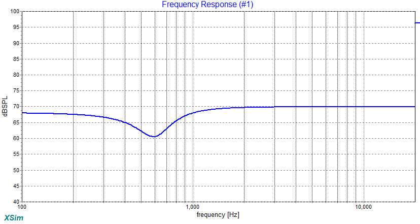

It's a simple series notch filter that places an impedance into the line at about 600hz. The frequency of the notch does not change with load impedance.
The inductor coil in this circuit has a DCR of 2 ohms. The lower the DCR, the deeper the notch and the better the lower frequency response.
Download Xsim. It's very simple. And it's free: https://libinst.com/Xsim/XSimSetup.exe (This link won't take you to a website. It will download the file directly into your default download folder. Look for it there.)

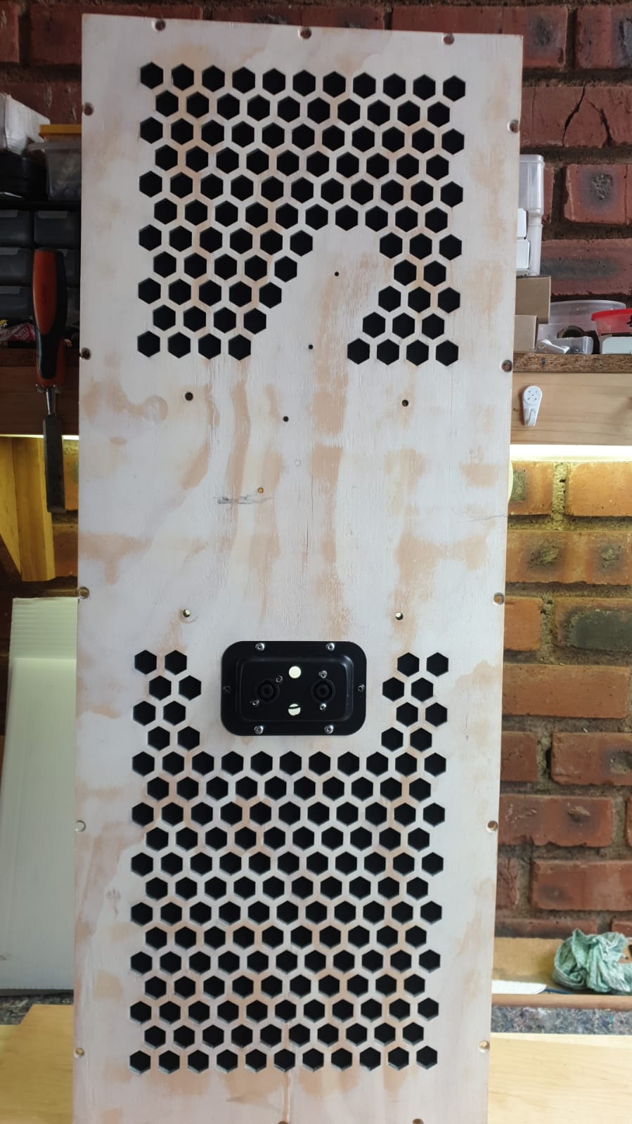

I do this with my PA panels, but only because I use a sub on stage, and I need a reduction of SPLs behind the speakers.I was relieved to find a solution, now to make semi closed backs...
I'm messing with various positions and shapes and holes on the rear absorber to reduce the amount of attenuation on the bass end. The panels bend in specific positions at specific frequencies, and the rear absorber can be used to flatten the response.
As it is, I use a wide bandwidth absorber (25mm honey-comb-shaped holes with the rear panel lined with carpet felt on the inside) and this does effect the bass end AND the over-all efficiency of the panel.

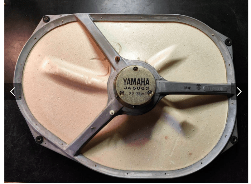

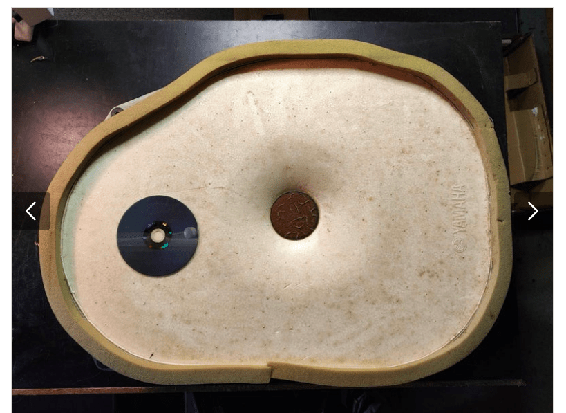

Has anyone heard one of the Yamaha Ja 5002 Ear shaped speakers before? Someone is selling one locally without the box and I'm a little tempted to see what it's like.
Carpet felt is great for this...I have used it a lot. I didn't mention it because it's quite hard to get in Aus now .. replaced by crappy faux rubber underlay which fails after a few years.
