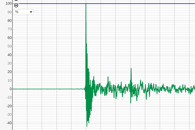

When I commented the measurements from Joskaz, I was surprised by the level of the 1st reflection :

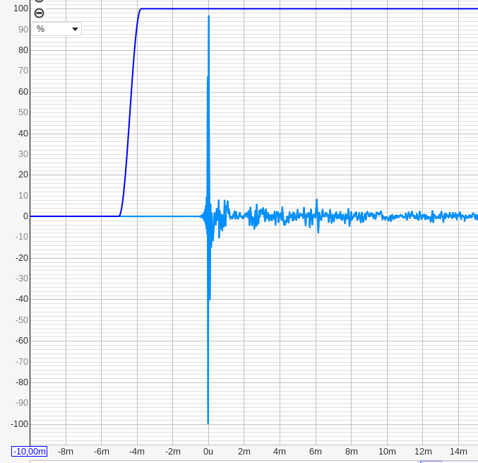

Here is my panel with a polypropylene membrane in association with a tweeter (a FT17H, so a bit directive)

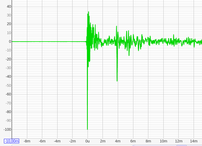

Almost no reflection... and now an EPS panel at exactly the same position with the same mic position
There is a stronger reflection...
Which in my opinion shows the DML throws some high frequency energy at a large angle... which is expected by the scientific papers about DML (important lobbying at high angle at the coincidence frequency)

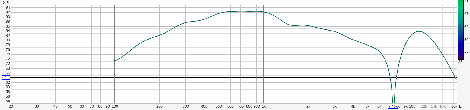

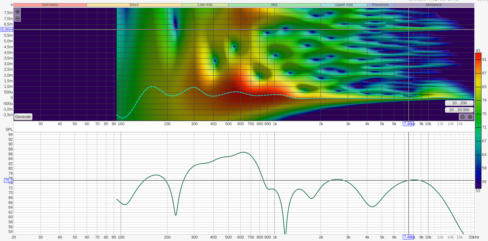

After that, I updated my REW to last 5.31 version. From 5.30, REW offers more variant of wavelet spectrogram. So I come again to the idea to check the content of the response around 0s but now also at the time of the first reflection and it appears that just after 0s, there is a hole in the HF with a peak (rather flat) at the same frequency at the time of the reflection. Here is the example of my EPS panel.
To be verified if it is a plausible value...
Even if it is not the coincidence frequency, it is interesting to have a better look to the content of this reflection... I read somewhere that DML are not fully suitable (even if it work not so badly in my opinion) for an accurate stereo imaging because of this particular increase of the energy in HF at high angle.
Christian
Hello Christian.
So , how long does it take for the reverberation to stop altogether (flat line).
Panels do have an internal sound, this is part of the panel self noise I go on about.
I showed how to change this sound and significantly remove it in my finger positions recording.
Steve.
