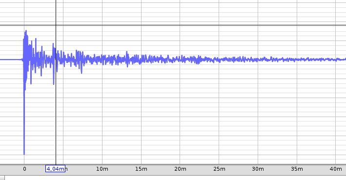

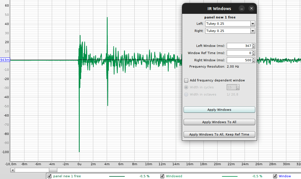

Basically REW records a sweep, extract from that the impulse response (response over the time of the loudspeaker AND of the room) and them makes a time to frequency transform and shows several results.
Among the views, it is interesting to keep an eye on the IR (impulse response).
On this one, we see the so call "long tail" IR of a DML (the low decay of the IR) and a strong reflection at 4ms which might come from the floor or the ceiling. Is the mic at 1m from the DML and DML and mic about 1m above the floor? Some absorbent on the floor might reduces it?
I also openend the IR windows by which the window which defines roughly the duration of the IR used in the time to frequency transformation. Here it is the values by default so the FR reflects what happens in the 500ms. That means the reflections are in the FR. The response you get is closed of the energy response or what you obtain sending a permanent pink noise in the loudspeaker and measuring with a RTA.
In the second record, the reflections seem different. Are they surface closer to this panel than the first one? It could also explain some differences in the FR

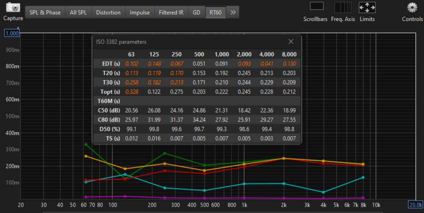

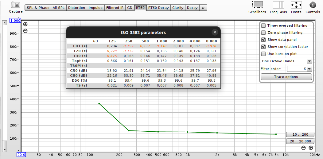

There are 2 (at least) interesting information in REW about the conditions of the measurements defined by the room.
You can go in the RT60 and clarity folders. All is summarized in the RT60 folder is you check the "show data panel" box in the controls
First information is the Topt which as far as I understand that the reverberation time. The time for the energy to decay in the room.
Second information is the clarity C50 which is the ratio of the energy in the first 50ms to what happens after.
In comparison, what I just got in my rooms is a reverberation time of about 0.5s and a C50 at 1m in mean value from 250 to 4000Hz of 12dB.

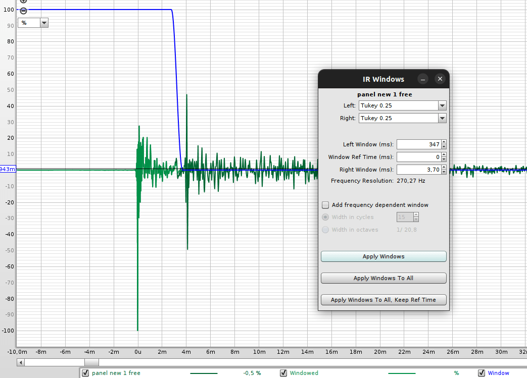

So maybe last (sorry to be long), there is the possibility to have an idea of what happens in the early ms so to get an idea of the "on axis response" by :
setting the window end before the 1st reflection (quasi anechoic response)
This view in my opinion is a bit confusing because it lets think the FR is fully detailed above about 250Hz which is my understanding not true. The property of the FFT is to get information for each n/T, T being the duration of the window. So if the window is 4ms, you have information each 250Hz. I hope not being wrong on that! No magic to get rid off the reflections.

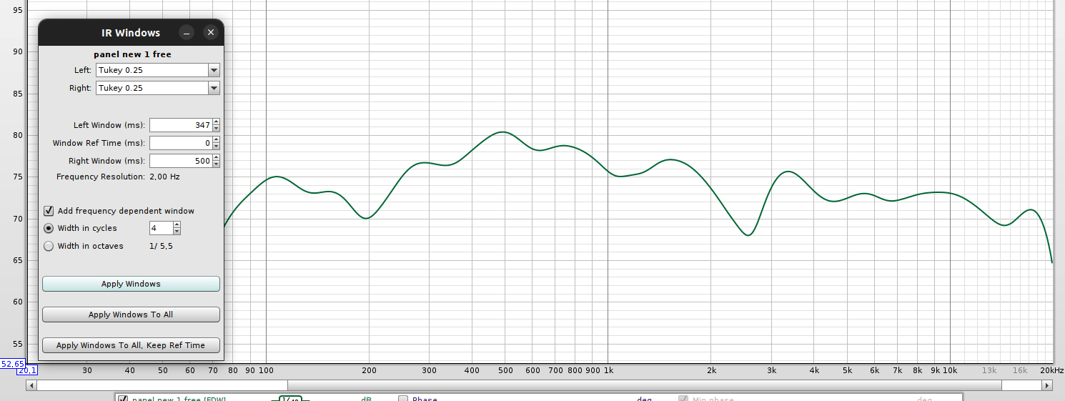

An other possibilities is to set a frequency dependent window (go in Tools/IR windows)
For those both, you can remove the 1/n oct smoothing as by nature, those operations smooth the FR. You see in the above box that window is set to 4 cycles (something I read recently used in an other forum which is closed of 1/6 of octave, the line below shows 1/5.5)

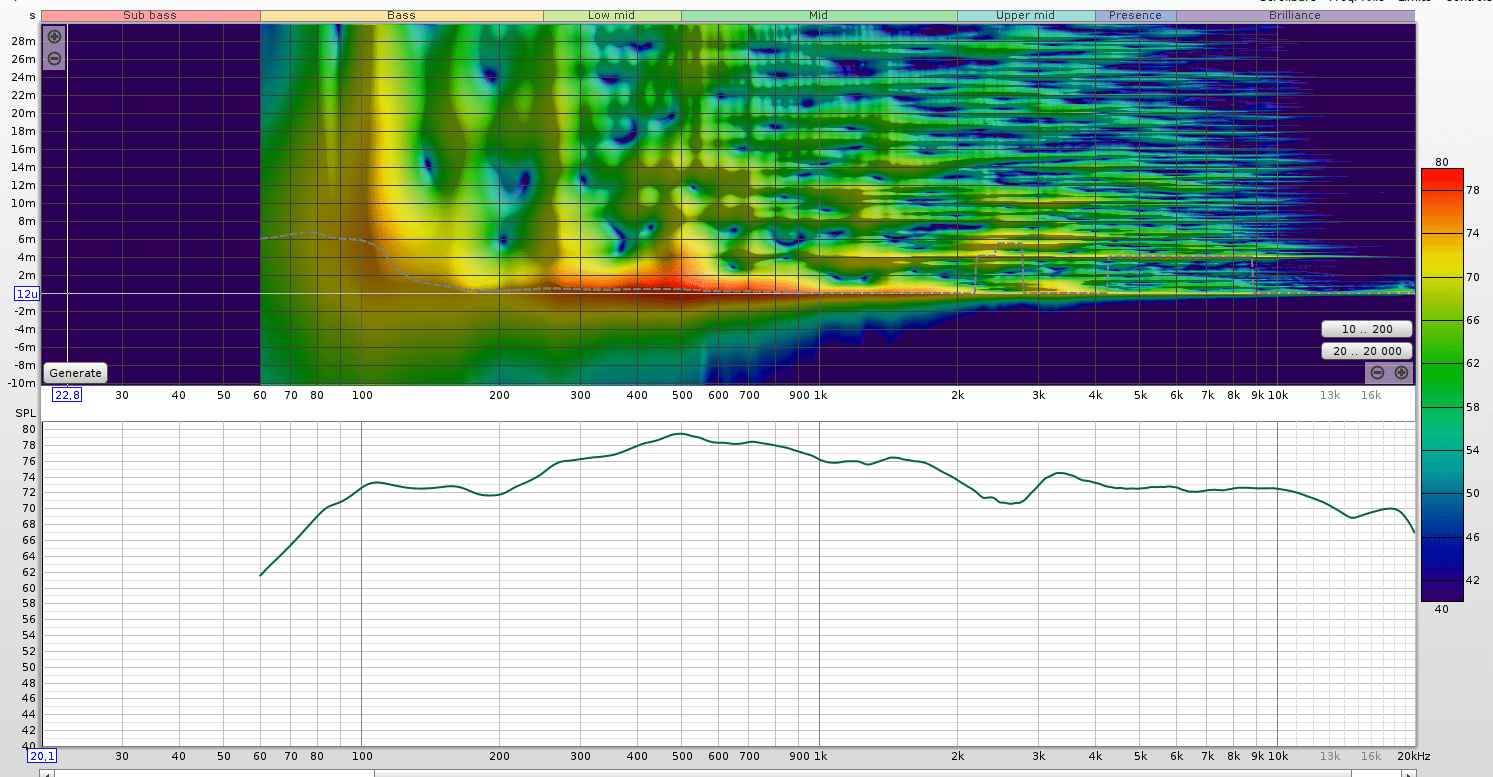

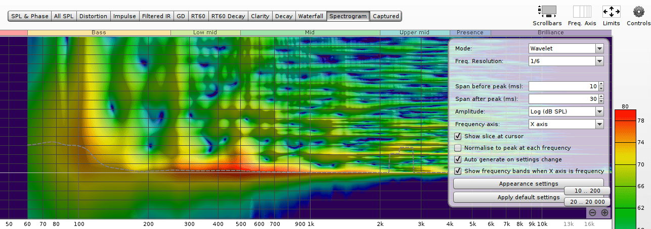

An other possibility, the one I prefer, is to make a wavelet spectrogram which gives the frequency and the time information
In the colorized graph, horizontal is the frequency, vertical the time. The color gives the level. Under is the a 2D slice at a given time, here 12µ (not possible to set at 0!)
I like this view because by its principle it is close of the filter bank which is in the ear (unfortunately not the brain treatment which is after). The vertical areas in the spectrogram show modes, either panel or room. The horizontal one, the reflections
The interesting property of the DML as a wide range loudspeaker, almost all the band is time aligned.

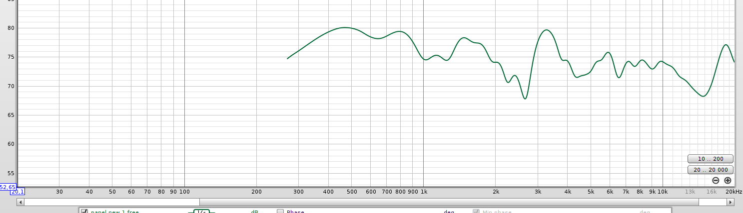

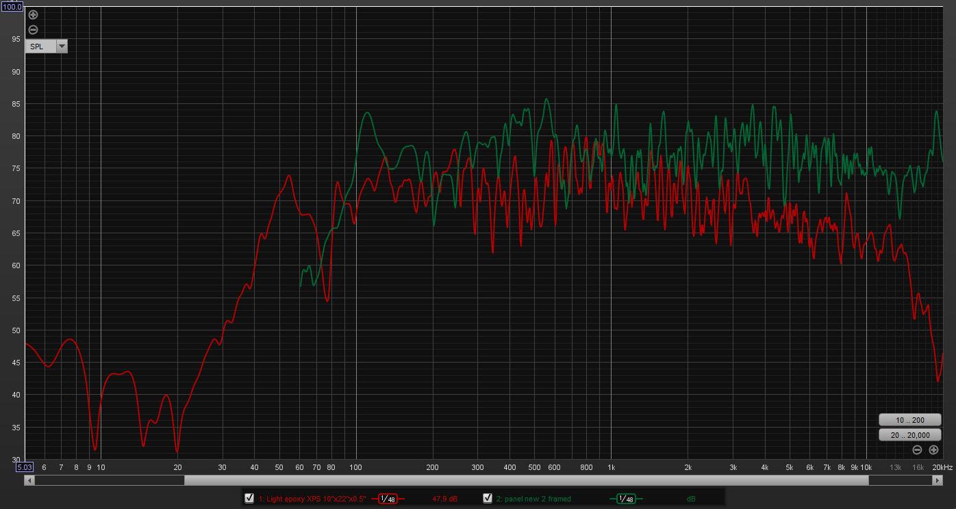

It's fun to slide the gating limiter on the Impulse tab to see how that unsmoothed FR graph changes with the slide. Ultimately you do need around 80ms to see what 100hz is really measuring, and the total smoothed FR with 80ms isn't usually too much different from the default 500ms, so I don't bother messing with it most of the time.
The room has a big impact on a lot of measurements and my room sucks. I'm taking the approach of having a baseline and comparing differences between tests from that baseline. I keep thinking about moving some tests outside but that's a lot of work and I can't do it for every test so I haven't tried yet. My neighborhood isn't that quiet either.

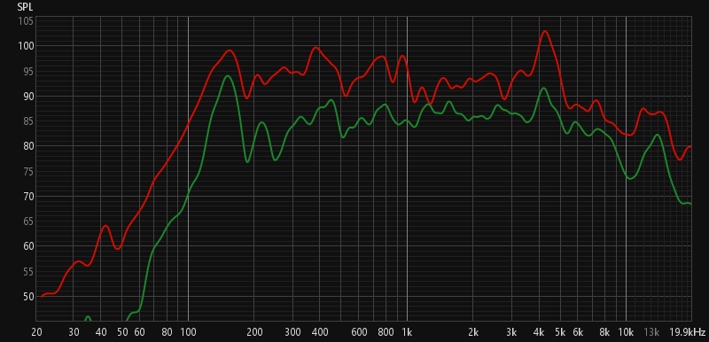

I wouldn't say that the FR I shared last is less 'smooth' than Joska's, but my FR slopes downwards more. Here's a different test I did recently in an overlay with Joska's, just because this one looks pretty decent and I have it handy:
This is 1/48 smoothing of both with Joska's in green and mine in red. My mic is ~7ft away from panel and the duct tape surround is awful. My driver also has some noise-generating problems and my room is completely untreated. My distortion readings are far higher, RT60 and Clarity also much worse. If I fix the room and panel surround and replace driver then those figures should be closer to Joska's, though his do look really good to me. Despite the current state of my setup we can still see a pretty good representation of FR. I still don't know what is causing that 75hz hole in my test though.
I don't usually do many off-axis tests because I run through so many iterations of testing that I don't have to time or bandwidth to take and analyze them all, but in the past I've seen that any off-axis problem I see with a DML will already be apparent on-axis as long as the mix is far enough away. If the mic is too close then when on-axis it is closer to the driver that measures more cleanly, but when off-axis the mic is closer to panel edges which are more dirty.
I am never going to listen to a DML 3ft (1m) from my head so I am much more interested in the 6 - 10 ft sound where the whole panel is heard more equally. Obviously I can't measure just the panel itself without the room interacting strongly at that distance so that's why I think "relative to baseline" and try to deduce the effects that changes to panels makes between tests using this data. There were a couple weeks where I did every measurements very close, like 3 inches from panels, and I got lots of great results but later when I moved far away I realized they weren't so great after all. Not because of the room, but because of the other parts of the panel that are not right around the driver where my mic was. Moving the mic to different near-field points on the panel and running tests can show wildly different results sometimes.

Here are my RT60 params for a plate I just built and is testing now:
Or the mdat if it is anything else you want to look at:
And for comparison here is the same plate but recorded at 1m (green) compared to recorded at 30 cm (red)
I suspect the dips around 200-250Hz for 1m measurement are room modes, but that the close measurement is a bit more jagged because it is picking up some modes more than others when miked so close.

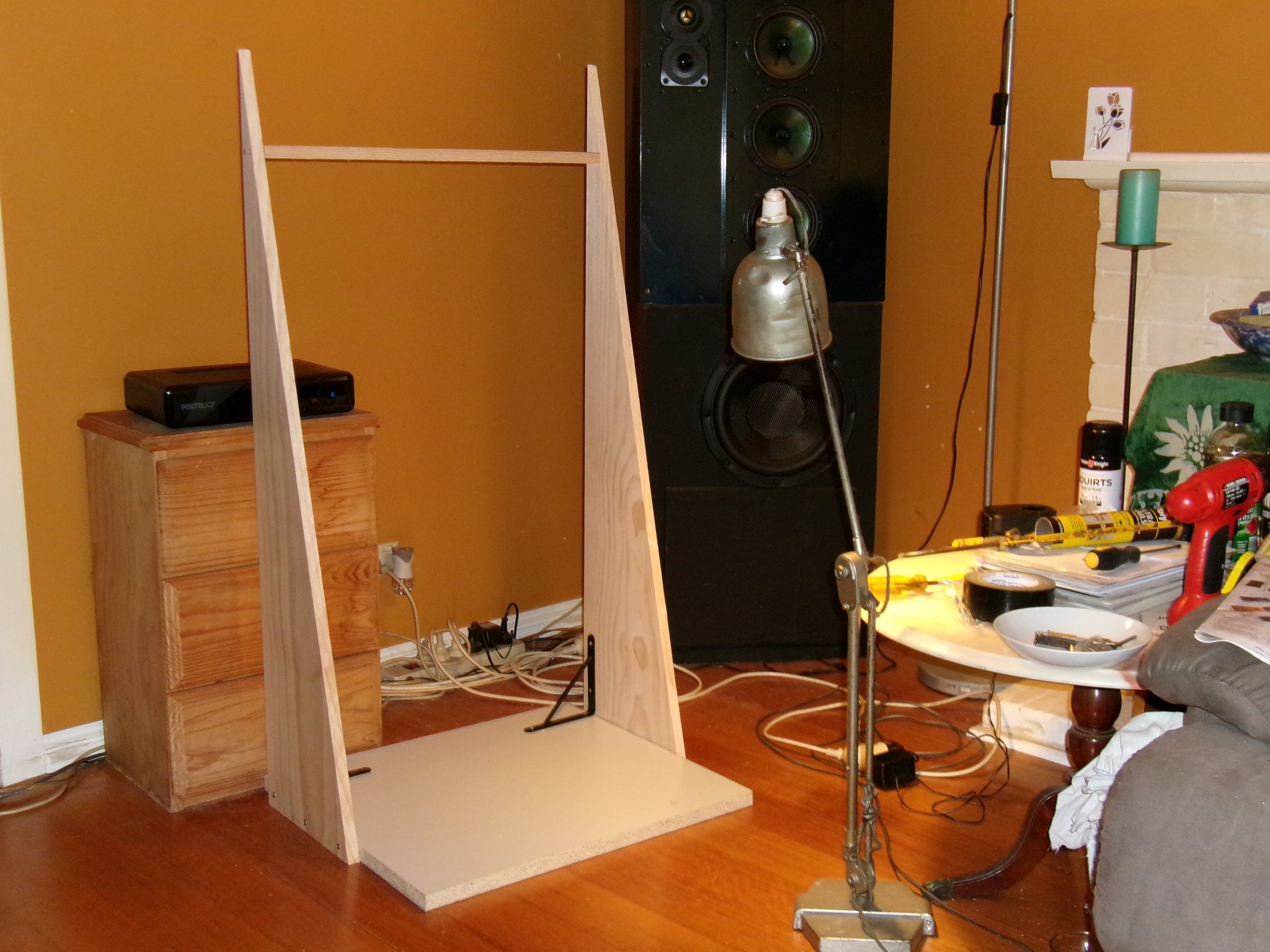

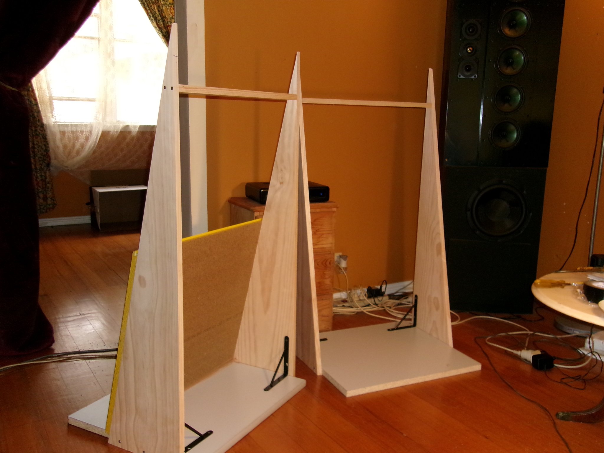

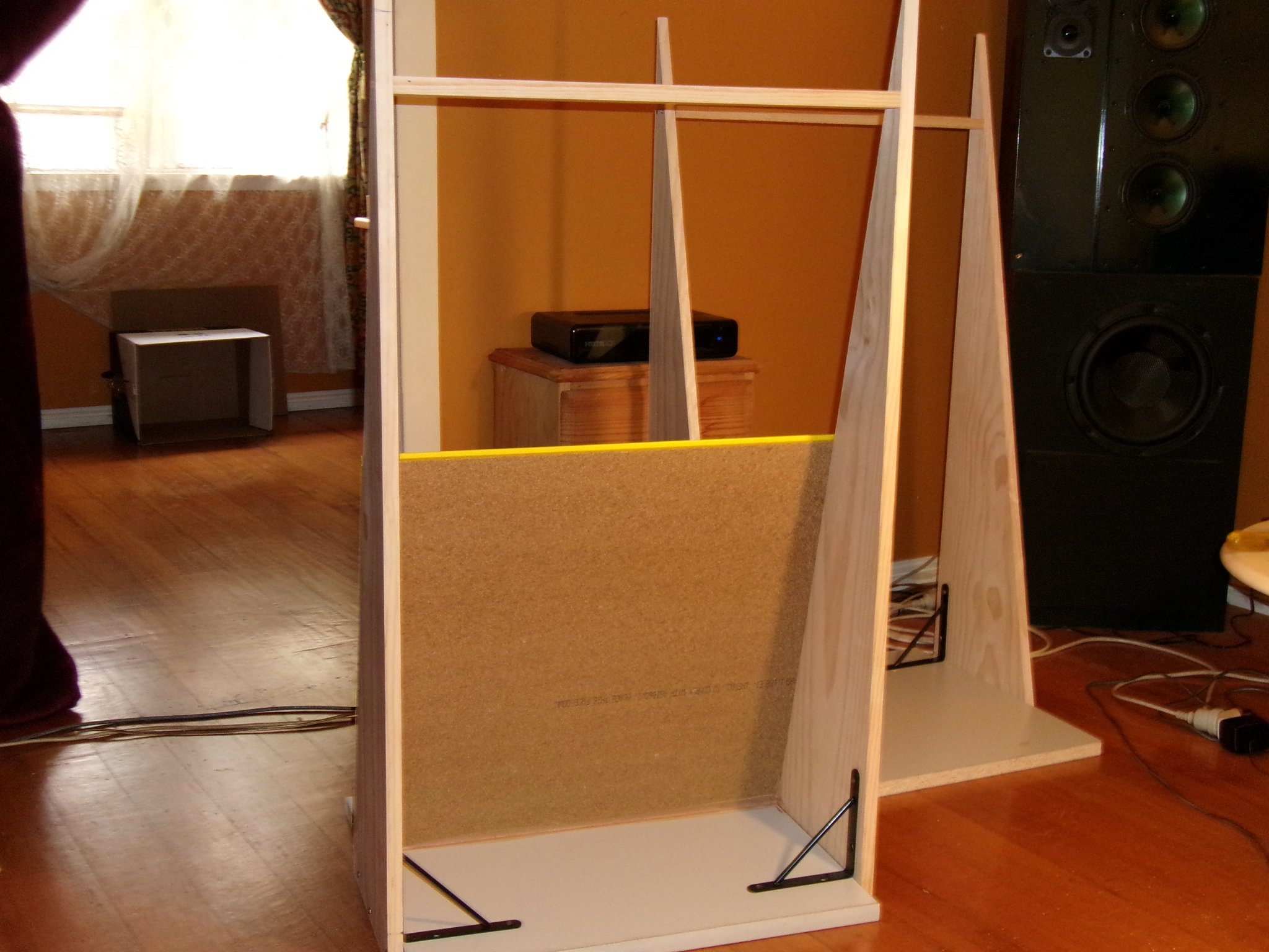

Hi there folks 🙂
I have finally finished my HYBRID DML speaker project > DML + open-baffle woofer + tweeter.
I will start with the wood-work. ( I had to build with no workshop and only hand-held tools )
The first challenge was to not only make a frame to hang the panels, but also provide a quite large baffle
for the woofer + a mounting position for the tweeter.
Using some imagination, I arrived at a rather unusual & unique design.
My starting point was to provide a strong & sturdy floor base-plate > 620mm x 540mm x 25mm = 5.5Kg.
( because these speakers go strongly down to 30Hz, I didn't want them 'dancing about' )
From this base I built upwards > apart from this base-plate and a 'hanging brace', there are only 3 pieces of wood.
Here are some pictures:
Reactions: JoskaNZ

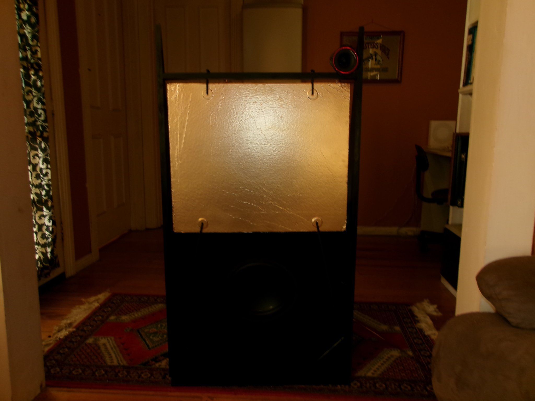

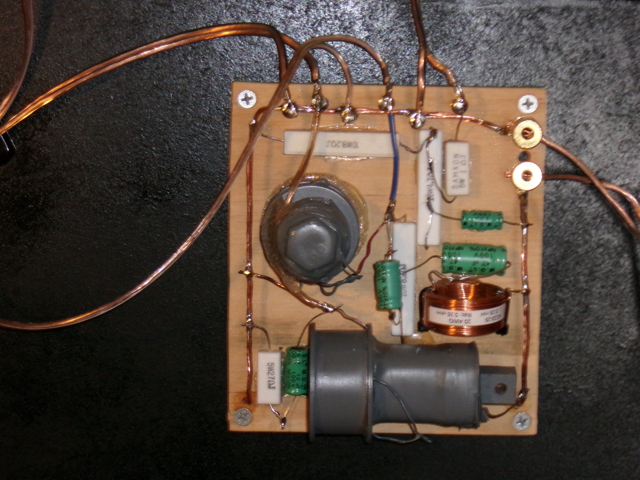

CONTINUATION ...
When I first made & hung the 600mm x 500mm DML panels and connected them directly to the amplifier >
I was dreadfully shocked by their horrible sound. They were 'honky & resonant' and tonally wrong.
I thought - boy have I got a challenge on my hands to make these sound good.
The first stage to improve sound and incorporate the woofer and tweeter was to design 'passive EQ' into
the crossover network. This improved sound by 50%.
Reactions: decramer
CONTIUATION ...
The actual sound of the speakers is better than the 'frequency response plot' would indicate.
The front & back radiation creates a multitude of reflections that show up a 'combe filtering'.
I also have some reservations regarding my measurement microphone - it had a drop to a hard-wood floor.
I should state that these speakers are not efficient and need a good 100W per ch. amp for full dynamics.
There is one great thing about these speakers > you don't need to buy or build sub-woofers,
the bass response is really quite stunning 🙂
Attached mdat for 1m measurement.

Just to come on the "methodology" aspect which was mainly the topic in my previous post, The distortion folder of your measurements shows a good noise floor and a peak of distortion at 4,2k which matches with a peak in the FR. Something happens here...
Most of the time, I don't have this look to the distortion for my own measurements!
So I just opened files of a panel I am playing with at the moment to see the distortion curves are awful compare to yours...
In a first one, when the panel was tape suspended, it was clearly audible. With a string suspension, it was improved. I had a doubt if it was fully fixed... I see it is probably not!
Lesson of that. REW is an excellent too. Go to the different views to collect all the information. If something looks weird, it is weird.
