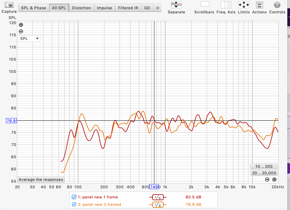

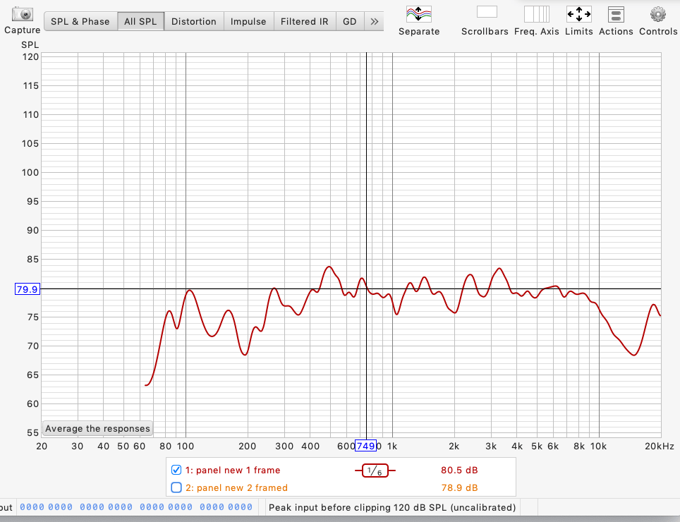

if I had to choose I would pick the ply as the proplex has a somewhat subdued character though the spectral balance is indeed close.i just made 2 new recordings of the ply panel with dome on the left and the proplex with cling film on the right.
the panels are 2ft apart facing each other full range without subs , with me holding the phone between them.
this makes recording easier as i do not have to get the mixing right.
they are at the same volum level so similar efficiency , but i think the ply is brighter sounding ?
it is still too cold to do serious listening at the moment so will reserve my thoughts till i can have a proper listen.
but this will do for now , i think.

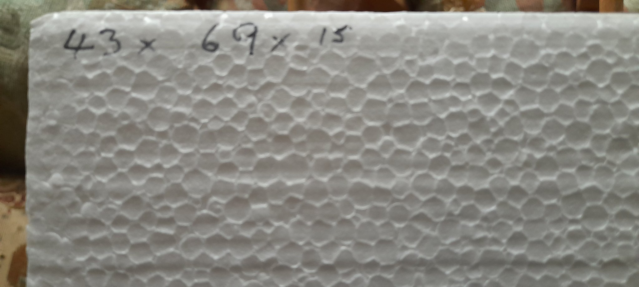

I might splash some on an eps chill box panel I am testing at the moment.
Not sure about the colour though 🤔
I will use the 50x50 mix to keep the weight down ,and see how it goes.

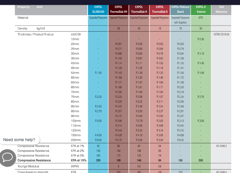

The crate ply is a very flexible panel , in one direction only.
Although the rigidly in the other direction is not very rigid.
I presume this material is similar , maybe, to flexible ply ?
As I have said before, I like flexible light panels.
The sound of this panel is similar to my eps panels, but is still a little too heavy for that ultimate sound that I like.

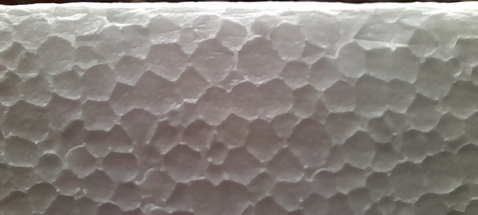

Steve: I look forward to the results of our experiments. I had another thought about your comments on thicker EPS panels getting in the way of the high frequency energy emanating from the exciter. This may or may not be original but that's ok. Here are a couple of ways to make sure that the exciter energy is transferred evenly from the rear of a thick panel to the front. First one id to mark accurately on the back side of the panel exactly where the exciter mount is going to be, once done you would mark out lets say eight evenly spaced points on that circle where the VC former will sit, At these point you would insert penny nails (the kind with a flat head). To do this you would drill a hole the next size larger than the nail, then yu would insert some epoxy into the hole and then fit the nails into the hole. The nails should be long enough to reach as far as the front of the panel. This will provide a direct transmission line for the high frequency to penetrate the foam panel and should result in more high frequency being emitted on the front side of the panel, you might not require a tweeter hard to say.
The second way to do this is to use a hole saw which is the same diametre as the exciter VC. Once again the centre of the desired location needs to be marked on the back side of the panel. Once marked use the hole saw to drill out a plug from the panel. Carefully remove the plug from the hole saw and then with epoxy re -install the plug back into the panel. The saw has a kerf so the plug will be smaller than the hole by the thickness of the saw itself, this gap between the plug and the panel will be filled with epoxy which will turn into a hard cylinder which will serve the same purpose as the nails in the above suggestion.
This would be a good place to consider using add mixtures to your epoxy to harden it such as graphite powder or diatomaceous earth. Hope this is of interest.

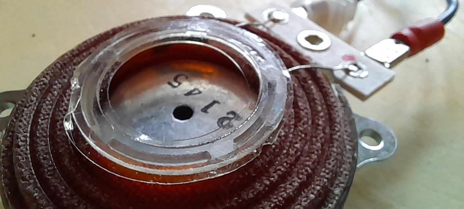

using the same brace material but placing it horizontally rather than vertically (ie shorten the brace) will result is a stiffer brace with a resonant point much high up in frequency.In slow motion you can see that the whole frame moves, attention has to be made to make it rock solid and damped at the same time.
I am just guessing but I think that you could control the level of a whizzer via the degree of coupling it has to the panel. A hard coupling ought to translate into a higher energy transfer while decoupling the whizzer cone by using a softer coupling should decrease the energy transfer from the panel resulting in a more subdued level from the Whizzer. Does that seem reasonable?Jaxboy.

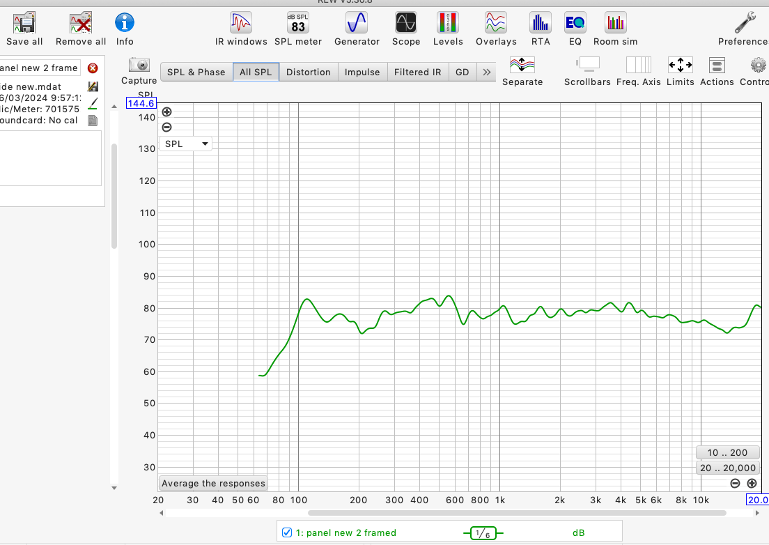

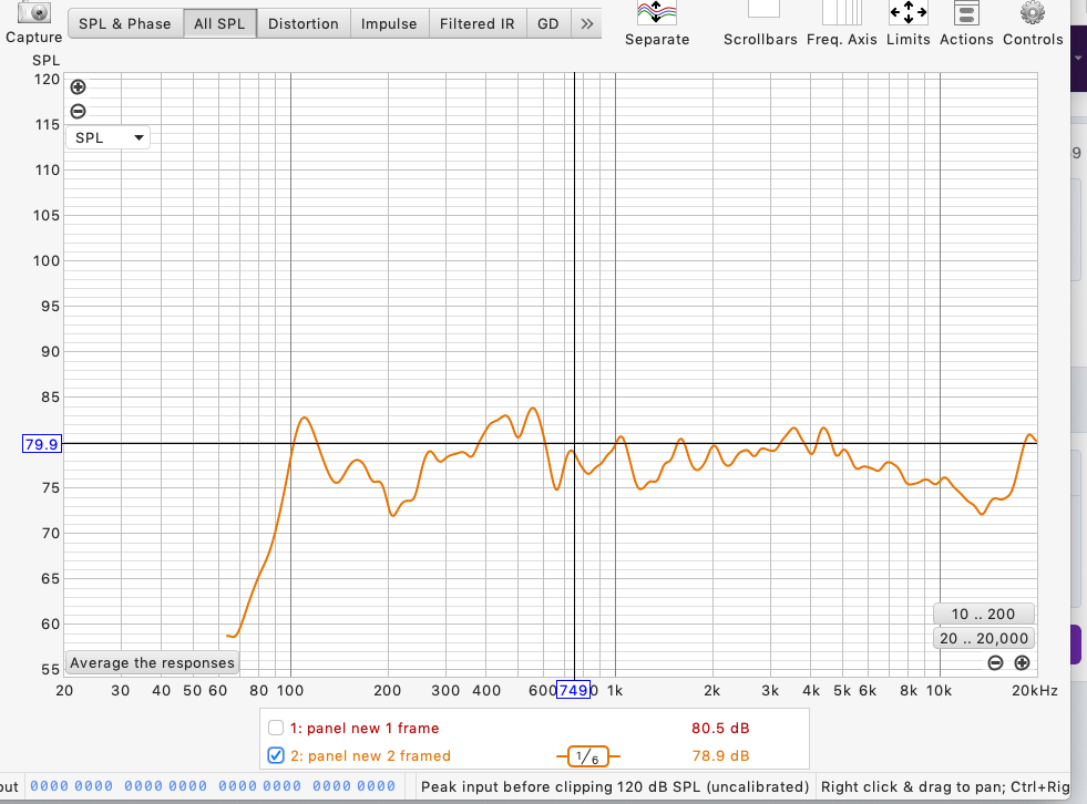

Just remembered I took some frequency plots just showing the whizzer increase in the 2k to 10k area.
It sounds much better than it looks, honest😀
And if you have hearing problems this could be a plus benefit.

wow Steve that sounded excellent. So can you tell me what the spacing is between the film and the canvas and how you space the film (is it air tight))? How do you keep the film from rattling? kling film is a very generic description but generally they are a stretch type soft film have you tried any different films? I know from experience that stretch and shrink films are not reliable so far as long term stability go but for the moment that is not a concern.toddincabo.
i am waiting to hear the results of my 10watt exciters before deciding how many fhe25-4 i need.
in the meantime i did a recording of my canvas panels with cling film on the front surface.
they have plenty of detail and sound very nice.
the exciters are not braced at the back yet, so hopefully i will be able to turn them up a bit more, but i think they are good enough to let my friend have a listen to them and see what he thinks.
if he likes them i can build him something more to his needs, he has not a clue what to expect as yet.
steve.
