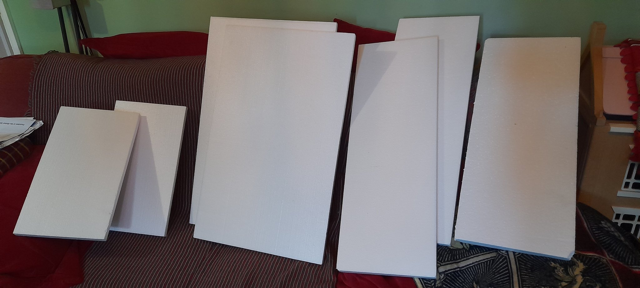

While I was staying with friends, their neighbours threw away some eps packing.
Another freebie test panel for me 🤗
Steve.

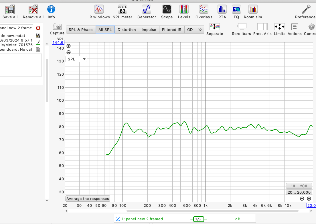

Thanks for the coating tips Leob, I made a couple of panels in a similar style to yours with the front and back of the panel supported in 6 places with closed cell foam. I uses Hide glue and Shellec as suggested and wow they are the best I've made/heard. Only one exciter each at present but the frequency response is so much smoother and highs much better than my previous PVA coating. I am using a HD EPS 500/320mm in size. The Exciter is a dayton 25fhe at the 3/5 2/5 location.
At first I measured and there was a steep drop off from 300HZ down but lots of highs. I gave them a sand front and back and now measure nicely down to 100HZ ish before they drop off. I must have coated with too much Shellac and they were too stiff.
This is in room away from walls and floor no EQ and 1/6 smoothing. Pretty happy with the results and sound.
Hello Joska,
Nice FR!
Could you tell us a bit more about your panels (sorry if it is in posts before, for now I check time to time this thread...)?
  • do you know more precisely the EPS density?
  • from which thickness do you start (300Hz version) and what is the final one (100Hz version) ?
  • you mention a suspension in 6 points. Could you remind their locations? This might be in Loeb's posts but you know how it is easy to go back to information in this thread.
  • how the exciter is glued to the panel (original 3M, PVA, epoxy, other...)?
Thank you
Christian
