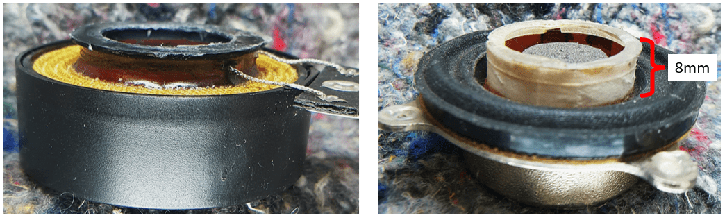

Here's a close-up of the XT32-4 on the left, with the ubiquitous DAEX30HESF-4 for comparison:
@Leob I'm wondering if our distortion problems on the 30HESF are not caused by the coil former collapsing... if you zoom in a bit then it looks like that former might be a bit tired?
Thanks @moray james for resurrecting some of the old posts.

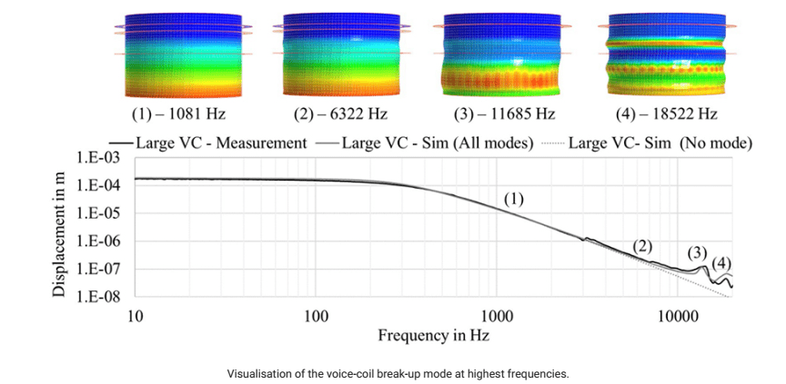

"That Paper," by Ben Zenker et al, mentions voice coil break-up as being one of the causes of poor upper frequency response.
The VC buckles under the mechanical stress of driving the (panel-plus-air) load at higher frequencies.
If we look at the Xcite drivers more closely, it's good to see that Ben has applied exactly this paper's solution to the XT32 drivers. The solution being the reinforcement of the VC, and which explains why they get a much better HF response especially when loaded with a higher density, heavier panel.
The XT32-4 not only has the VC bonded to the spider a lot higher up and closer to the load face, but also has a nice, thick layer of epoxy all around, supporting it even further.

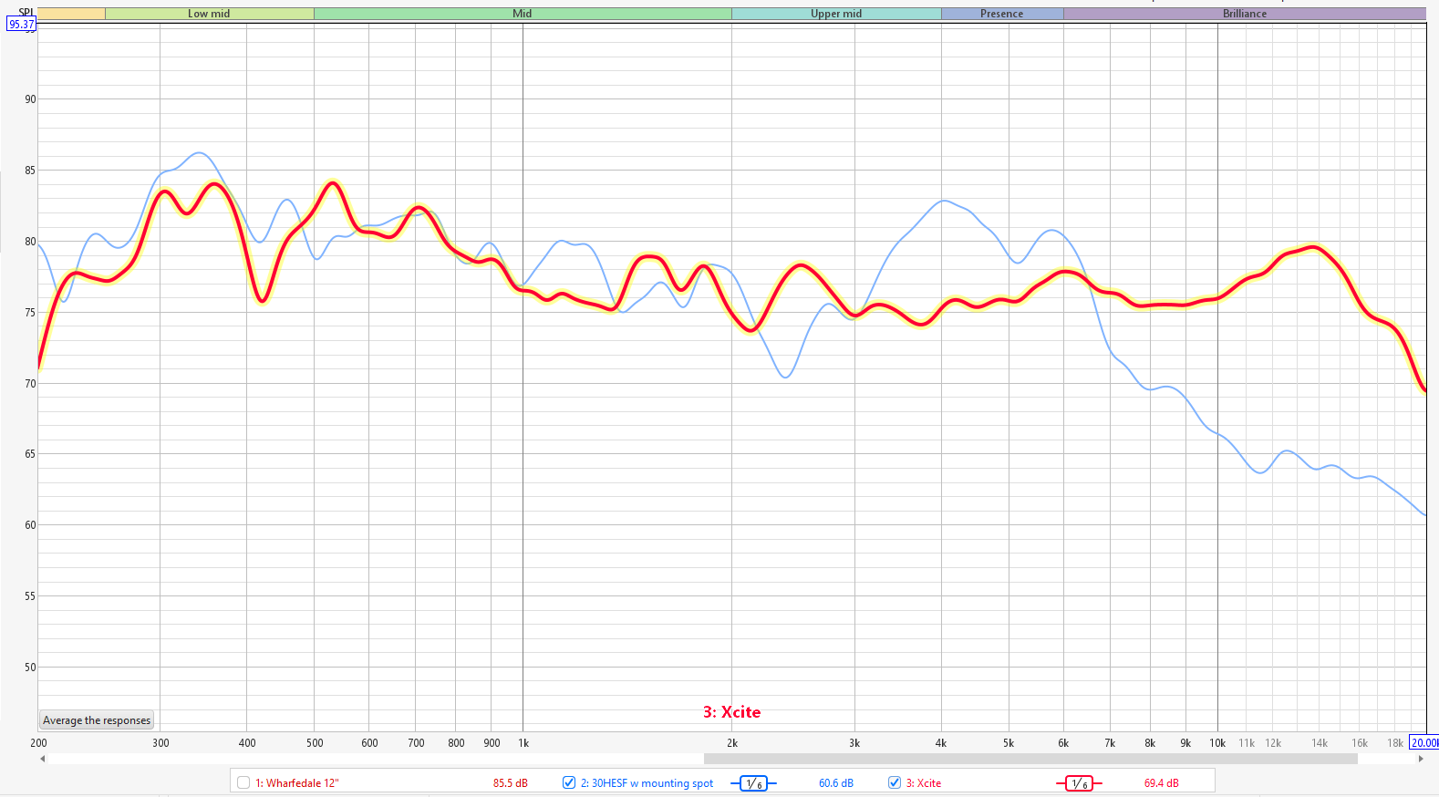

And the proof of the pudding...
Highlighted red is the XT32-4, the DAEX30HESF is the light blue curve. The drivers were mounted at the standard 2-5ths/3-5ths positions.

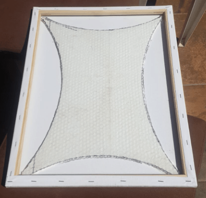

The panel is a 40 x 50cm canvas frame, with a resin-hardened Nidaplast insert which is shaped to minimise corners flapping around too much. Like this:
Because of the weight of the very stiff Nidaplast/resin combination, which is quite heavy, bonded to the stretched canvas surface, I get a VERY nice bass response! But it's a bit ragged down there and I might be tempted to either change to a taller aspect ratio, or pay some attention to the steepness of those arched cut-outs.

The corners of the canvas are limited in movement by the wooden frame itself. The shaped Nidaplast's 'fingers' extend into those corners, and are glued down quite solidly. Therefore, the tips of those fingers are fixed points that don't move at all. The gradually-increasing width of those fingers means that the panel is progressively damped closer to the tips. If the panel was not mounted to the canvas, and was not mounted by its corners, then the corners would have to be rounded off to control the undamped vibration.

The Nidaplast fingers are stuck into the corners horizontally between the wood and the canvas, and then glued solid. The tips of those fingers can be sharp or truncated or scalloped, it doesn't matter what the shape is because they're fixed points encased in glue.

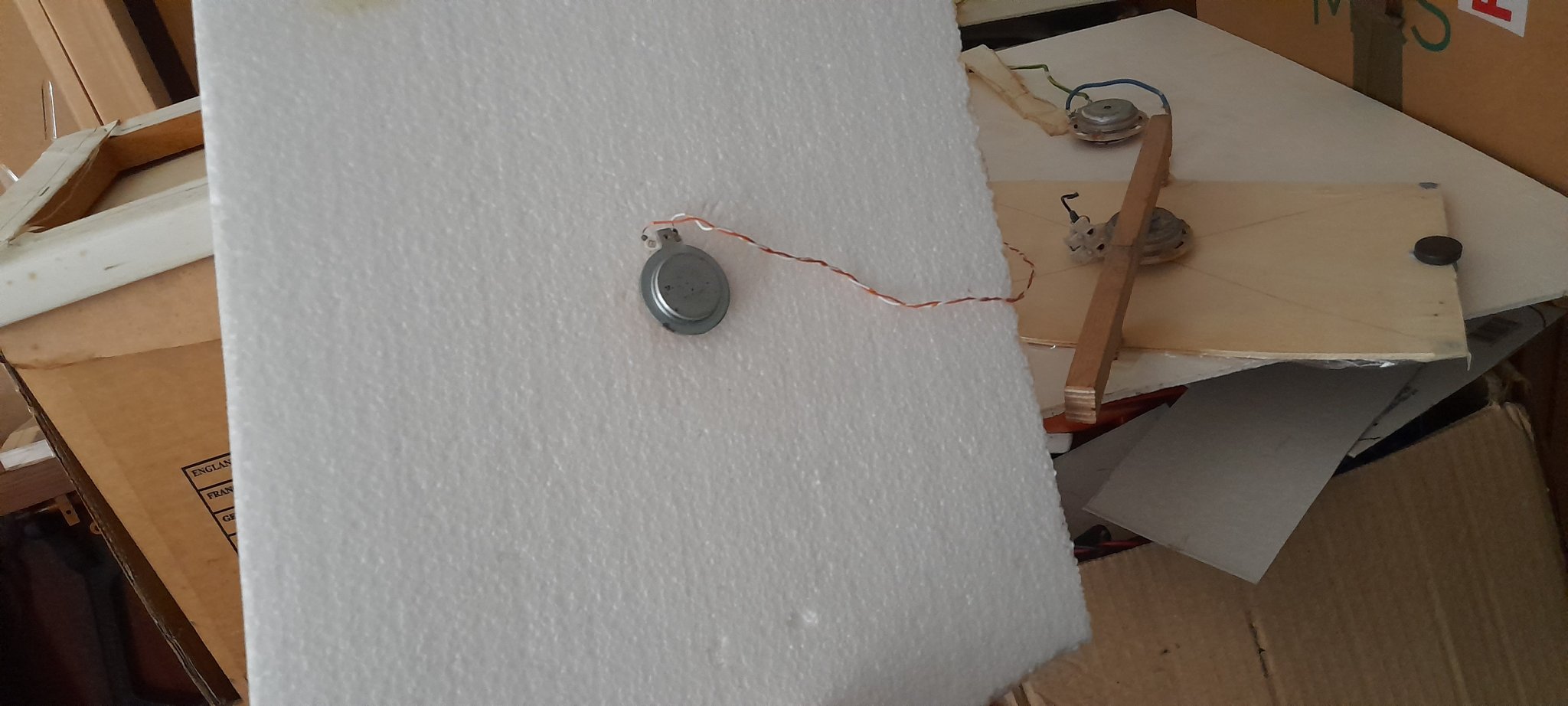

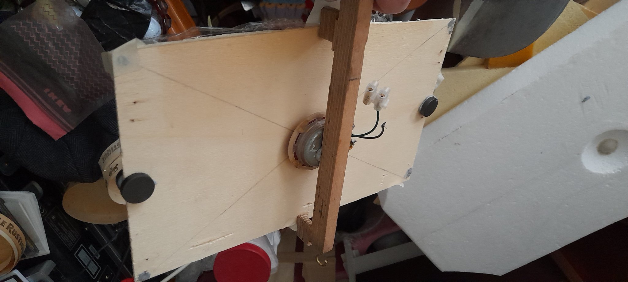

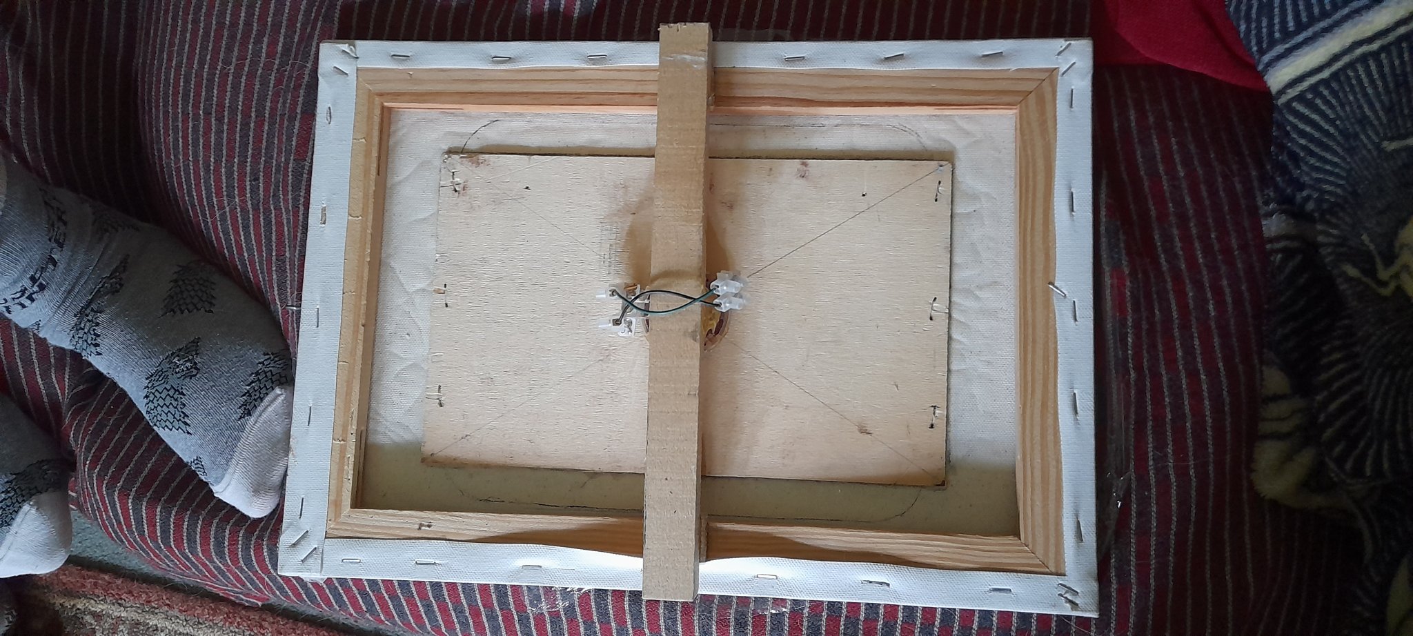

I just took a few pictures of some old test panels, which were lying around.
The first on the left is the back of my cascamite canvas panel with the enlarged crate ply attached.
I would have tried a larger crate ply but that was all I had.
Minimising the amount of loose canvas to stop flapping or buzzing.
I do not remember any problems with the corners?

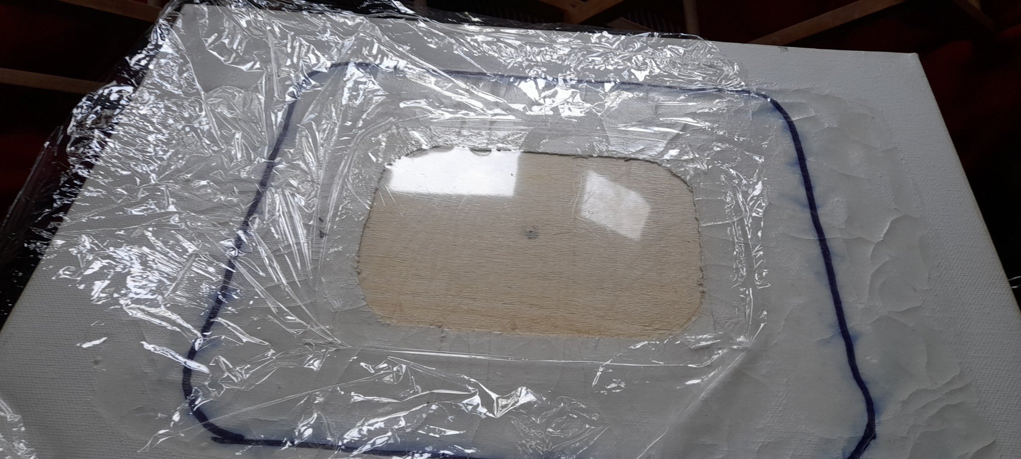

The second picture is the front of this panel.
I had forgotten that I cut away the canvas from the panel to minimise the damping on the panel 🤗
Which was handy for the cling film , giving a mm or so separation .

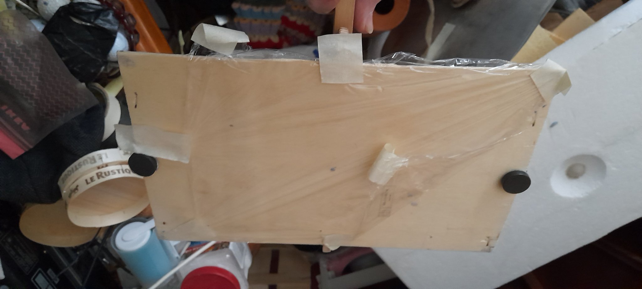

3rd and 4th are of a crate ply with weights for this panel only.
Two points were used for mounting, plus some film for testing.
The last is an old 5watt (I think) exciter on a low density EPS panel.
Steve.

The crate ply is a very flexible panel , in one direction only.
Although the rigidly in the other direction is not very rigid.
I presume this material is similar , maybe, to flexible ply ?
As I have said before, I like flexible light panels.
The sound of this panel is similar to my eps panels, but is still a little too heavy for that ultimate sound that I like.
