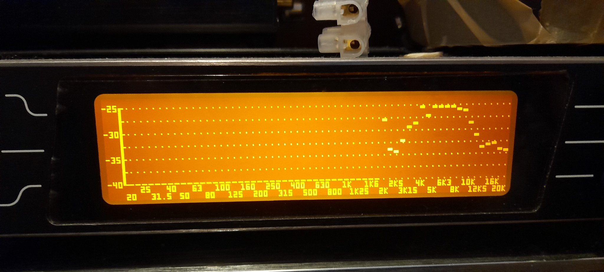

The pictures show some of my panels I'd tested.
The 5x2ftx1inch probably 70 grade? Response is shown in three pics at 1ft, and 10ft into the room,with and without the transmission line LF units.
As can be seen ,a pretty flat response can be achieved without eq.

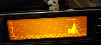

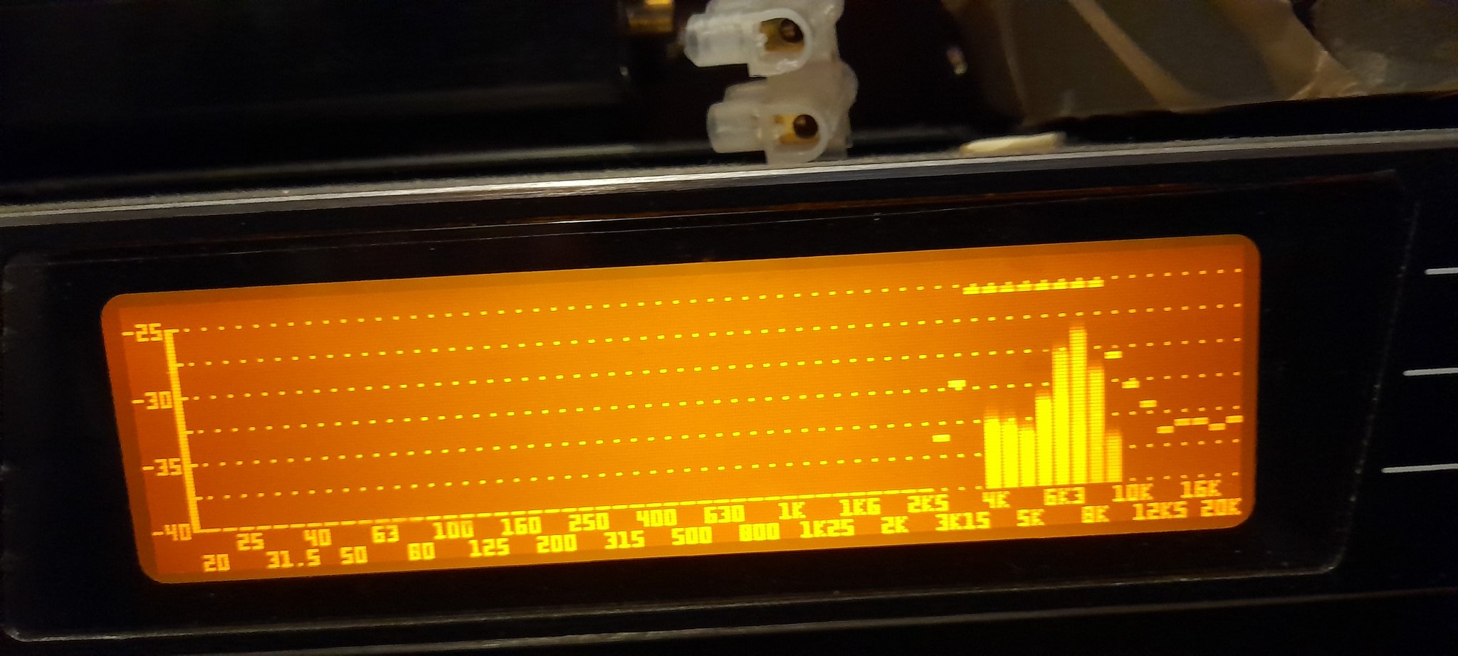

And by the way ,this is a peak hold of the sibilance caused by George Michael singing.
Obviously nobody told him his sibilance goes up higher than 7k ?
I sent the actual recording to Christian for him to hear for himself.
But it is not the sibilance that is the problem, it is the distortion caused by the sibilance.
