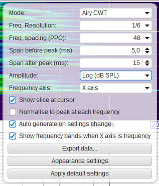

So maybe last (sorry to be long), there is the possibility to have an idea of what happens in the early ms so to get an idea of the "on axis response" by :
setting the window end before the 1st reflection (quasi anechoic response)
This view in my opinion is a bit confusing because it lets think the FR is fully detailed above about 250Hz which is my understanding not true. The property of the FFT is to get information for each n/T, T being the duration of the window. So if the window is 4ms, you have information each 250Hz. I hope not being wrong on that! No magic to get rid off the reflections.
An other possibilities is to set a frequency dependent window (go in Tools/IR windows)
For those both, you can remove the 1/n oct smoothing as by nature, those operations smooth the FR. You see in the above box that window is set to 4 cycles (something I read recently used in an other forum which is closed of 1/6 of octave, the line below shows 1/5.5)
An other possibility, the one I prefer, is to make a wavelet spectrogram which gives the frequency and the time information
In the colorized graph, horizontal is the frequency, vertical the time. The color gives the level. Under is the a 2D slice at a given time, here 12µ (not possible to set at 0!)
I like this view because by its principle it is close of the filter bank which is in the ear (unfortunately not the brain treatment which is after). The vertical areas in the spectrogram show modes, either panel or room. The horizontal one, the reflections
The interesting property of the DML as a wide range loudspeaker, almost all the band is time aligned.
I stop here. This post is already too long! I just exposed here some possibilities of REW I use.
Christian
PS : I see I have forgotten the "controls" box of the spectrogram for easily getting the same view

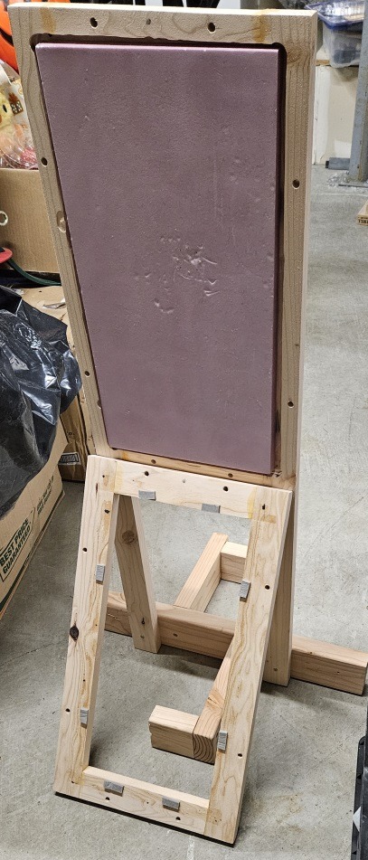

Hi there folks
I have finally finished my HYBRID DML speaker project > DML + open-baffle woofer + tweeter.
I will start with the wood-work. ( I had to build with no workshop and only hand-held tools )
The first challenge was to not only make a frame to hang the panels, but also provide a quite large baffle
for the woofer + a mounting position for the tweeter.
Using some imagination, I arrived at a rather unusual & unique design.
My starting point was to provide a strong & sturdy floor base-plate > 620mm x 540mm x 25mm = 5.5Kg.
( because these speakers go strongly down to 30Hz, I didn't want them 'dancing about' )
From this base I built upwards > apart from this base-plate and a 'hanging brace', there are only 3 pieces of wood.
Here are some pictures:
