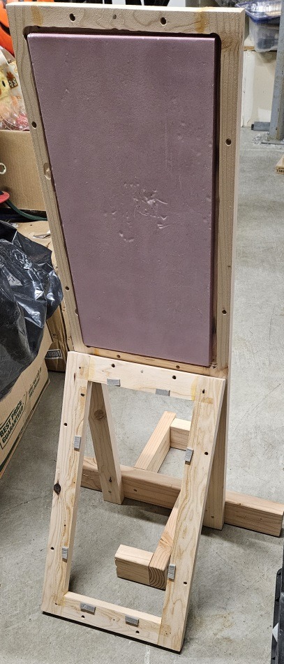

Sapphire Sloth,I spent many hours testing some things today and I started with some mounting tests. Here's this test frame:
Your frame reminds me a very similar frame I built in 2020 when I first started playing with DMLs. I wish I had pictures to share, it was exactly the same concept as your frame. Sadly, I got rid of it not too long ago as my collection of frames was starting to really pile up. Your frame looks a bit nicer, I must admit. I didn't bother to route out either of the two frame halves, I just used really long screws to join the halves. I put spacers between the two frame halves as I tightened the screws, to ensure that the pressure was pretty even around the perimeter. I could use different thickness spacers to control (crudely) the pressure.
Here is a link to a post I made at that time with a description of the frame and some results. Those results showed the best low frequency extension with suspension around the whole perimeter, at least for that particular panel.
https://www.diyaudio.com/community/...s-as-a-full-range-speaker.272576/post-6098619
I didn't actually recall this particular dataset until finding it just now, but I still tend to prefer the full perimeter suspension arrangement.

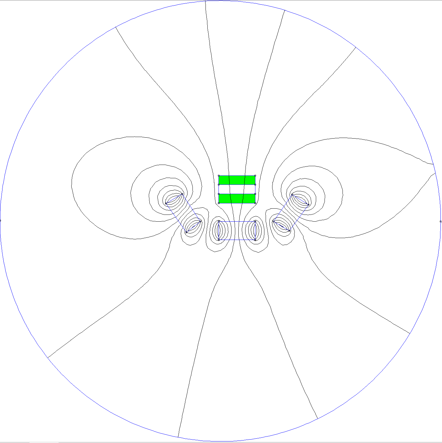

I was playing with FEMM and using an arrangement like this one below (three bar magnets) the field strength can be made more uniform in the Y direction without using a pole piece. These magnets are 1 units wide and 0.5 units thick. The difference in flux between the first green block and the second green block is just 9%. Those green blocks have a 0.25 unit gap between them which is larger than necessary if 1 unit = 2cm. With more tuning this could be normalized even better, and it scales fine.

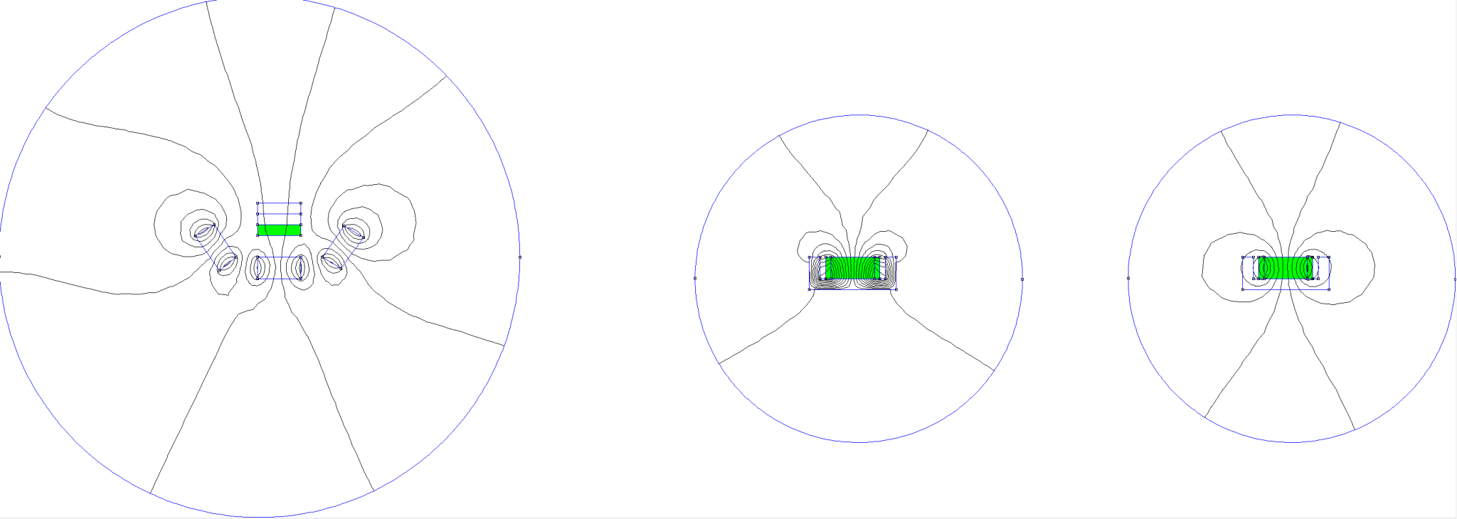

The biggest concern is that there may not be enough flux in the gap this way. I attempted a comparison to a tight coil gap with and without pole piece using the same size magnet:
Not sure if this sim is correct but the left = 3.9e-7 T, middle = 6.04e-6 T, and right=3.24e-6. So the left is an order of magnitude weaker than middle. This doesn't account for the third dimension though and using long bar magnets would improve this a bit, as would increasing magnet size. It isn't too practical to increase magnet size in middle and right designs but in left design there may be a lot of room for bigger magnets.
Oh, I selected the magnet block in 2 of those designs so that must not be correct in the middle and right ones. Idk how to model & measure this the right way when the coil is overlapping the magnet. Or maybe that is right, idk. Help? 🙂

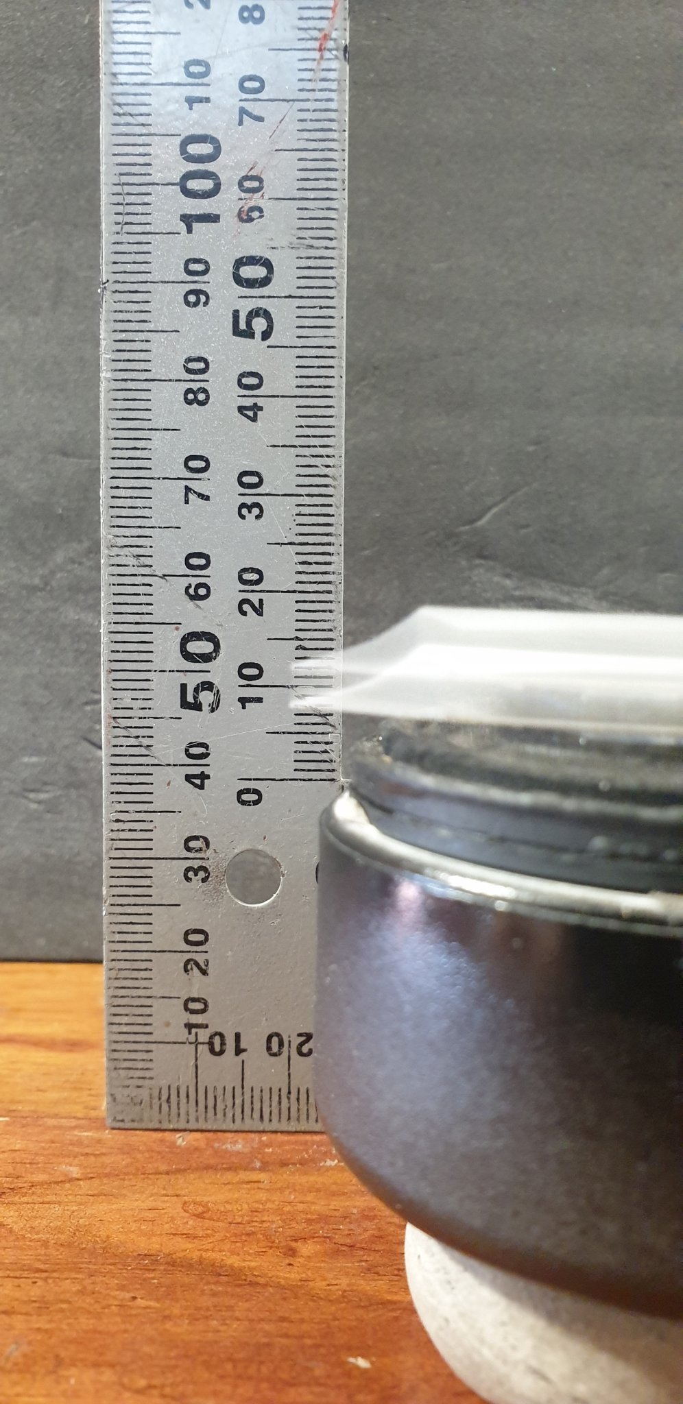

Hello Eucy,For interest, I recently measured the throw of a Dayton DAEX25FHE-4 exciter at 1.1mm in and 1.4mm out.
A Dayton 3.5" TEBM65C20F BMR driver measured 2.5mm in, 2.9mm out.
So if it could be controlled, and the panel be able to bend sufficiently, the BMR driver should provide more base than the standard exciter...Yet to be tried
Is it the maximum mechanical stroke on each direction or is it under the same amount of current?
