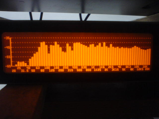

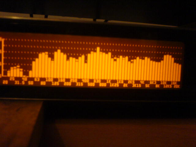

Hi there folks
I have been reflecting on my experience building my DML panels ( which now sound great ) and how
the initial sound was 'horrible & honky'. It required EQ to get them sounding good.
I also recall a post by another member - calling the sound "honky".
It occurred to me that if both I and another person experienced this same 'Honky' sound, then there would
surely be other people that have also found this shortcoming with their panels. That honky sound.
This got me thinking to present a very simple solution to solve/improve this problem for those experiencing it.
The solution/modification is a simple passive filter requiring only 2 components of standard value. (easy to get)
One coil/inductor and one capacitor.
( this modification will also improve upper region sound by removing a 'masking effect' )
It's a simple series notch filter that places an impedance into the line at about 600hz. The frequency of the notch does not change with load impedance.
The inductor coil in this circuit has a DCR of 2 ohms. The lower the DCR, the deeper the notch and the better the lower frequency response.
Download Xsim. It's very simple. And it's free: https://libinst.com/Xsim/XSimSetup.exe (This link won't take you to a website. It will download the file directly into your default download folder. Look for it there.)
