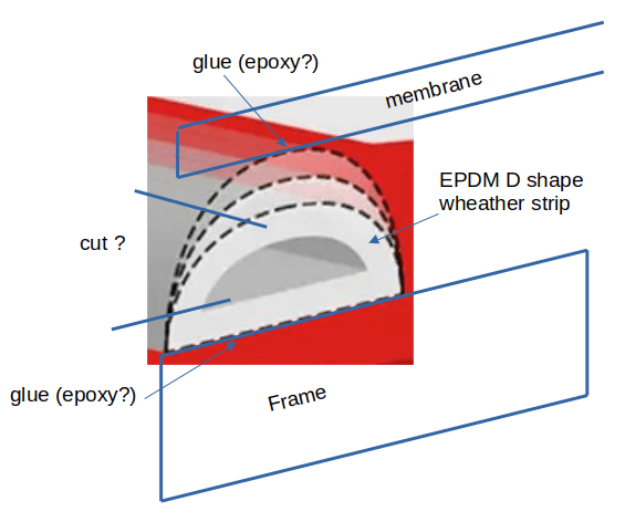

So I did an interesting experiment recently: I built a new frame for panels and I tested baffles. This new frame is like two picture frames that screw together to sandwich a panel, but I used a router to cut a ledge in the front half so it's like an L. I built it from 1"x3"'s that I made from cheap 2x4's. The opening size in the frame halves is 9"x19" but it fits up to a 11"x21" panel inside.
I tested different weatherstripping to sandwich the panel with between the frame halves, and I tested different locations and compressions, overall best was full top and bottom clamped tight (tall aspect ratio panels) and the long left and right sides free. I forgot to try using one spot on L/R sides in combination with top and bottom though.

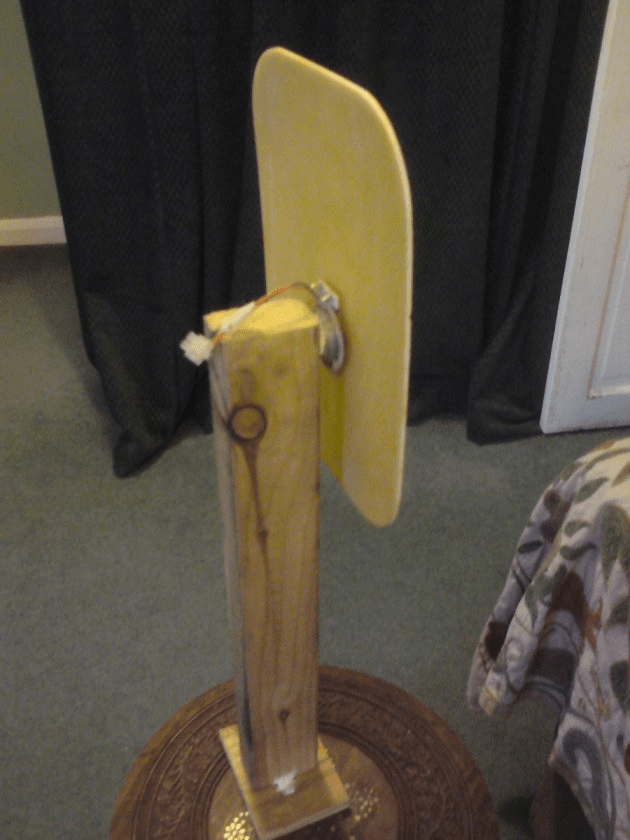

The more interesting test I did was with baffles. I had the panel in one mounting configuration and then I took some 2x6's and stood them up on left and right sides and measured the result. I made no changes at all to anything, just stood up the boards. Then I turned them 90 degrees from perpendicular to parallel with the panel's face and retested. Then I added a ~15" high and ~3ft long piece of scrap plywood below the panel face to mostly cover the gap between the panel and the floor. I only tested one panel in this frame so far so don't mind the specifics, just the differences. Here's the results:
The dips around 75hz and 275hz are caused by my room - previous outside testing proved that.
So the frame with no extra baffles has a 3" wide baffle already. I added an extra 2x6 on each side here, and the bottom was ~15". I did not do any kind of edge treatment, just normal radius that comes on 2x6's here. The 1x3's have pretty sharp edges, only lightly sanded.
