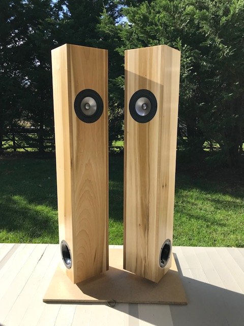

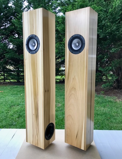

I started with MLTLs and did this one using the Mark Audio Alpair 10.3 drivers.
My first DML: https://www.diyaudio.com/community/posts/5978255/

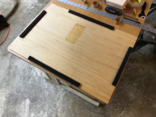

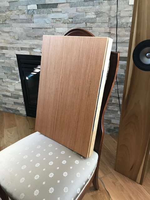

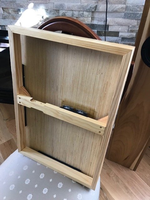

Thank you for the links. I've been away from this thread for nearly a year, so must've missed them. I'll be reading your posts from #5,825 onwards.I wasn't ignoring your request. Just took some time to get to it.

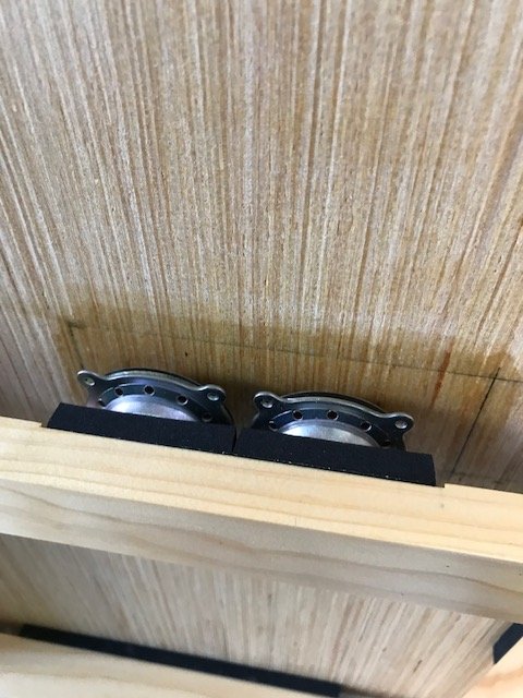

View attachment 1129460 View attachment 1129461
Sadly the images are gone from the link but here are some:

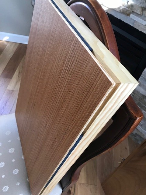

View attachment 1129469 View attachment 1129470 View attachment 1129471 View attachment 1129472 View attachment 1129473
My most recent DML is here, (and in the several posts immediately following)
https://www.diyaudio.com/community/...s-as-a-full-range-speaker.272576/post-7121486
And here is a link that includes a few pictures of the carbon/fiber balsa panels (and frames) that never quite got built (yet).
https://www.diyaudio.com/community/...s-as-a-full-range-speaker.272576/post-7049119
Eric

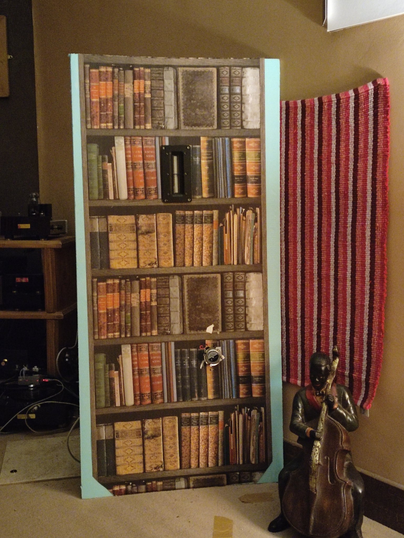

Bollocks!!! Just dragged this old project up from the hifi dungeon ( bottom of the tool shed) while I add another layer to my cardboard panels, I thought what the hell I've not tried my 32mm exciters on these bookshelf speakers ( get it!)
So attached exciter to the front as this sounds better I found in the past with these panels, slotted in the ribbon tweeter's hooked them up and sat there open-mouthed. Having spent the last hour gluing up my cardboard jobs, which I was very happy with, I can tell you that's where the bollocks moment happened.
To make things worse these are just lent up against the wall no frame, no wire nothing. Now what do I do?
I'll post a video using the same song at the same volume so you can compare and let me know which you prefer.

I listened to this video on my conventional speakers (Vanguard 2 way bookshelf monitors). This sounds very good. Nice.
Also listened to the second one with ribbon - also very nice. What is membrane material? Looks like paper faced foam core?
Both panels use the ribbon, first panel ( bookshelf) is XPS 20 mm one side covered in bookshelf themed wallpaper , the other panel is stiff cardboard, I'm a bit torn between them at the moment, XPS has slightly better midrange and the cardboard has slightly better bass.I listened to this video on my conventional speakers (Vanguard 2 way bookshelf monitors). This sounds very good. Nice.
