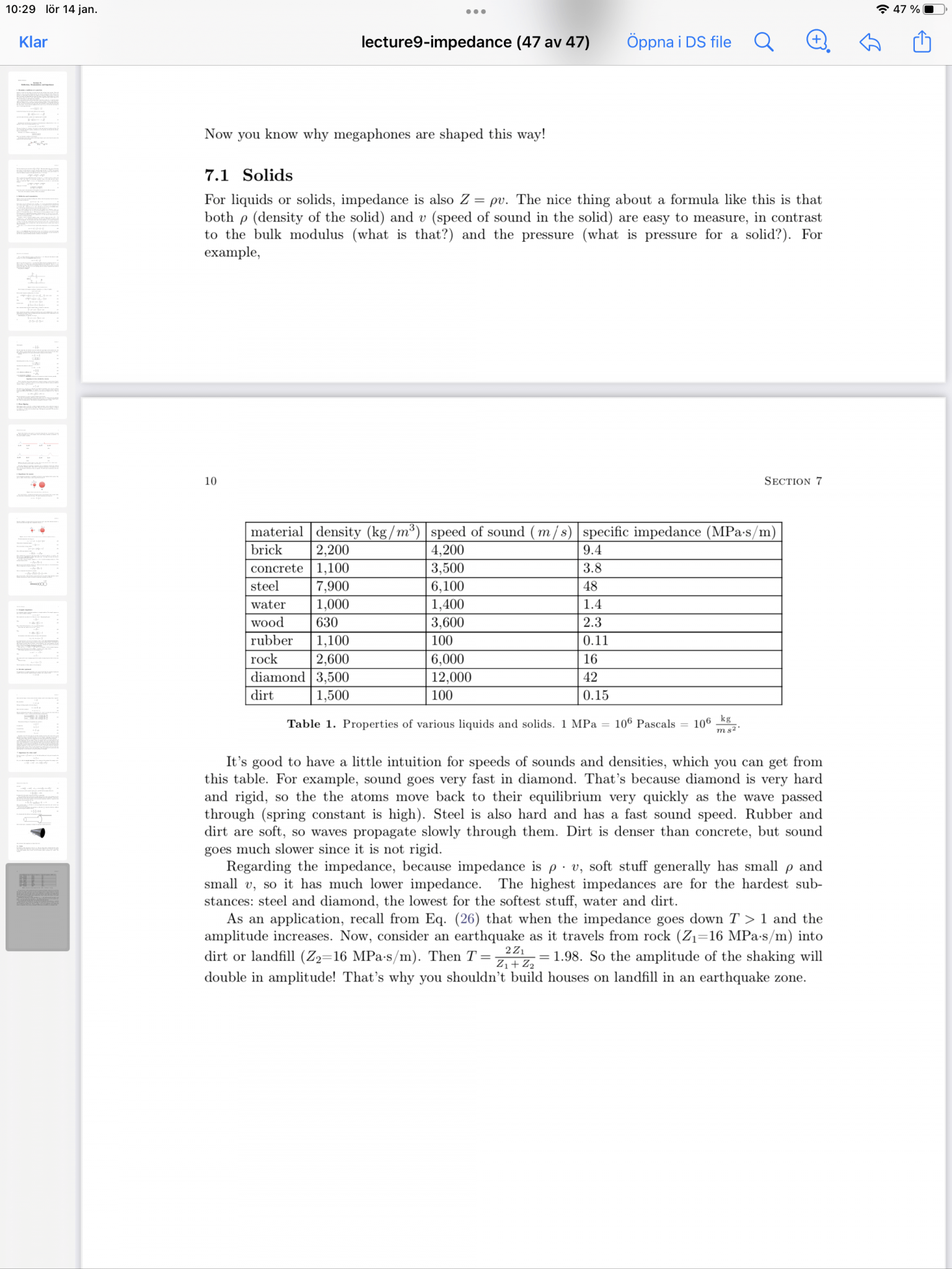

And some background info on impedance in solids

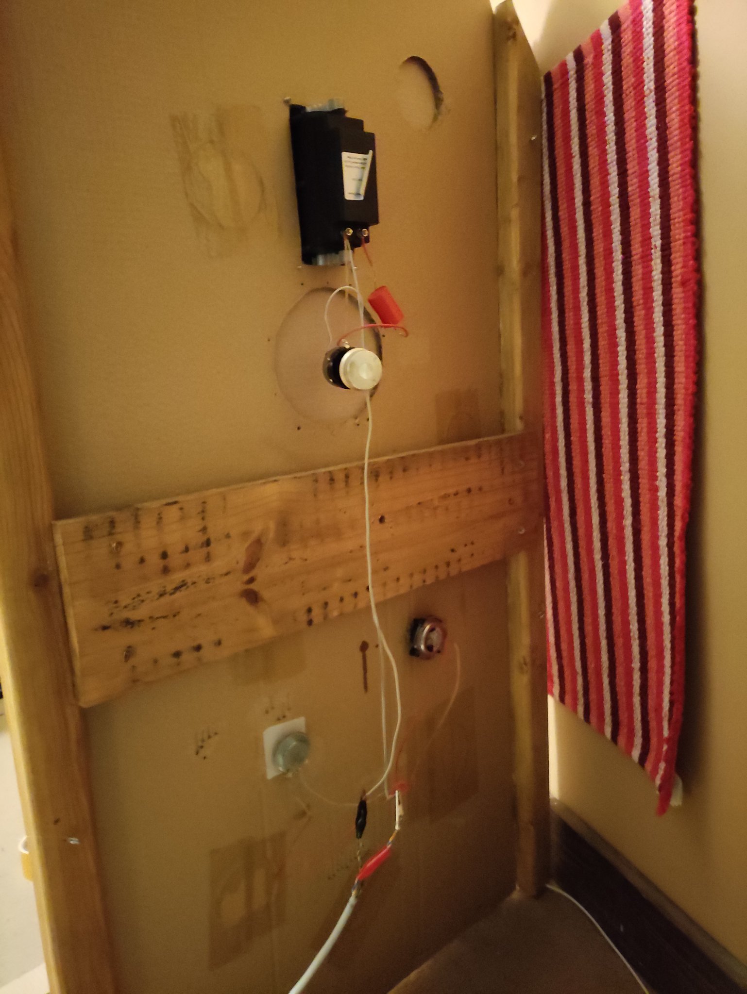

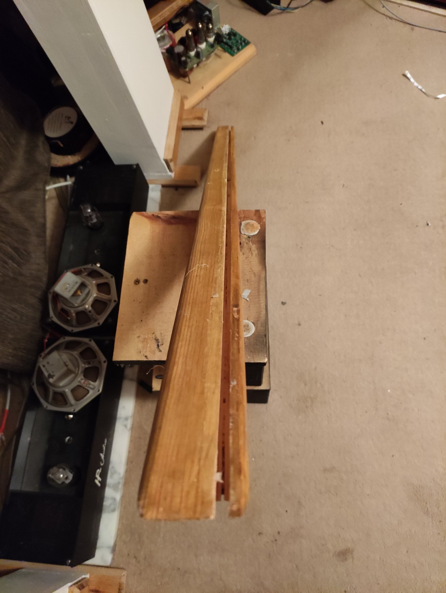

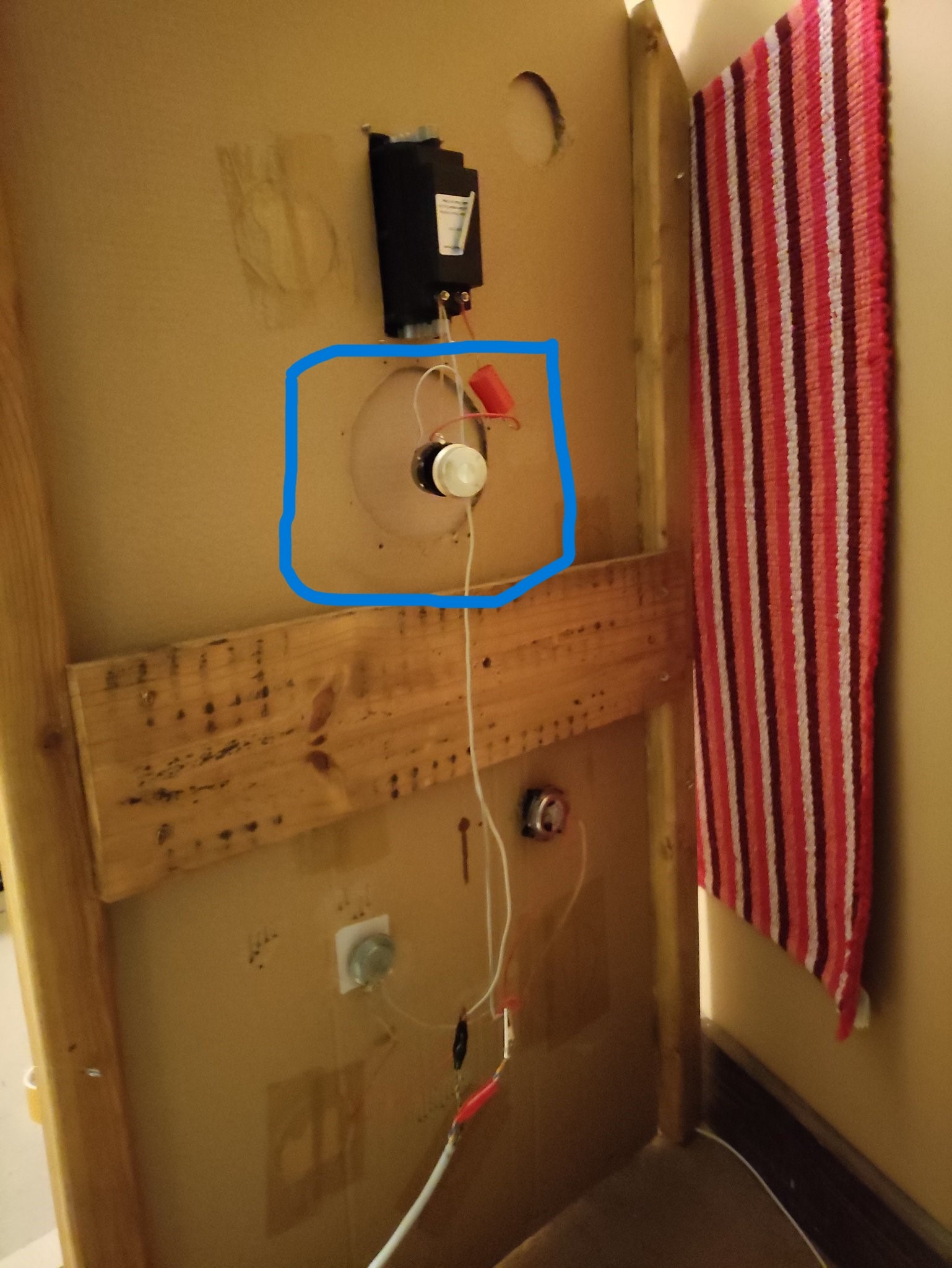

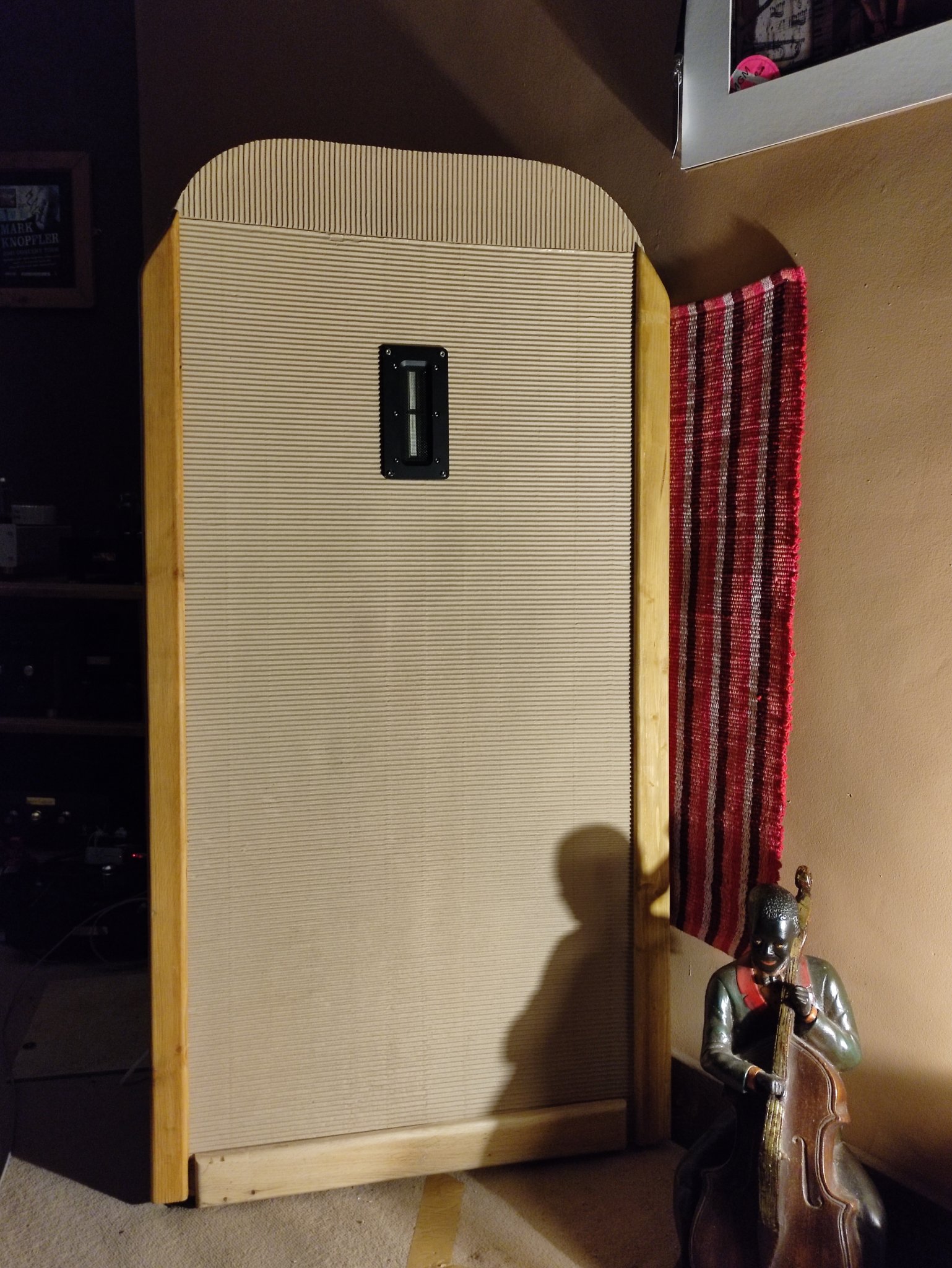

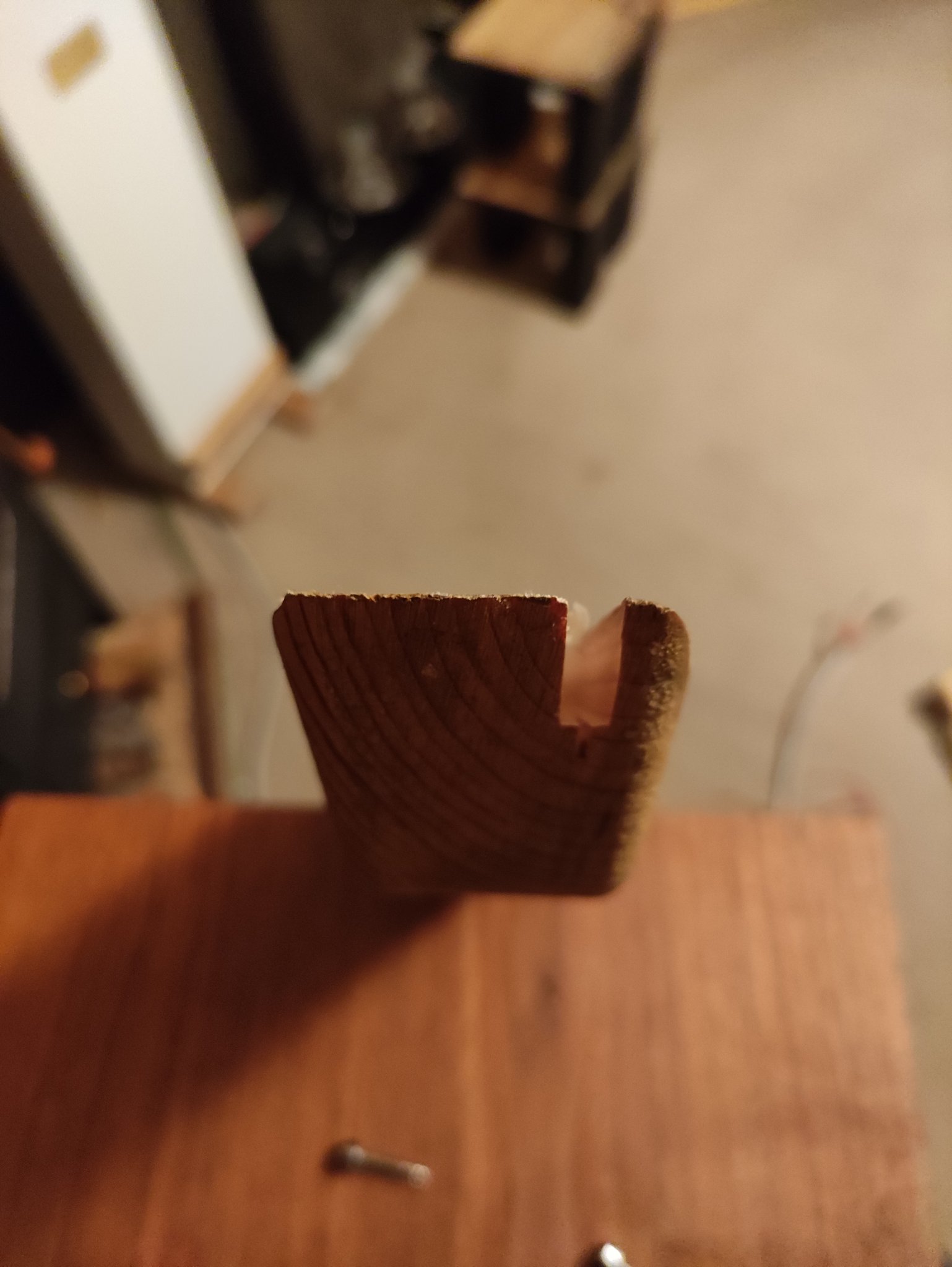

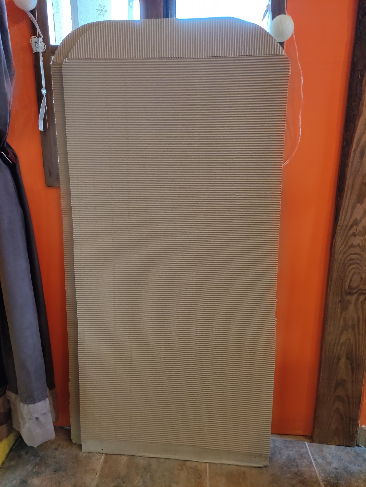

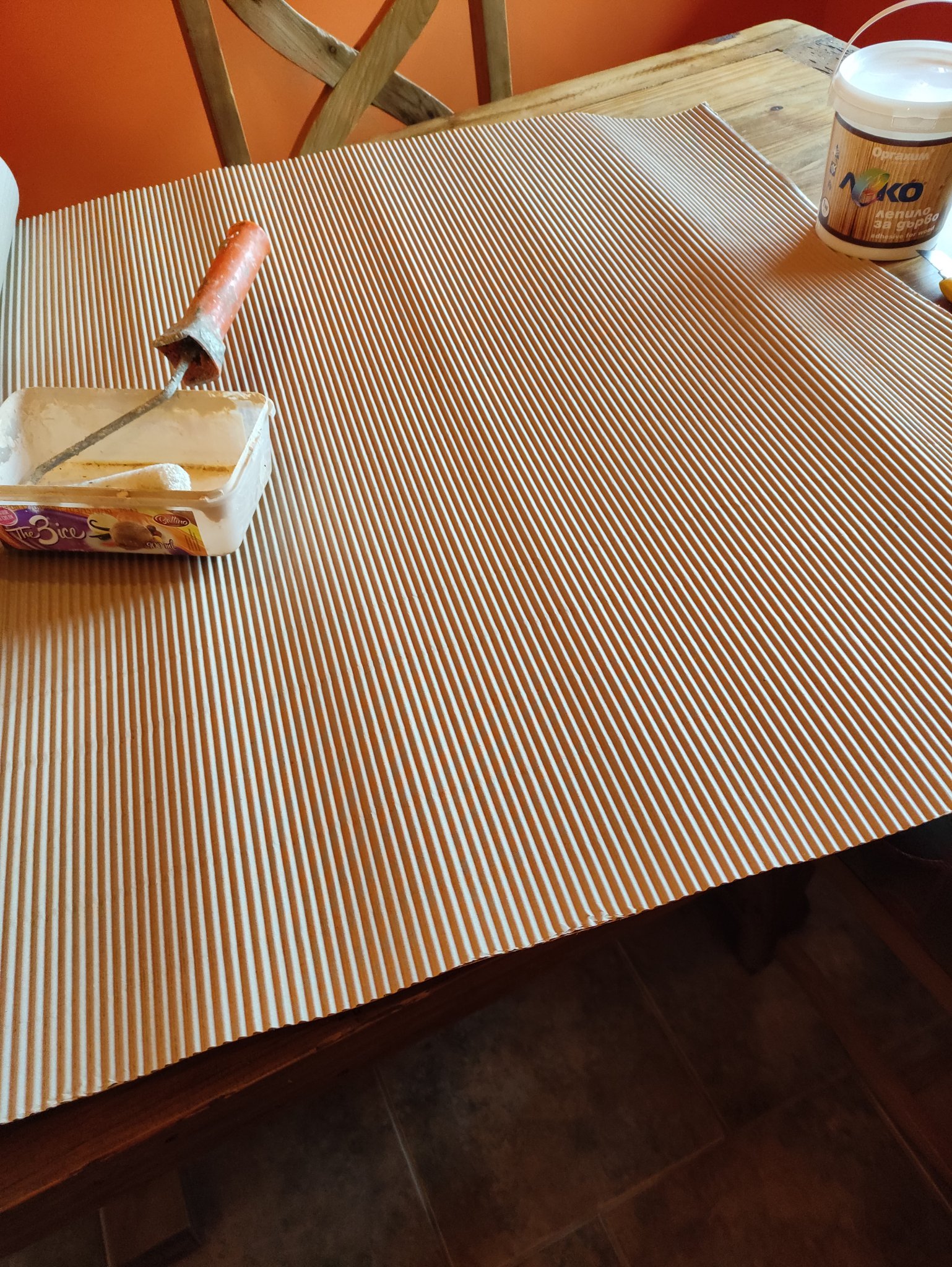

Right as requested some pictures of the build, added a final sheet of corrugated cardboard/ paper, the difference that has made to the bass has surprised me, these things really kick down low now.

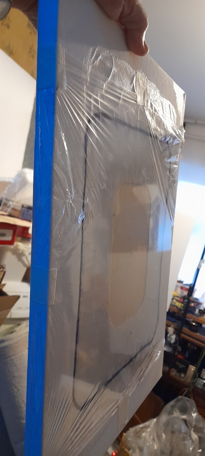

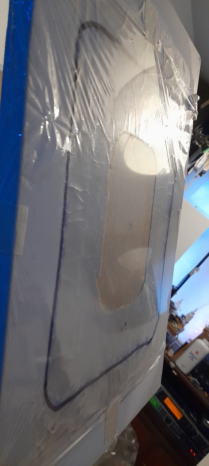

Just found some pictures I took in November.
This was my first attempt with the art panel.
I did the same with the proplex but I did not have cling film big enough to cover the whole panel.
So decided to use small pieces instead.
Steve.
