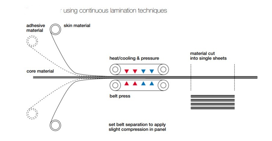

I'm glad that you posted that link to Stanley Rich patent. 🙂
He had achieved certain results in those before-personal-computers times. His thinking is quite interesting, even though the air/gasses can be compressed, but 'under dynamic conditions' it might be not be compressed for a moment, that i,s in sudden movements. His idea too was to glue the 'vibration dissipative material' on to the panel surface for 'damping flexural vibrations' on the panel.

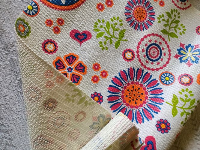

What do you think of such materials as in the images to glue to the panel surface, front or both? These sheets were used to cover the shelves, drawers of kitchen cabinets to safeguard the surface.

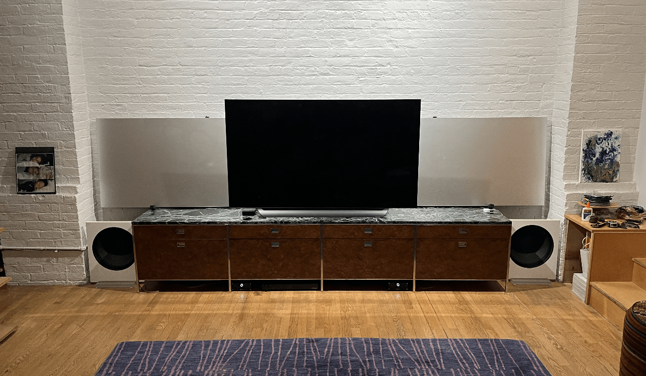

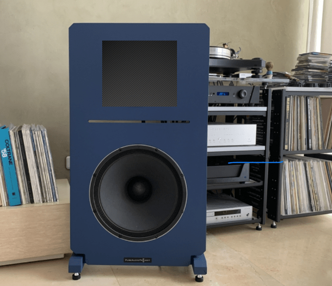

If you select the right drivers, place them properly, power then sufficiently, and have a large enough room to propagate the bass they can work very well indeed.
I currently use PureAudioProject 15" woofers with my aluminum-honeycomb core | aluminum-skinned DMLs.
PureAudioProject had Eminence optimize a 15" woofer for their open baffle use. Drivers like these can take easily take you down to 29-32hz and can crossover as high as 250 hz, which can prove interesting for small DMLs.
I drive them with Hypex NC122MP amps scavenged from a Hypex FA123 and remounted into a GhentAudio case.
BTW ...
I've got four of these Hypex stereo amp boards that I have now repurposed and consolidated from two previous listening areas. They power the 5 DMLs (front left, center, front right, left rear surround, right rear surround) and the 15" OB woofers in my home theater | primary listening area.​
I really think this is overkill for driving my Dayton Audio Thrusters.​
I think|suspect DMLs can perform very well with much more modest amplifiers, but I had them.​
I tried to get people on this thread to discuss optimal amplification for DMLs, but it didn't go far at the time. Such a discussion would certainly interest me.​
You can search my posts in this thread for other pictures of my current woofers in my home theater as well as the single subwoofer I built from a pair of the same drivers suspended, facing each other, and driven in opposite phase.
I love DMLs, but I still like what's possible with OB woofers. That said, I do have one thoughts on a DML or DML-like subwoofer. More to follow in time...

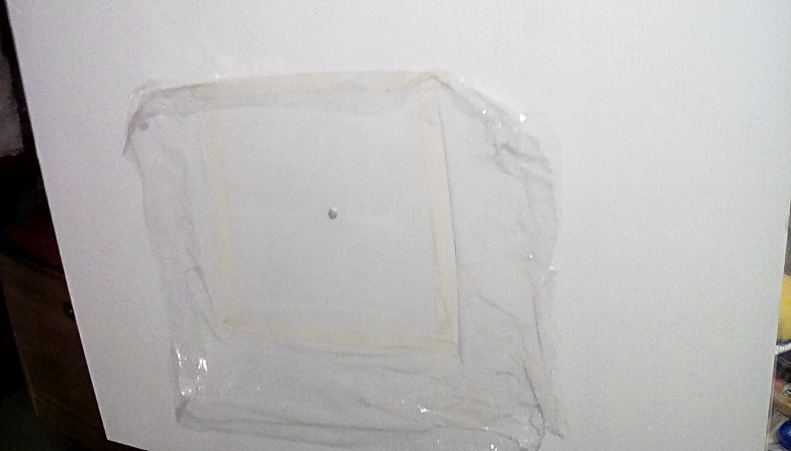

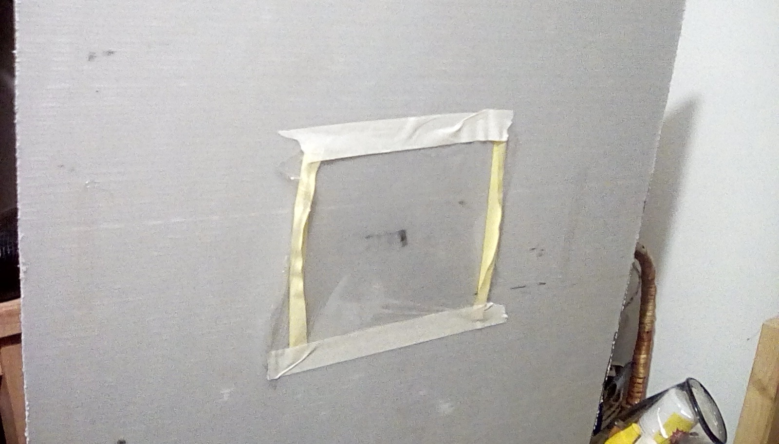

I was freezing my nuts off in my cold room today listening to cling film attached to my panels.
thankfully the improvement was worth it.
I was thinking I might try film on my small card and veneer panels ,without the dome?
this also made me think ,if I use two exciters close together will the film prevent the comb filtering between the exciters ?
it's only a thought , but interesting.
while I was experimenting ,I remembered why I did not want to use the 6mm proplex.
The frequency response was so good I did not want to ruin it .
I really wanted to use a panel with a poorer response and try and improve it .
But luckily the response was still pretty good.
Although it is difficult to take a measurement that shows a huge difference as they are pretty much the same, but slightly different.
I did quickly place a aluminium foil which had a plastic coating onto the panel.
This was a lot louder and the response was a little rough.
so different materials will react differently.
cling film is very difficult to handle, especially if like me you have a bunch of bananas for fingers.
I decided to try a thicker polythene film on the 4mm panel which was a lot easier.
I was dragged away at this point, but the sound was still very good, first impressions that is.

Some pictures of the test panels, very basic but it works.
The first picture is the 4mm panel , I used a little blu-tack in the middle to pull the film away from the panel, what effects this had on the film I do not yet know ?
Picture 2 ,I used what I had at hand to make the air gap bigger on the 6mm panel.
Not even sure how necessary it is to seal the air gap as it tended to work anyway ?

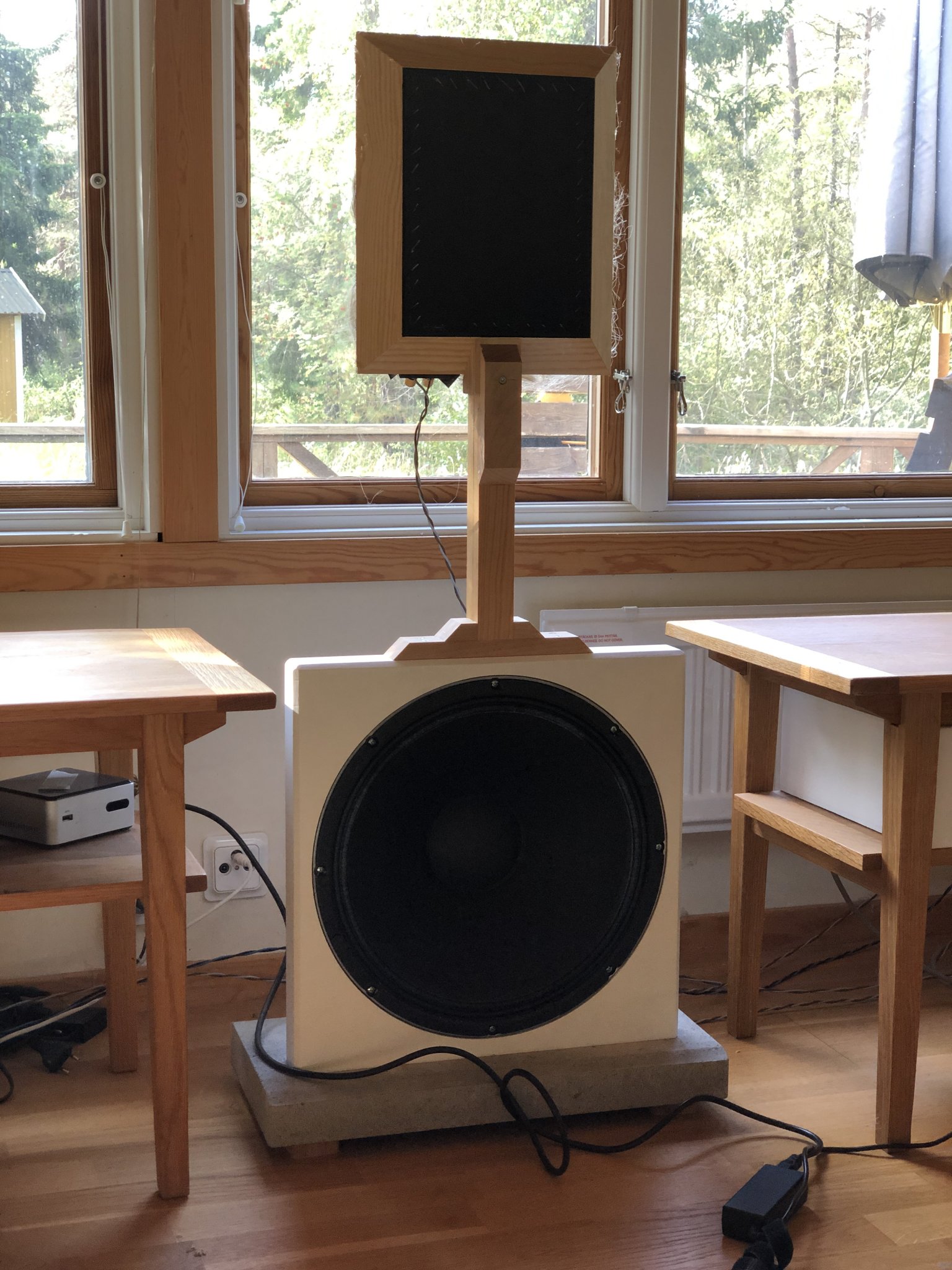

Yes, I have used Eminence delta lite 15” with very good result. It’s a small baffle so iI used dsp to crank up the base a bit.
It was easy to integrate it to the panel.
Low WAF though…
I crossed it over at 300 Hz to reduce the floor reflection cancellation.
