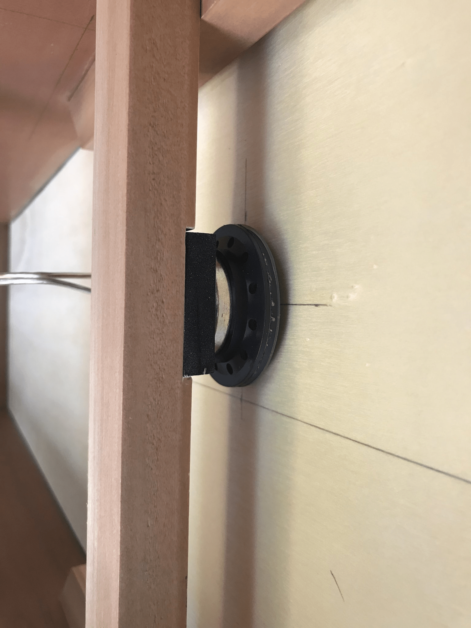

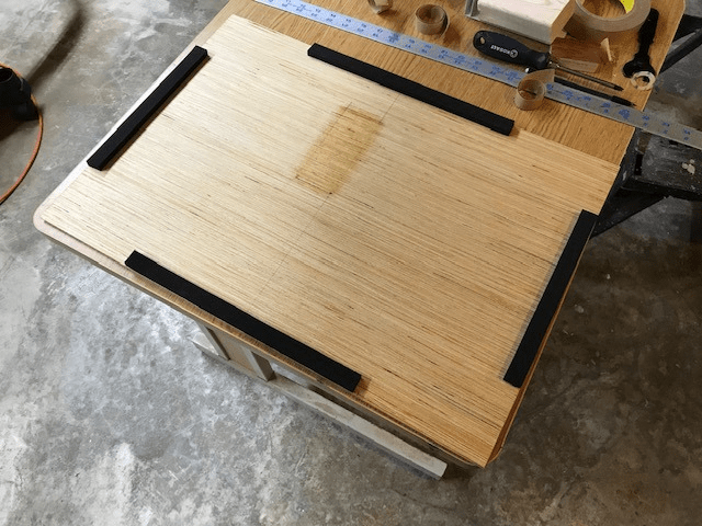

2 questions:
How have you attached the exciter to the frame is it flexible or fixed?
The black ribbons on the panel, what are they made of and how to they work?

In both DML builds, there is a block of EPDM foam between the back of the exciter and the spine that connects the exciter to the foam. The foam has adhesive already on one side, and I added a thin pressure sensitive adhesive strip to the other side. I have been using the foam there just to give the connection a bit of compliance in case of some warping of the panel or spine over time. I can't say for sure if it's any better or worse than a rigid connection, but I don't really think there is much effect.
By black ribbons I presume you mean what's on the perimeter of the panel in the image below. That is simply the same EPDM foam (3/8" x 3/4"). Likewise I used some thin pressure sensitive adhesive to attach the back of the EPDM foam strips to the face of the frame. Similar to yours, I think.

AF,Adding foam in back of the exciter magnet will change the sound because it adds damping properties. Not saying its good or bad as its personal preference but the sound will be different.
Could be. I concluded some time ago that it made little difference but I can't recall what tests I did or even if I really had any idea of what to look for at the time! I suspect the most of the reaction comes from the mass of the exciter, at least at high frequency, but where is that transition and what happens below it? I don't know.
Coincidentally, just a few days ago I was thinking about this question again. I began to prepare another test of that, but never really got started. Maybe I'll get back on that if I can't think of sopmething better to do.
What's your typical mounting like?
Eric

The idea of putting some type of foam dampening behind the exciter was from Shelly Katz Podium speakers in which he used it to tune the sound of his panels.AF,
Eric
Using any type of damping behind the exciter will reduce reflections and make it sound darker. Its no different the Acoustic Room Treatments but instead of the damping material being on the wall/room its directly on the speakers magnet. This technique is even used on Open Baffle type of speakers that are to close to the wall.
My mounting is like yours except I use Epoxy adhesive if its going to be permenant but if temporary for experiments I just use double sided tape.AF,
