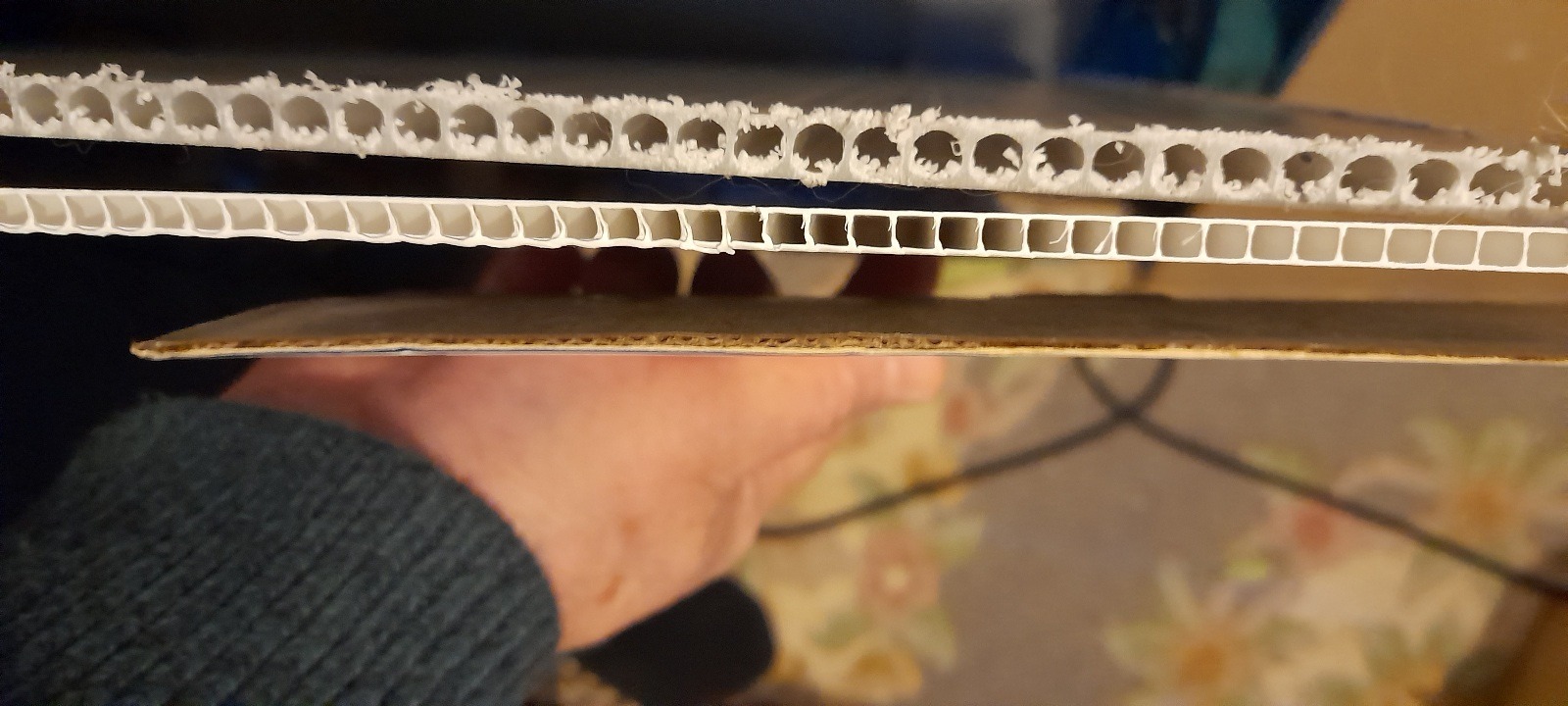

The 6mm has round flutes with thicker walls, the thinner proplex has square flutes and starts to look more like correx.
Proplex has a strong output down to 40hz with my 10 watt excites, But I need more power to push this panel harder.
The thinner proplex starts to look like correx with much lighter and thinner walls.
The correx is heavy compared to EPS.
My exciters can drive the 4mm proplex ok.
Correx is 3mm.

How did 3mm Correx sound?
Can you tell more about that cardboard? Thickness, length and breadth, and whether it is a honeycomb one? Thanks.
It's your standard cardboard but I have added 2 more layers of corrugated paper/ cardboard , I will be adding a final piece reversed ( corrugated part facing out) this will give it the appearance of an old washboard 😄. The size of the panel is 130 cm X 60 cm it has 2 exciters per side one 32 mm and a small 25 mm strategically placed after many listening sessions, ribbon tweeter fills in after 2400 k and is on a L pad so it can be adjusted to taste. Sides are held solid only the top and bottom are free to move.

I think this stuff comes in different materials some seem pliable while others seem brittle, have you found this? The pliable one if you do the tap test seems a bit flat/ dull while the other one has a bit of ring to it.
The picture shows the round and square flutes in the proplex panels, plus the 1mm corrugated cardboard.
The round flute panel is much heavier .

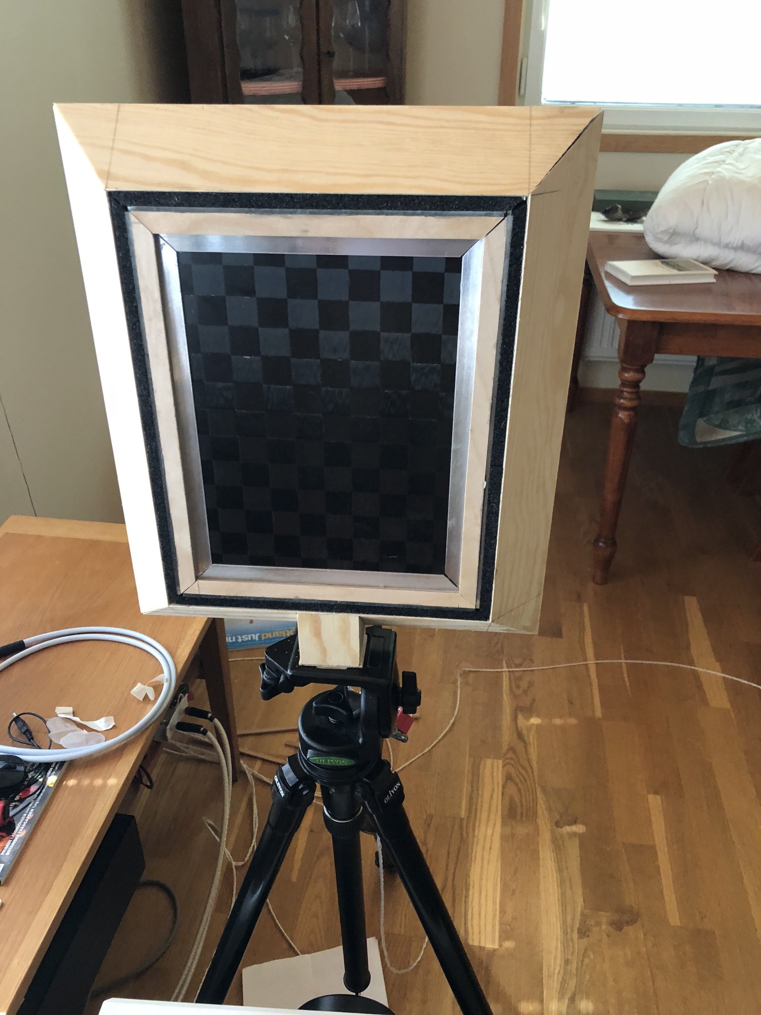

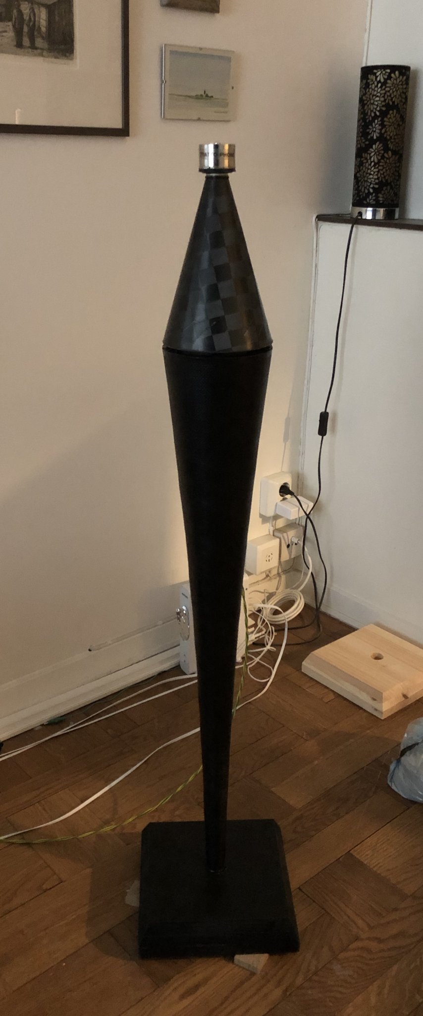

I just rememberd one more input / inspiration that I had when building my first version of my flat speaker. It’s a patent by
BENDINGWAVELOUDSPEAKER+
(75) Inventor: HenryAzima,Cambridge(GB)
you might allready have covered this in the thread, I haven’t checked. My apologies in that case.
It’s about moving from a finite panel to infinite panel. My understanding that its very much in line with the göbel design.
It’s dealing with fact that the incident wave induced in the panel is reflected back from the edges with more or less the same energy. You can see the effect in some of the graphs In the patent.
I’ve been struggling with this problem in another bending wave concept ”the walsh speaker” there it’s very clear that the reflected wave is creating distorsion. The walsh speaker is actually working in both modes bending wave and piston As a panel. But the design is a cone instead of flat. I’ve included a picture and the patent for reference.
I’ve also tested to create a border with a stepwise change of the impedence making it more effective to capture the incident wave at the edge.
It’s the huge difference in impedence between air and the panel that causes the reflection.
Thomas,
I'd be very interested to hear the details of your stepwise impedence change. I've been thinking along those lines too but have not tried anything yet.
Eric
Reactions: chdsl

I don’t understand this. AFAIK, a stepwise impedance change is what causes reflections in the first place. A smooth impedance change allows minimal reflection, no? This is the principle of impedance matching in electric theory or transmission line theory - to prevent reflections. And principle used in acoustic black hole edge treatment.
Or are you talking about something akin to a quarter-wave optical coating?
