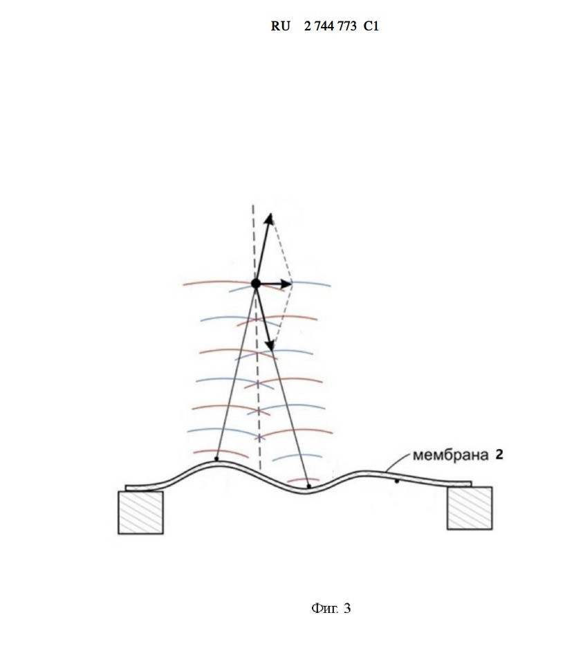

Take the blinders off your brains https://www.nature.com/articles/s41467-021-26375-9I doubt it. If somebody wants to waste money patenting a useless idea, I'm sure the US patent office will be happy to take it. Plus I doubt that patent attorneys were ever really obliged to understand the technology to that extent. And modern wage slavery being what it is, the attorneys probably don't even have time to read the patents.

Aren't those patents Danilo Herger's, so why the worry?Take the blinders off your brains https://www.nature.com/articles/s41467-021-26375-9
Well, Karavashkin is not an authority for you, so look at an authoritative publication and think about how to improve the DML panel. And this information will help youAren't those patents Danilo Herger's, so why the worry?
But why worry about Danilo Herger's US patent applications?Well, Karavashkin is not an authority for you, so look at an authoritative publication and think about how to improve the DML panel. And this information will help you
Can you tell more about that cardboard? Thickness, length and breadth, and whether it is a honeycomb one? Thanks.No just simple stiff cardboard, I think my journey has ended , can't see I can improve in the sound I'm getting now . Just need to make them look more attractive.
I'm worry? You are confusing something, anxiety is just observed in you)But why worry about Danilo Herger's US patent applications?

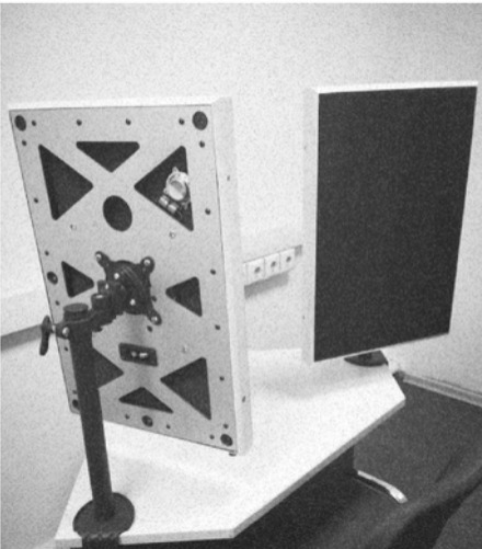

Well, Danilo Herger's 3rd Russian patent RU2744773C1 applied on 10.08.2020, granted on 15.03.2021 mentions Karavashkin "thesis" and the image of the constructed speaker, reminds me of Mescalito speakers.I'm worry? You are confusing something, anxiety is just observed in you)
And the so-called Transverse technology,
is included in the patent. Herger's US patent application
- Full Range
- A Study of DMLs as a Full Range Speaker
