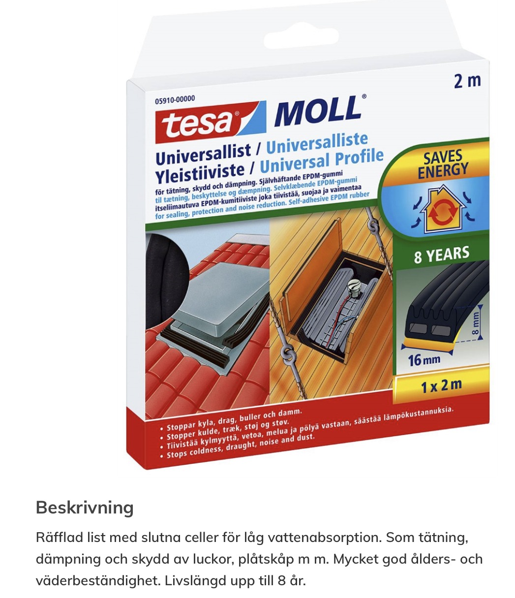

Thanks. I can find Tesa here. Is that one double sided? I mean self-adhesive on both sides?I’m using an insulation foam from tesa. I’ve tried many different foam and rubber. This is the one that works best.
Im using all around the edge no gaps.

What are the other tapes you used, so not to buy them?I’m using an insulation foam from tesa. I’ve tried many different foam and rubber. This is the one that works best.
What kind of question is that???😵What are the other tapes you used, so not to buy them?
