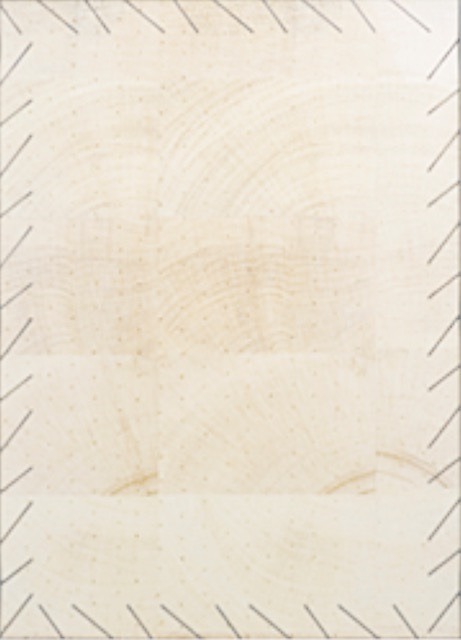

It is I, who asked you about the puck. It is to get rid of the standing waves from interfering. Thank you for the info. Can you tell us about the angled incisions around the perimeter in your Göbel clone? Thanks.No I have not used the puck Solution in my first speakers,the smaller ones with only one exciter.

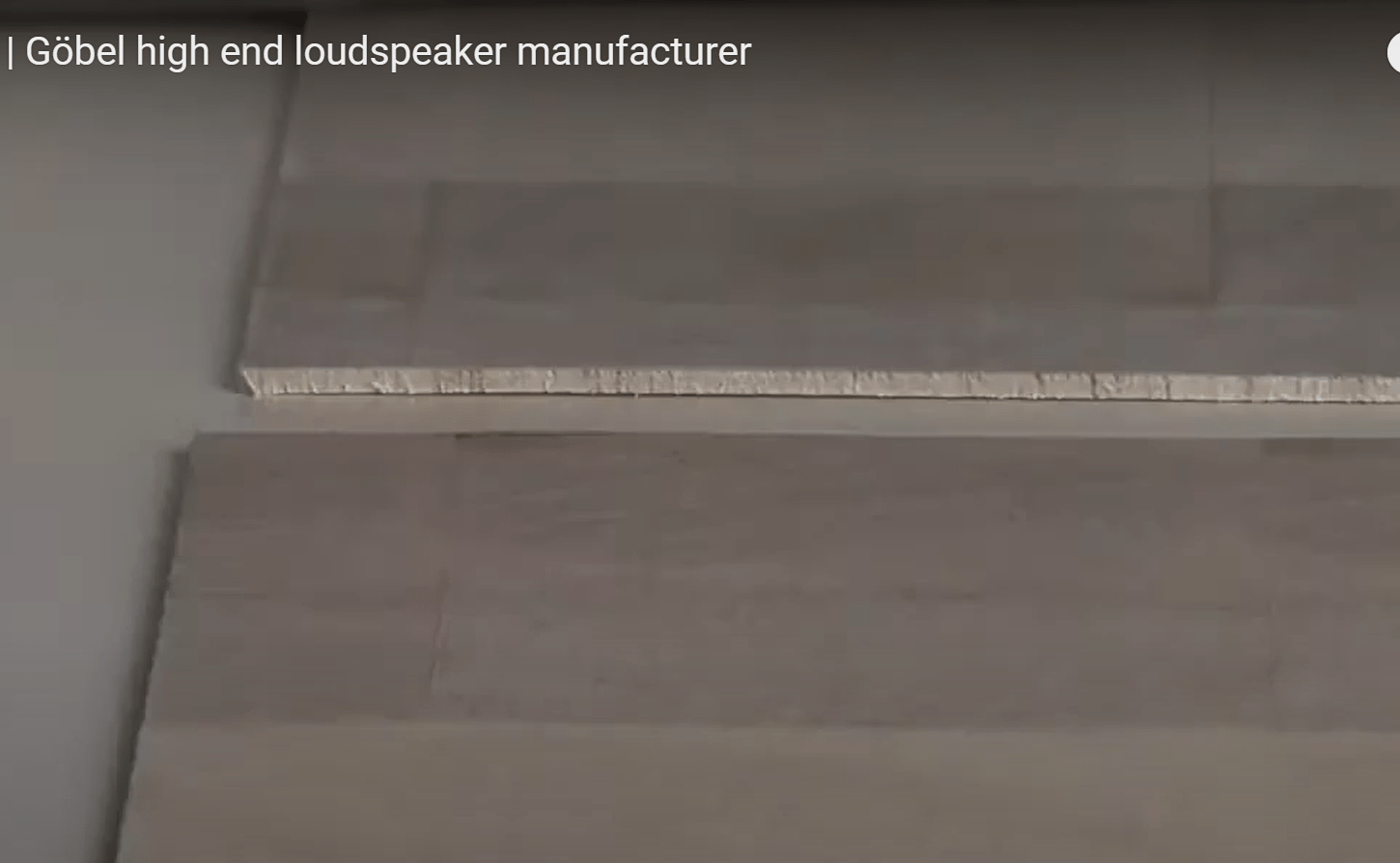

It seems to me to be a 3 layer composite, balsa core with cf/epoxy skins, and perhaps a thin finish coat for appearance and UV protection.
But maybe they count like this:
balsa core in the center, plus these four layers on either side:
epoxy
fiberglass (or carbon fiber)
epoxy
finish
which makes 9 altogether.
Or maybe they consider the fiber/epoxy layers to be a single layer (as most would), but count the pore filler as a layer, and apply the finish in two coats which they count as individual layers. But I'm just guessing.
Anyway, you can see them being made here;
this was obviously from the time before they switched from fiberglass to carbon fiber for their skin layers.
I just watched it again and realized that they might be using the same trick that I suggested to @Sandasnickaren a few posts ago, That is to drill small holes in the balsa layer to allow excess epoxy to flow through the board and into the absorbant batting. The holes are the dark spots in this image from the video, I suspect.

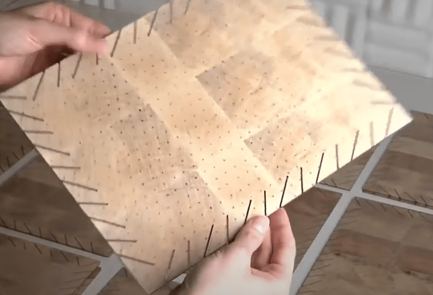

From the photo you posted, it looks like the balsa is perforated. I haven't watched the video yet, though. I read somewhere that they are using heartwood for the membrane.

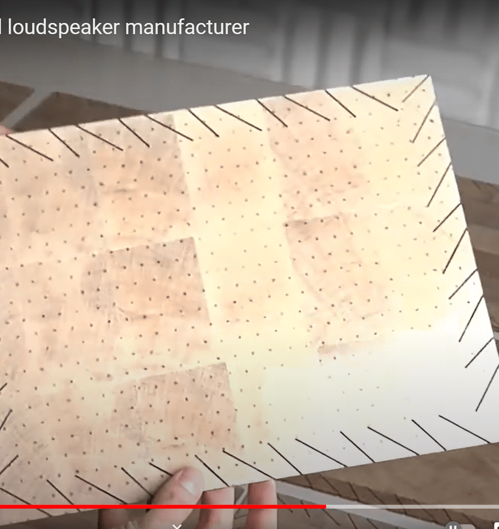

Thepurpose of the incisions is to reduce (trap) the reflections from the edge of the panel. I’ve tried with and without and there is a massive iprovment with the incisions. The panel is also glued to a soft rubber that also reduces the reflections. I’ve tried to enclose the edge with rubber as per goebel it didn’t make a noticable difference in sound. But it looked really uggly😉.It is I, who asked you about the puck. It is to get rid of the standing waves from interfering. Thank you for the info. Can you tell us about the angled incisions around the perimeter in your Göbel clone? Thanks.
I just copied the göbel incisions.
Interesting. I always wondered if they made much difference. I did saw similar incisions in a plywood panel once but wasn't impressed with the difference. But at that time I was an extreme novide and didn't really have any idea how to look for the effect.Thepurpose of the incisions is to reduce (trap) the reflections from the edge of the panel. I’ve tried with and without and there is a massive iprovment with the incisions. The panel is also glued to a soft rubber that also reduces the reflections. I’ve tried to enclose the edge with rubber as per goebel it didn’t make a noticable difference in sound. But it looked really uggly😉.

From the video, I think the balsa sheets are glued horizontally.

From that video,
Before pressing the film, the sheet doesn't look like having perforations,
but after the film was pressed, there are perforations. Maybe, it is how the film looks like?
Also, the 3rd from top balsa sheet's grain direction is different.

I noticed that too about the perforations. I don't know exactly what to think of the first picture, where there are no apparent perforations. In fact, it doesn't really even look like end grain balsa. I wonder if that is just a "staged" video clip that didn't use an actual or fully prepared panel for some silly reason. As if they decided they wanted to include a shot of that only after the rest of the video was prepared, and they didn't have any of the right panels handy, so they "faked" it.From that video,

There's no reason I can think of that the black spots would be on the fiberglass.
I also don't think the grain direction is different. It's just a bit of balsa thats different in color. Those balsa panels are made of an array of balsa pieces that are perhaps 50mm x75mm glued together on the edges, and not "strips". I don't know for sure, but I suspect they take a bunch of balsa boards that are, say 50mm x75mm x 600mm(?) with the grain running in the long direction. Then they glue them together on the short sides to make a big block and then slice the block into thin panels. That's my best guess anyway.

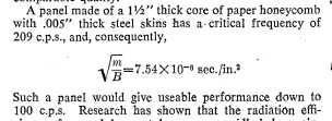

And an even thicker monster panel!
from here:
https://patentimages.storage.googleapis.com/d7/c4/c9/cbd405fcdd75ae/US3247925.pdf

My chladni experiments on glued strips also show increased activity at the seams so the joins in all the small pieces of balsa introduce internal reflecting boundaries which affect wave transfer across and through the panel depth.
Also, what if any is the result of the differences in sound velocity between the balsa core and the CF skins?
