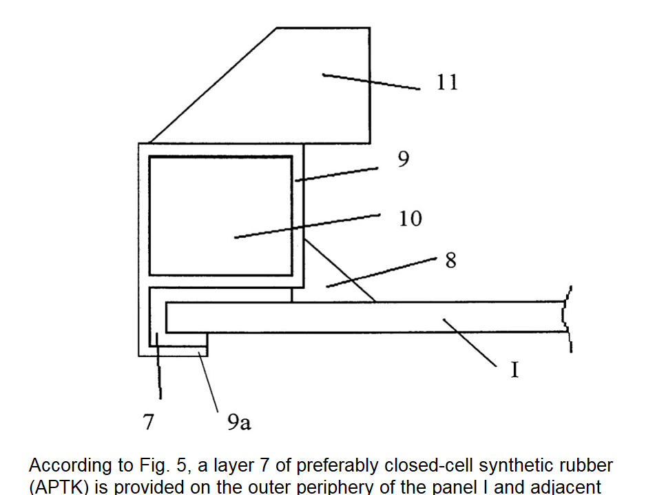

Thank you for your take on what that colouration on a DM panel. I suppose that's why Oliver Göbel blocked/tried to absorb those '"intrinsic waves" generated by te panels there aren't in the input signal,' by damping the edges. He used that damping in such a way to leave the panel edges somewhat open, that is, leaving the edges enclosed in synthetic rubber.A perfect HiFi transducer is supposed to deliver what you feed in. Unfortunately, the vibrations of the panels may introduce some "intrinsic waves" generated by the panels there aren't in the input signal. These "additional" vibrations change the harmonic distribution of frequencies giving "another color" or timbre to the reproduced audio signal.
@Sandasnickaren too had left the edges open to air, knowingly or unknowingly, as shown in his post #8,142.
