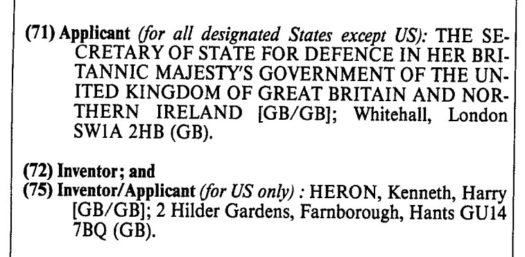

Ah, you found one of my all time favorites! This is the one I was referring to recently as being the "precursor" to the NXT patents, and in which the significance of low density is emphasized. It also recognizes the significance of the shear stiffness for the upper frequency limit, and of panel area for lower frequency limit.Might be the first patent on distributed mode.
Abstract
A panel-form loudspeaker has a resonant multi-mode radiator panel which is excited at frequencies above the fundamental frequency and the coincidence frequency of the panel to provide high radiation efficiency through multi-modal motions within the panel, in contrast to the pistonic motions required of conventional loudspeakers. The radiator panel is a skinned composite with a honeycomb or similar core and must be such that it has a ratio of bending stiffness to the third power of panel mass per unit area (in mks units) of at least 10 and preferably at least 100. An aluminium skinned, aluminium honeycomb cored composite can meet this more severe criterion easily.
But did you notice the panel details! It's a monster 40 mm thick aluminum honeycomb. It's about 1000 times stiffer than any modern DML panel as far as I know!
He thought it needed to be so thick and stiff that the coincidence frequency (fc) would be below the operating range of the panel. Later, Azima and NXT came along and realized that fc could (or even should) be much higher, perhaps even above (not below) the operating range of the panel.
So a lot has changed since Heron, but in my mind he is one of the grandfathers of the DML.
Eric
Not sure, if Heron was the inventor, or was just for the US patent. He might've been the head of the group, the manager/director.Ah, you found one of my all time favorites! This is the one I was referring to recently as being the "precursor" to the NXT patents, and in which the significance of low density is emphasized. It also recognizes the significance of the shear stiffness for the upper frequency limit, and of panel area for lower frequency limit.
Eric
I didn't read it that thoroughly, maybe tomorrow. Verity Group had bought the license from DERA. NXT was a company of Verity Group. Azima must've been either an employee of NXT or connected to it on contract.
