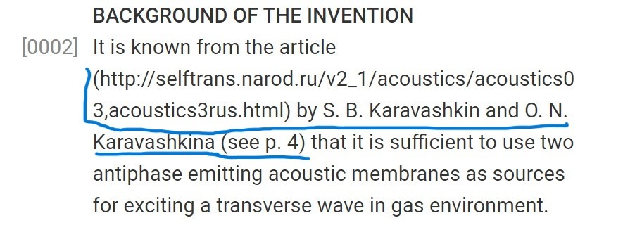

If you've tried to read that Karavashkin thesis, even with translation, it is Chinese to most of us. So, a question arises, how could a Swiss guy read that in Russian and actually understood that?Interesting. Thanks for pointing that out. When I said that the "transverse gas wave" concept was not mentioned in the Herger patent, I was referring to this one (filed 6/2020):
https://patents.google.com/patent/RU2743892C1/en
which still does not mention it as far as I can tell. But as you point out, indeed it is mentioned in this other one filed just two months later:
https://patents.google.com/patent/RU2744773C1/en
Curiously, the two patents describe pretty much the same exact features, but only the second one mentions the significance of the "Karavashkin transverse gas waves". Patent strategy can be confusion, but I have to wonder if they figured it would be unlikely to be granted in the US or Europe in the original form, but then somebody had the idea to toss in the Karavashkin "thesis". Regardless of how dubious the thesis is, they thought it might be worth a shot.

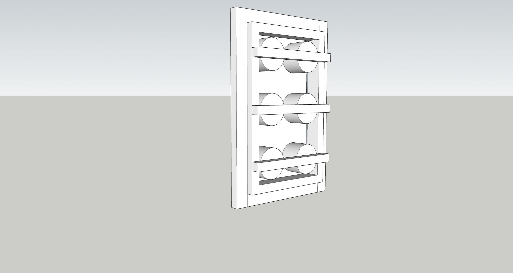

yes BL is 4.8. But, I’m using 6 exciters so its 28.8.

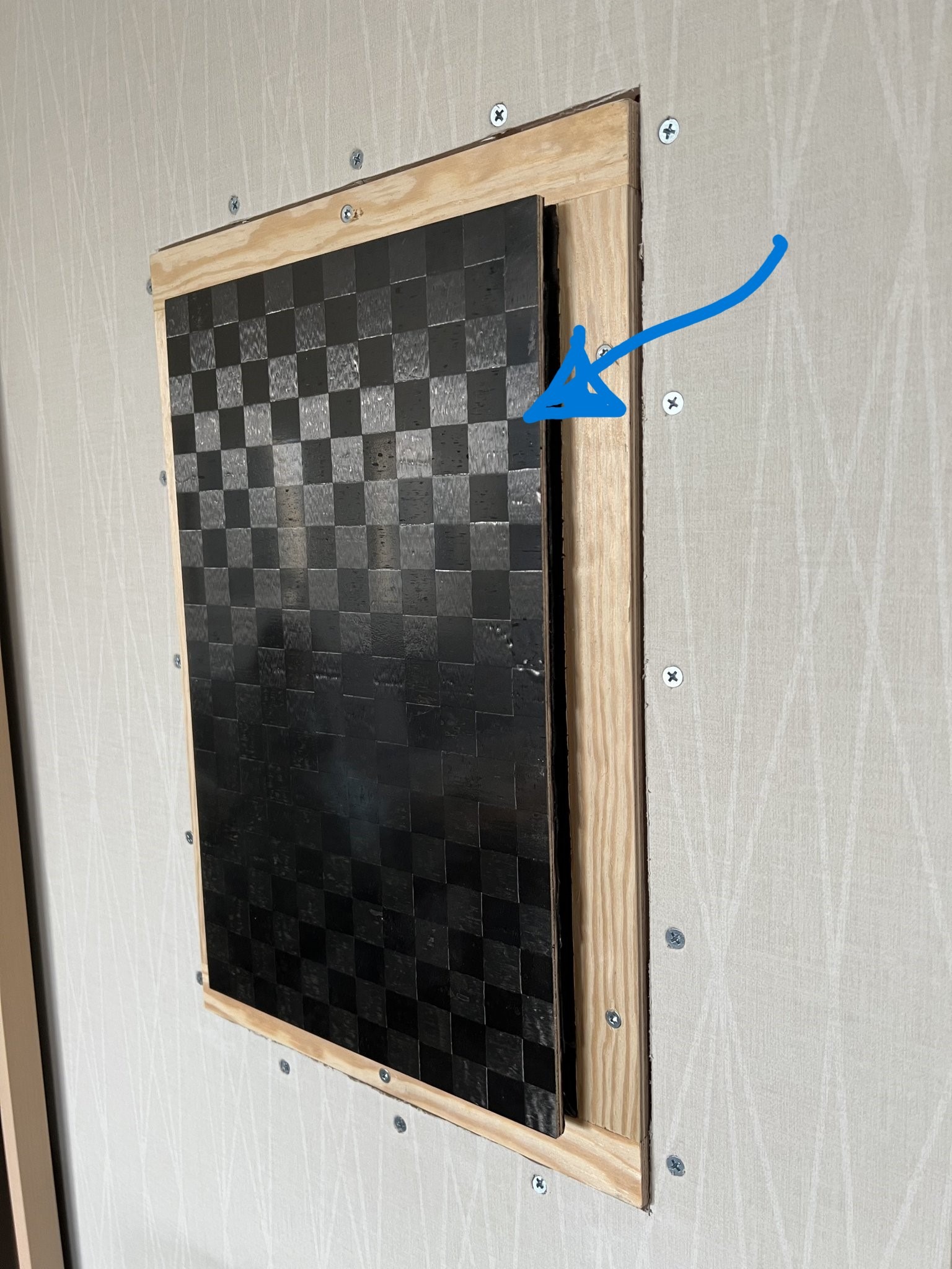

What's interesting is, the transverse waves made by 6 sources at the same time are fighting each other on the same plane and still gives nice output. At what distances, they are placed on the panel? Have you put a rubber puck inside the bobbin/coil-former under the exciter? Do you have the angled lines/cuts on the perimeter of the panel as Gobel's? If so, at what angles, at what distances?
You've left the edges free,
View attachment 1126974 Is it because it acts more like a BMR?

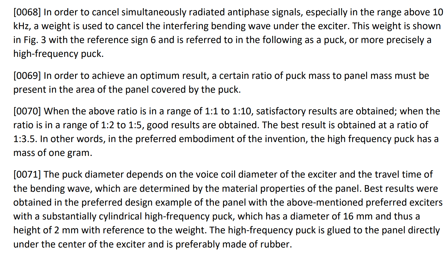

Thomas,a question on your question about a rubber puck. Is this what you thinking of?
https://patents.google.com/patent/CN201118973Y/en
It may or may not be the same thing, but I suspect he was thinking of this (below), which comes from an english translation of the Goebel patent. Since your (early) design was based on the Goebel patent, I suspect chdsl was wondering if you included this feature in your own version.
I will add that it's not actually clear to me what problem it is that this puck feature is intended to solve. If anyone thinks they can explain it, I'd be interested to hear it. I'd like to try it myself, but if I don't know what it is really supposed to do, I won't be able to judge if it works or not.
Eric
Maybe they are they saying that the panel under the exciter develops oil-can resonances at hf, which cancels the direct vibrations from outside the perimeter of the exciter at some high frequency. The puck may be designed to damp those inner resonances.Thomas,

In your 6 exciter panel, it is interesting how the surface bending waves fighting each other and still giving out pretty good sound.
I am using Henry Azima's terminology now -- bending waves of the surface of the material. You have used angled line cuts on your Gobel clone. Can you give the dimensions and angles and so on on that? Thanks.

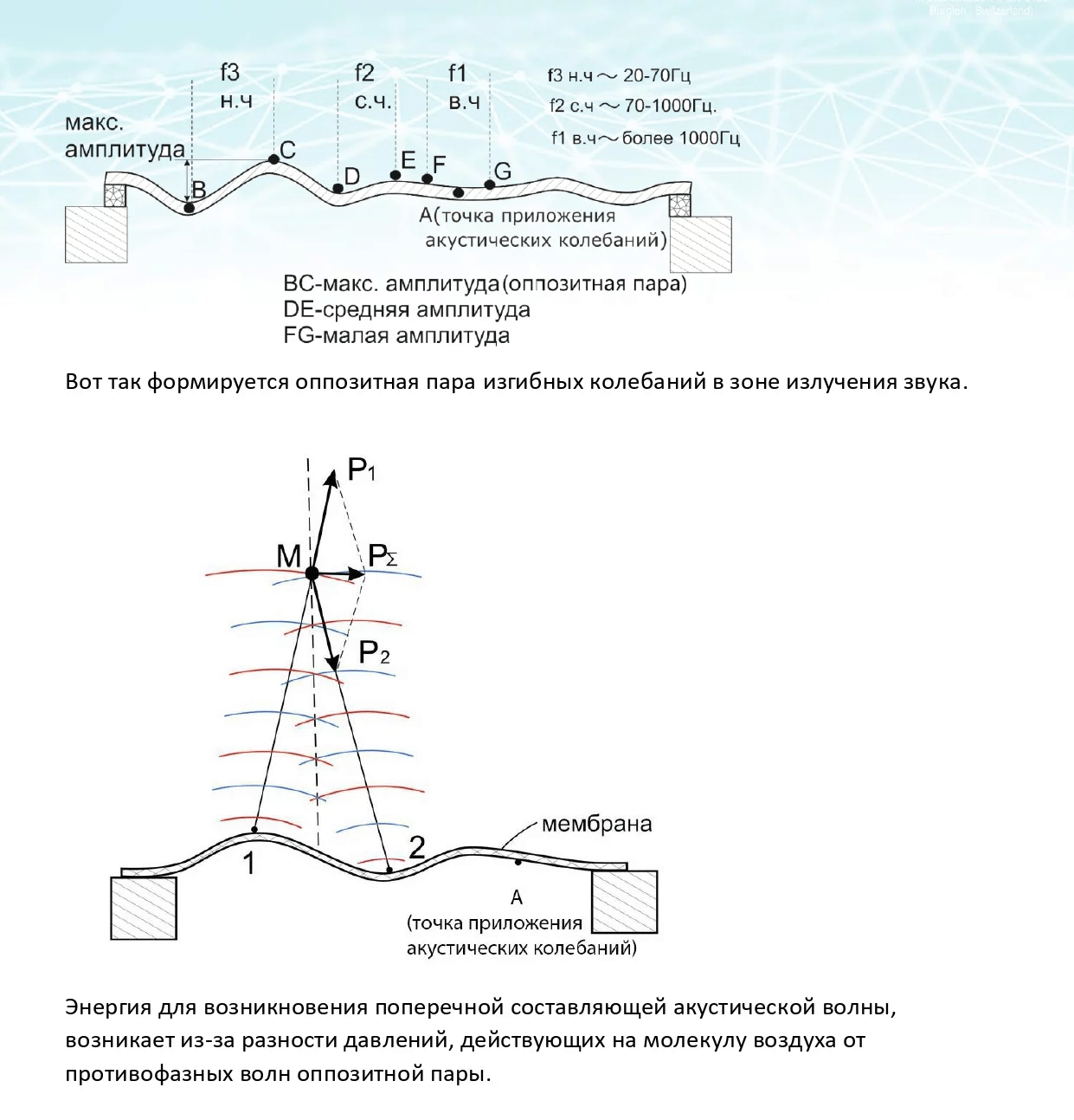

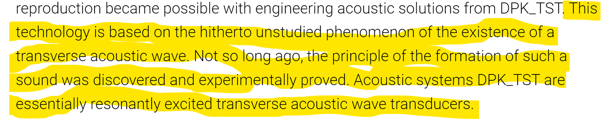

Wow, haha, you are right, DPK really does claim that:
I'm skeptical, I must admit.
I hate to risk going down this sketchy rabbit hole any farther, but my curiosity has the better of me. So can anybody translate this figure?
- the Karavashkin papers read like pseudoscience to me. And the SELF laboratory seems sketchy at least.
- I had the impression that the DPK speaker was based on the Herger patent. Is that correct? And if so, whey didn't it mention this hitherto unstudied phenomenon, if it's so basic to the function of this speaker?
Eric

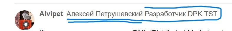

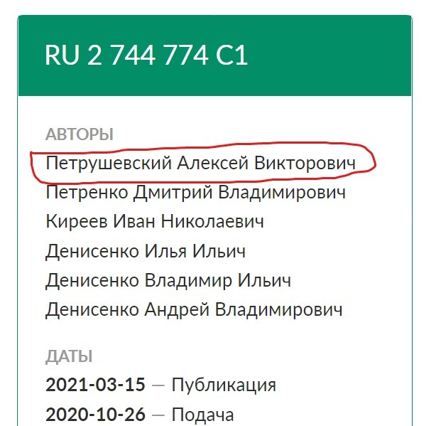

Maybe, this patent might give a hint who should be asked to give us some explanations on DPK_TST?
and,
Разработчик DPK TST >> Developer DPK TST
Its bit strange reading this reply #8,229 now.

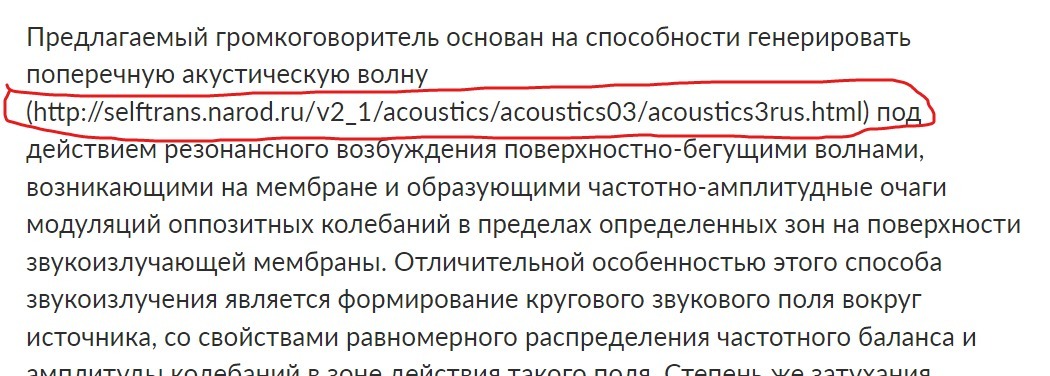

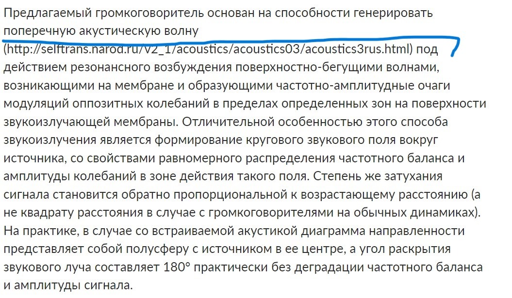

Further to post #8,270,
An excerpt from that patent,
and the Google auto-translation,
The proposed loudspeaker is based on the ability to generate a transverse acoustic wave (http://selftrans.narod.ru/v2_1/acoustics/acoustics03/acoustics3rus.html) under the action of resonant excitation by surface-traveling waves that arise on the membrane and form frequency-amplitude centers of opposing oscillations within certain zones on the surface of the sound-emitting membrane. A distinctive feature of this method of sound emission is the formation of a circular sound field around the source, with the properties of a uniform distribution of the frequency balance and amplitude of oscillations in the area of such a field. The degree of signal attenuation becomes inversely proportional to increasing distance (rather than the square of the distance in the case of loudspeakers on conventional speakers). In practice, in the case of built-in acoustics, the radiation pattern is a hemisphere with a source in its center, and the opening angle of the sound beam is 180° with virtually no degradation of the frequency balance and signal amplitude.
From Danilo Herger patent,
Over the years I have posted on many occasions the problems within the coil surface area and how to deal with them on different panel materials.Thomas,
Eric
This is the same problem, and this is his way of dealing with them on his panels.
Steve.

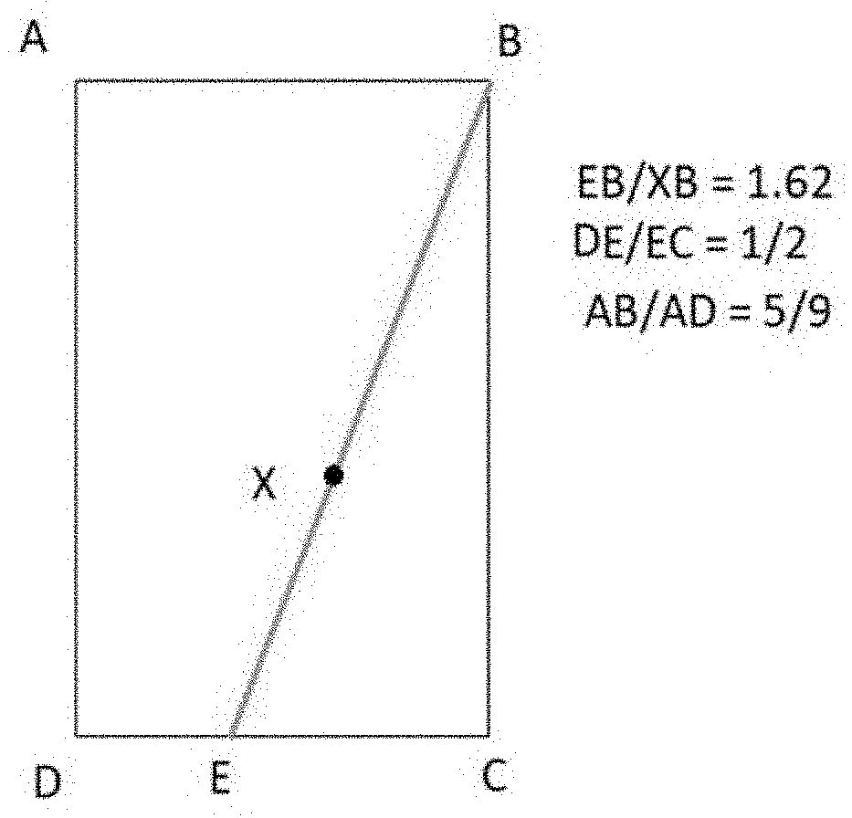

I could not figure out from these patents, the lines BD and BE , which is the preferred line or do you have exciters in both positions?Further to post #8,271,

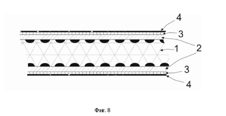

These images are exactly same in both patents,
and this with another Herger patent,
You might find other similarities, reading those patents, with a translator.
Or do you remove the one from X when using the red line ?

If you read my post #8,270, you'd know who to ask that question.I could not figure out from these patents, the lines BD and BE , which is the preferred line or do you have exciters in both positions?
It is as clear as mud.
Steve.
It is quite funny the Petrushevski+5 patents match the Danilo Herger patents. Some of the sentences appear to be equal, as though they come from the same computer, the way they are written. And, the images are exactly same.

Can you clarify what you believe you now understand but previously didn't? Are you talking about this transverse gas wave concept, or something else?
I do agree that two exciters out of phase would create bending moments, that would be different and perhaps stronger for at least some frequencies than a single exciter. But neither of the Herger patents specify that two exciters are necessary, let alone that when two are used they are run out of phase.
When they talk about "antiphase" components, I read it as referring to this type of thing, which happens in a DML regardless of how many exciters there are:
Are you thinking something different?
Eric
I think you are right, it was me over thinking, because of the vagueness of the patents.
I started thinking of piezoelectric drivers bending the panel with no pistonic motion.
Then started to think how two exiters could mimic the piezoelectric plate.
