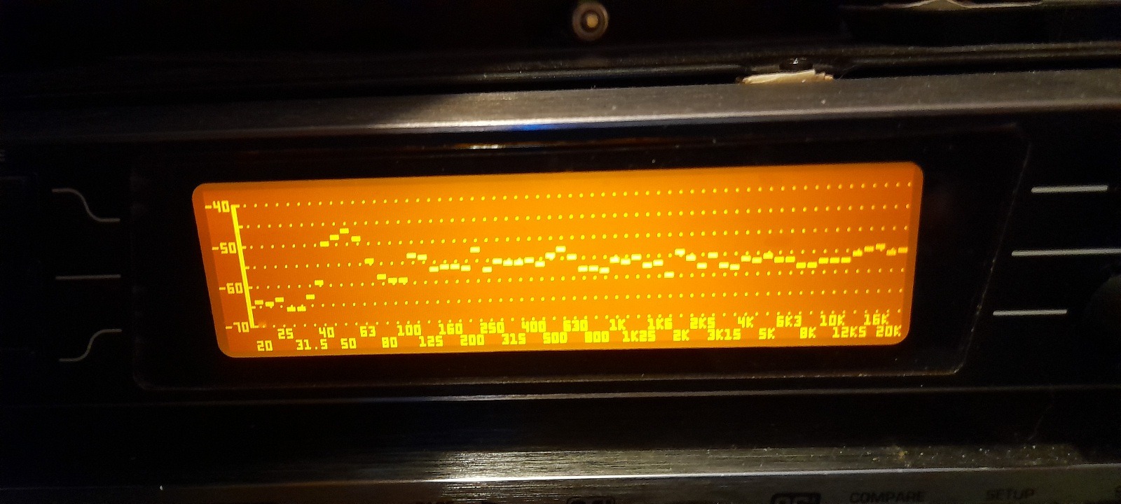

I know I have posted the response of the 6mm panel before showing the hump below 100hz and the excellent response above up to and beyond 20k.
I was just holding the microphone at about half a metre in front of the panel.
Not bad for a 2ft panel with an exciter glued on and nothing else done to it.
Easy peasy.
Steve.

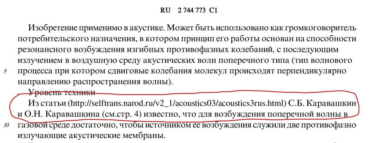

Wow, haha, you are right, DPK really does claim that:
I'm skeptical, I must admit.
  • the Karavashkin papers read like pseudoscience to me. And the SELF laboratory seems sketchy at least.
  • I had the impression that the DPK speaker was based on the Herger patent. Is that correct? And if so, whey didn't it mention this hitherto unstudied phenomenon, if it's so basic to the function of this speaker?
I hate to risk going down this sketchy rabbit hole any farther, but my curiosity has the better of me. So can anybody translate this figure?
Eric
Well, Danilo Herger uses that sketch in his patent. He actually mentions Karavashkin "thesis" in his patent,
The "thesis" that was missing in the internet, but the working link was given to us by @Alvipet in this post #8,175. Maybe, he'd know the answer to your question. If you revisit the post #8,192 and watch the video, you might decide to ask or not.
Interesting. Thanks for pointing that out. When I said that the "transverse gas wave" concept was not mentioned in the Herger patent, I was referring to this one (filed 6/2020):
https://patents.google.com/patent/RU2743892C1/en
which still does not mention it as far as I can tell. But as you point out, indeed it is mentioned in this other one filed just two months later:
https://patents.google.com/patent/RU2744773C1/en
Curiously, the two patents describe pretty much the same exact features, but only the second one mentions the significance of the "Karavashkin transverse gas waves". Patent strategy can be confusion, but I have to wonder if they figured it would be unlikely to be granted in the US or Europe in the original form, but then somebody had the idea to toss in the Karavashkin "thesis". Regardless of how dubious the thesis is, they thought it might be worth a shot.
Eric

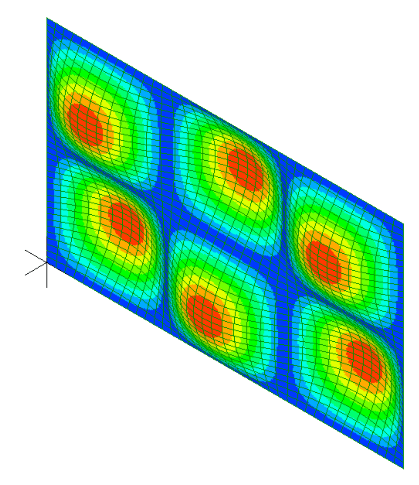

When they talk about "antiphase" components, I read it as referring to this type of thing, which happens in a DML regardless of how many exciters there are:
Are you thinking something different?
