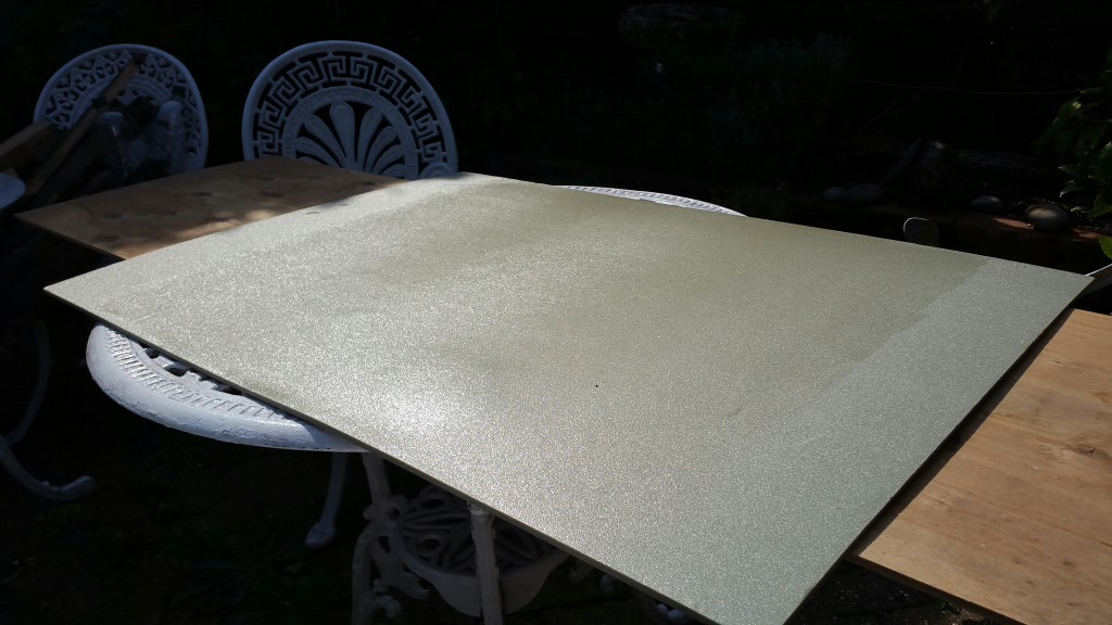

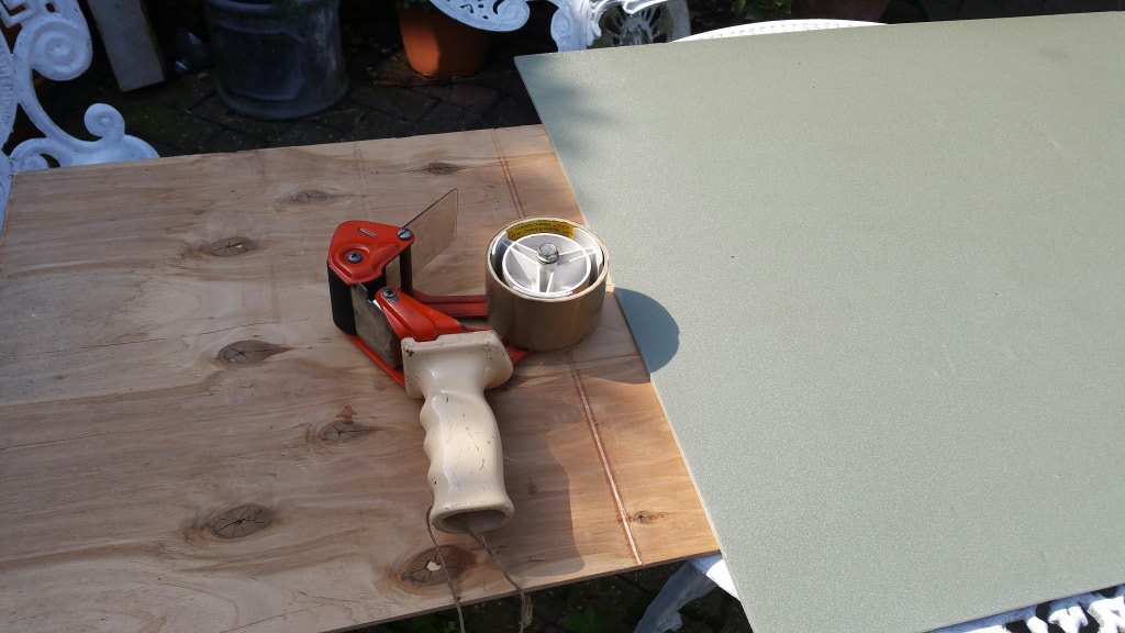

Thanks stratoton.
I've already coated the panel as you can see in the photo's.
The first pic is the coating using the roller.
I could not find my small roller but came across this tape gun, which worked very well.
The coat is much smoother and thinner ,which I hope you can see in the photo, I've left the last couple of inches at the top and bottom as I did not want to over stretch the epoxy.
One thing I did notice is that the epoxy is still very flexible? Very similar to pva ,I was hoping for more rigidity ,something like cascamite but without the cracking.
Have I the wrong epoxy ?
Steve.
