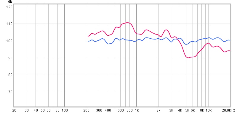

I think the flat response with no EQ is going to be tough. The way I see it, something like an ADAU1701 is dirt cheap, so if you're going to go through the trouble of measuring the speakers you might as well tune them. ESPECIALLY for critical listening like audio editing. I think you will be very satisfied with these panels after you tune them though.
Plus even if you get a nice plug and play DSP I think you will be in for less money than an equivalent set of traditional monitors. So I would personally let go of the no DSP thing... it doesn't seem like a productive restriction.

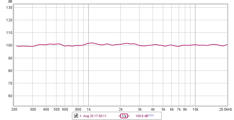

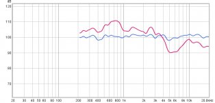

I can't and will not use any active eq to flatten the panel curve. So if there is some material what would work better with no eq, please do tell.
I didn't address this bit. I agree with cheapvega re. not ruling out EQ. I have experimented in the past with 'simple' designs that minimise crossover components in order to achieve a 'purer' result. All have been unsatisfactory in one way or another. Even the EPOS EP12 with no XO components on the bass/mid unit can be improved with a superior crossover.
GR Research have also commented that with respect to an ATC speaker they were modding and which is often used in studio monitoring. The top end response was a bit droopy. But if you monitor and mix the sound as played through unmodded speakers, the result will be over-bright.
If I was using a system for monitoring, I'd be wanting as flat a frequency response as possible at my listening position. This almost certainly will require a calibrated measuring mic together with either active EQ (e.g. using a miniDSP or something similar) or with passive components.
Attached is a plot showing before and after EQ. No need to say which is which! Without measuring how can one ever know where some of the key issues are? The second plot shows what can be achieved with appropriate EQ. This was for a 35 x 40cm experimental medium density EPS panel. Obviously, it's best to get as good a response as possible without any EQ.
