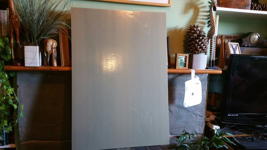

UHD EPS has arrived. Canvas panels arrived yesterday. Final local league cricket match of the season on Saturday with yours truly behind the camera. Unfortunately timed photography road trip next week. Just when you get back full-on into hifi mode, other hobbies get in the way. Could be worse - I might not be retired...

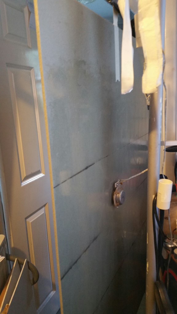

Some pictures of what I am playing around with at the moment.
The first picture on the left is the second epoxied panel drying next to my surround sound panel.
The quite thick coating uses about 20g per side,the first panel had a messy 20g one side and a smooth 10g on the other side.

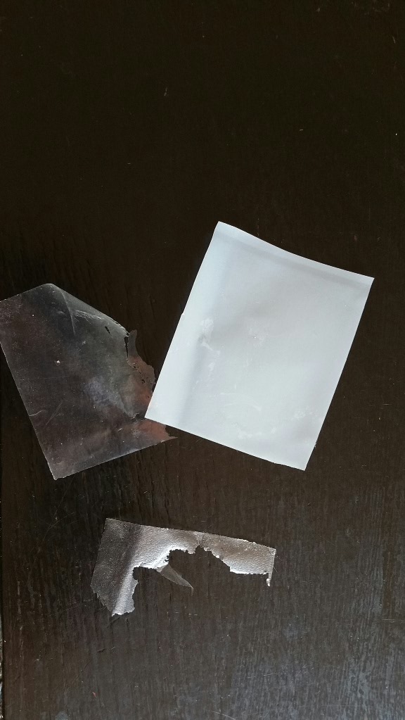

The second picture is of the thin epoxy that peeled off of the pp that I used to mix the epoxy.
At first I could not tell the difference between the epoxy and the pva, but where the pva would stretch when pulled apart, the epoxy just breaks .

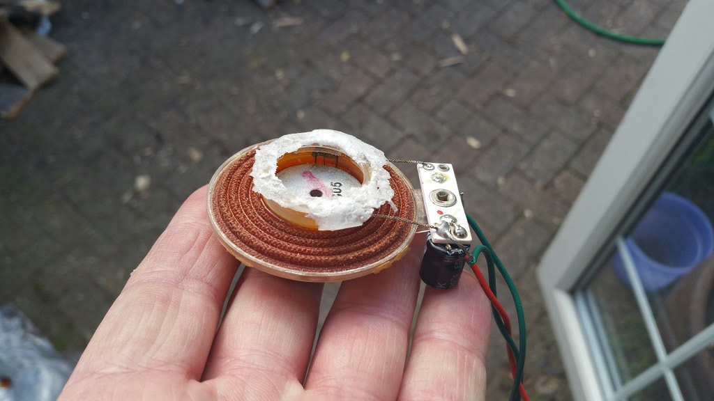

Picture three is the exciter that I have just cut off of an eps panel.
the fourth picture is the first messy panel in position showing that I have the exciter glued on with pva on the thicker messy side.
Having to wait a day for each side to dry is a pain , as my new boss (I'm retired too) always seems to have new jobs for me to do ,so I loose another day🙄

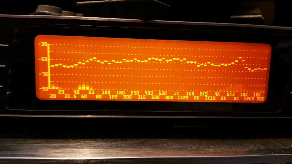

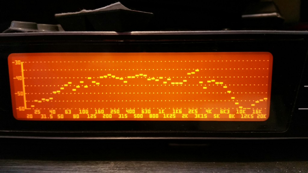

The first picture on the left shows my old friend spike at about 9k this time.
This is a problem I have mentioned many times, but this one is quite bad.
This was measured at about 6 inches distance,

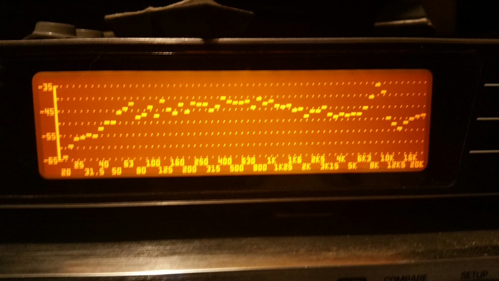

The second picture is from the exciter side, again from 6 inches from the exciter .
You will notice that the 9k spike has reduced greatly but a spike has now apeared at 3k .
I believe this is a combination of the distortions in the exciter coil area (not voice coil resonance )and the cavity resonance.
I saw this the first time I hooked up the first panel and thought I'd see if I could fix it as usual on the second panel, the only problem was I forgot 🙄
It would have been so much easier if I'd made the alterations before I aplied the epoxy 😱
I haven't noticed any nasty sounds over the last few days ,but I've been playing some Tom waits and am now getting some earache.
I know what you are thinking, that's just ,Tom waits, 😀
The panel starts getting that hardness I talk about ,it can be quite painful.
You will also notice the response from the back of this panel rolls off after 3k to 4k.
The panel surfaces have different responses above 3k .
I think I should be able to improve the front surface response but the rear surface will probably stay the same.
A lot of the hf is blocked by the exciter itself plus phasing issues.
We shall see.
Steve.

With the Amina exciter you could remove the flat plate and bolt the exciter directly to both sides of the panel.
This should remove the spikes ? If they exist ?
But this would give both surfaces, front and back ,good contact with the exciter.
On hard panels such as ply ,you would not need a bracing support.
Of course the bolt is mounted in the centre of the exciter spider,so what effect this might have I don't know,but if this is a problem,it would be there anyway ?
Just an idea if anyone wants to experiment.
Steve.

The weight of the uncoated xps panel is 82g and with the epoxy coating it is 122g.
Depending on how this goes I might try the thinner 10g per side similar to the front side of the first messy epoxy panel .
Making the panel 102g might change things a little?
The new epoxy panel is still sounding quite dead compared to the messy panel, it takes a long time to cure🙄
I'm still going to hook it up to day and see how it sounds.
The wife is out for most of the day , so freedom calls😀

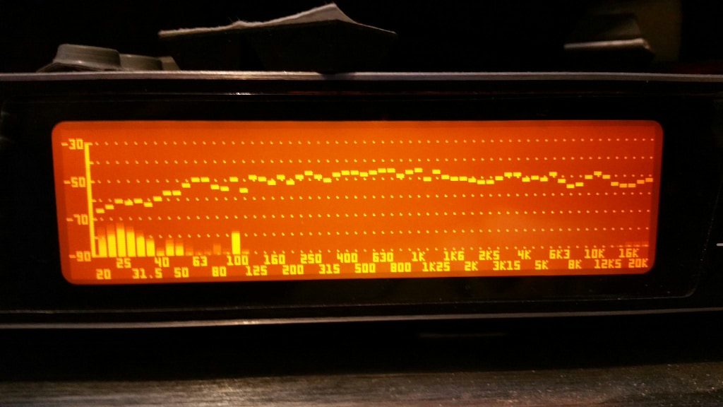

9k spike and 2.5k spike
The quick way to sort out the spike caused by the coil surface area is to place a dot of blutack in the centre, but this wasn't enough, so I made a x there instead and this did a better job ,but still not totally cleared.
The second picture is without the x .(I somehow lost my pictures and had to upload them again,but got them in the wrong order) 😡
The first picture is with the x.
Notice how the response above 10k has improved.
There is a lot of cancellation that can go on there.

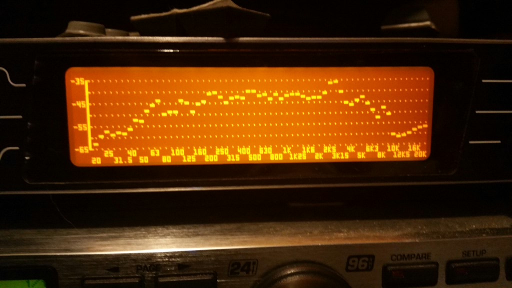

The third picture is from behind the exciter (all measurements done at 6inches) but done with 10db plot to match previous plots.
The 2.5k spike is still there but has changed slightly, this is coming from the hole in the rear of the exciter and the exciter in general.
If I place my hand over the exciter these frequencies drop away.
If I cup my hand around the exciter the noise gets very loud.
The fourth picture is the very thin x in the exciter ring area obviously I could make this thicker but don't want to damp it too much.
Steve.

Our kitchen scales are iffy: One panel, trimmed and rounded came in at around 75g. Two identical panels together came in at 170g. I believe the latter weight to be more accurate. So, make that 85g for a 565x400mm 10mm UHG EPS panel before PVA treatment (about 1/3 the weight of my 3mm poplar ply panels - same dimensions except 3mm thick).
I'm feeling optimistic!
Simon
Also, thinking about it a little more, regardless of EPS grade, sanding is going to be removing the skin that's created by the hot wire cutting process (or extruding in the case of XPS). The skin is going to be covering for the most part the very small polystyrene spheres which, when the skin is removed, will present a rather spongy texture as one would expect - hence the soft feel. I would suggest, therefore, that the diluted PVA treatment is essential to reseal the surface even for UHD grade EPS.
The first side is still damp in places even after four hours drying time. The second will have to wait until tomorrow.
