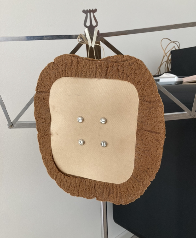

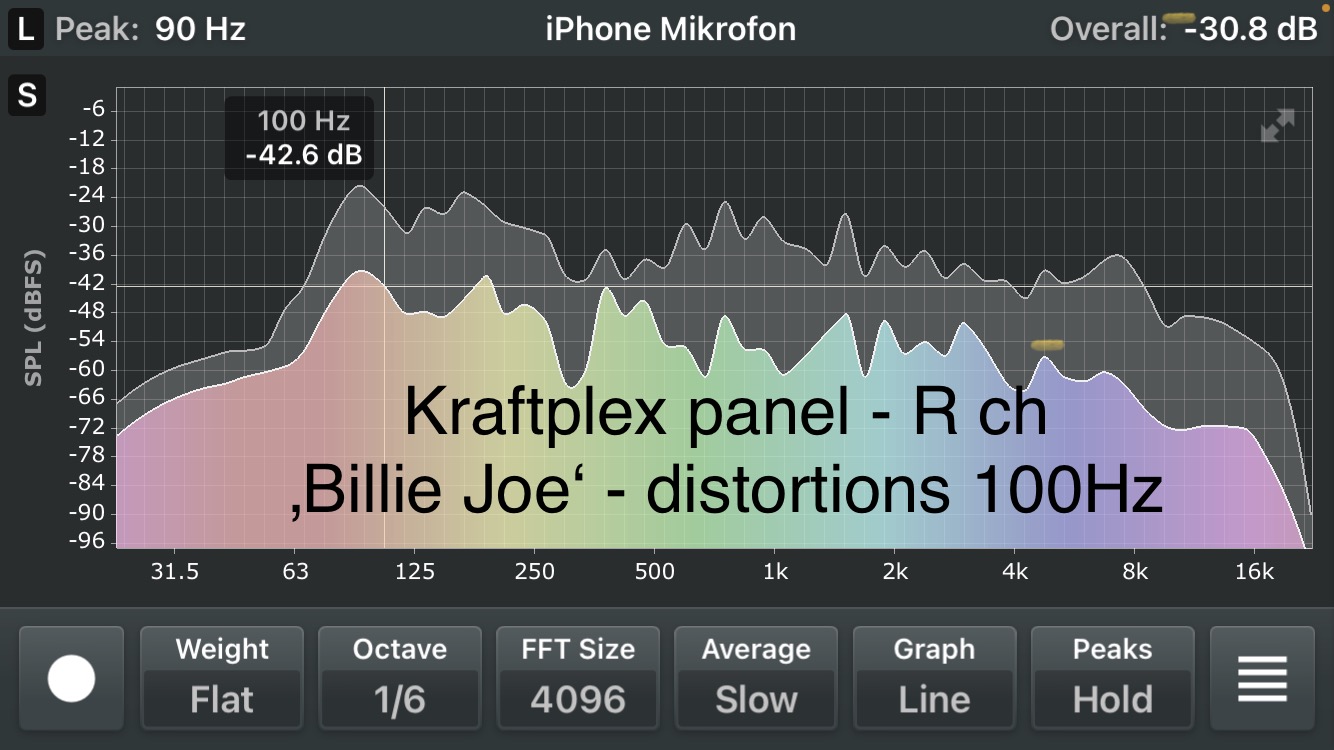

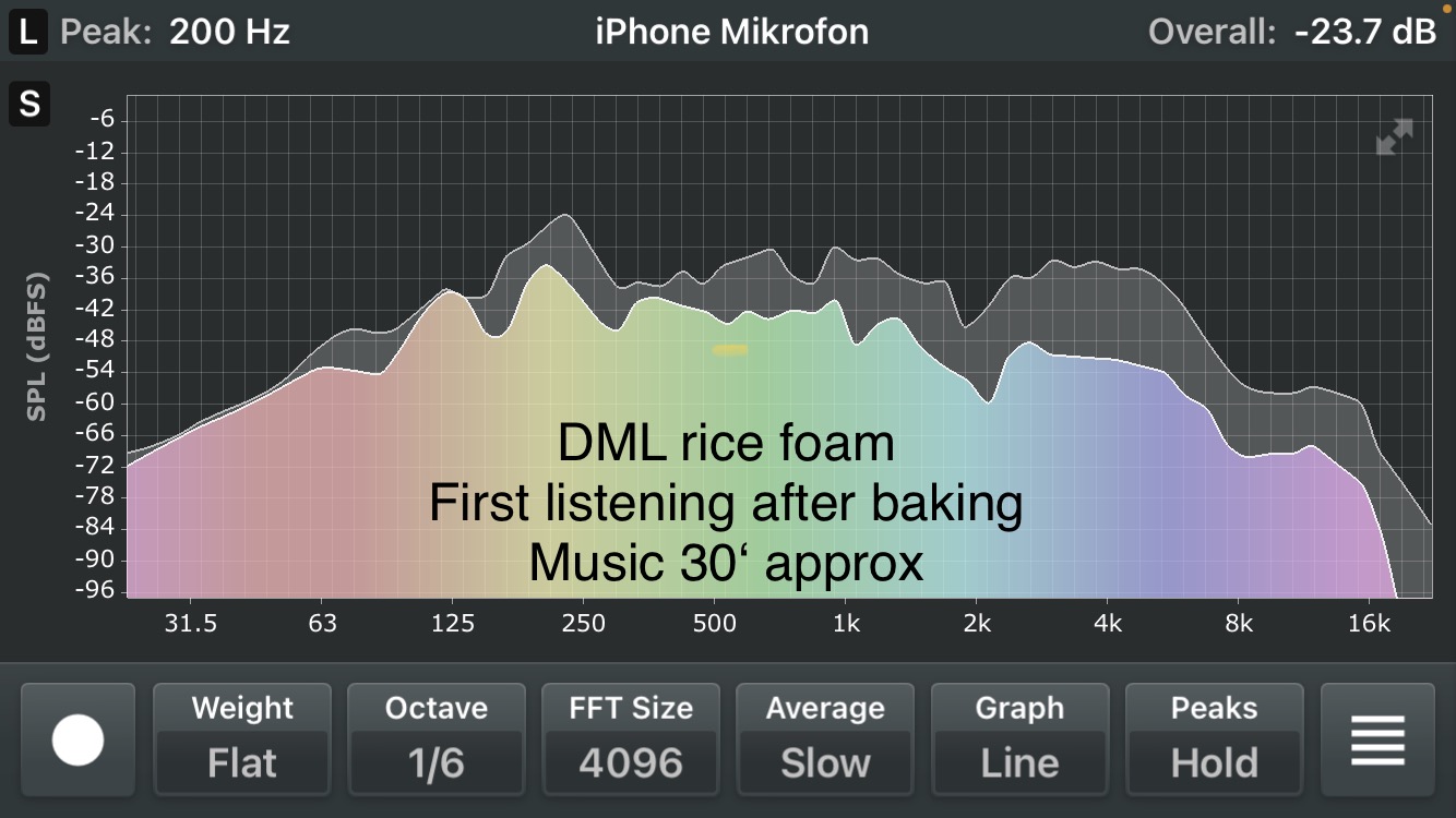

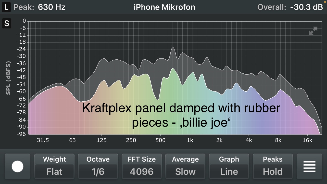

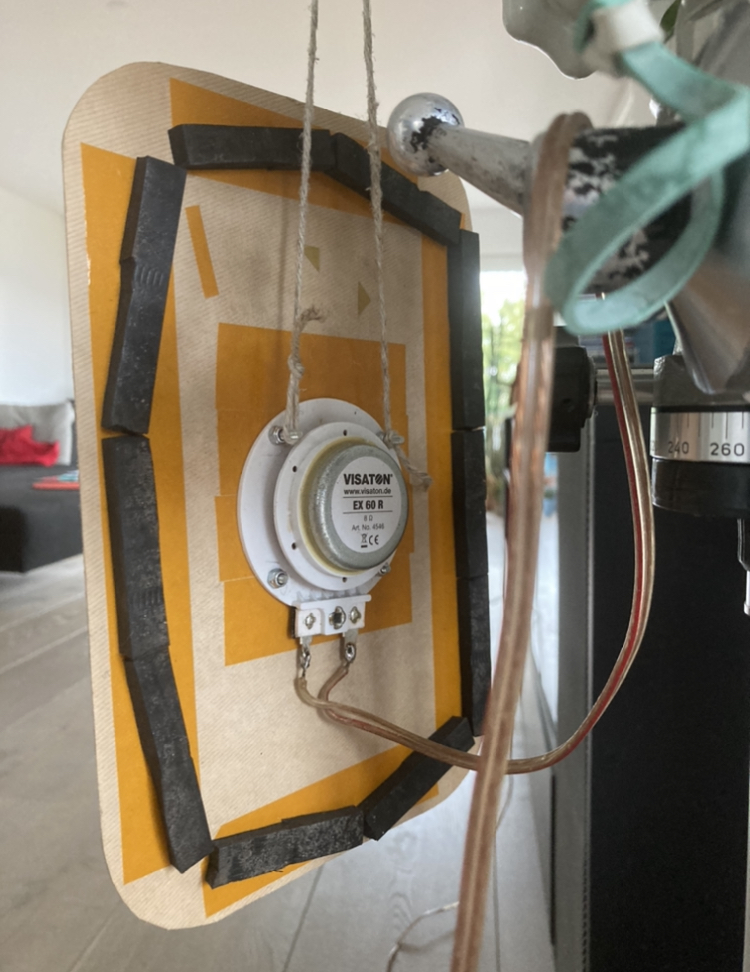

Hello carlmart
My goal is to use renewable material and a frequency range from 50Hz to 15 kHz.
After a pause in experimenting with DML (cardboard, honeycomb cardboard and kraftplex), I started again with kraftplex in the size of Steeve's veneer panel. One panel is damped at the surrounding with a rice foam cake (baked in the oven) to achieve some damping. The result so far does not meet my expectations in tonal balance (body). When it came out from the oven, I experienced a very fine tonal balance at the first listening. Next day it lost most of the body and adding some water didn't helped. The other panel (kraftplex) I'm working now will get some heavy rubber at the surrounding to achieve damping. There may be also other ways for damping small panels, like mounting in a canvas frame a.o.
About your idea to work with pcb-boards, please give it a try. Earlier in this thread some colleagues worked with Perspex and achieved fine results
Eric.

The sound with the Kraftplex panel without any ‚cure‘ is far from natural, is distorted in lower bass region at higher volumes. When I listened to my rise foam ‚cured panel‘ coming fresh from the oven, some of these issues weren’t present at moderate volume. Now I‘ve cured it with some heavy rubber near the edges. It sounds good, similar to the rise foam type at it’s best state😉 Need some more time to check out the things and will publish measurements and recordings.
Eric

some photos about the things so far:
- Kraftplex panel with rice foam cake, front view (size of board is not 6to9)
- music graph* 'fresh from the oven'
- music graph* Kraftplex panel without cure (at 100 Hz the peak shows the distortions)
- Kraftplex panel with rubber damping, rear view
- music graph* with rubber damping cure

Eric
