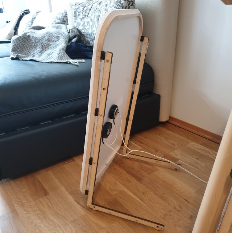

I'm surprised I haven't seen many polyurethane foam core builds. Coming from an architectural background, I found it natural to experiment with KAPA boards, and these are made of polyurethane foam, they come with and without sheets of paper film on each side. The material is able to absorb shock and recover its shape quickly, lightweight, though stiff. As far as I know, stiffer than polystyrene. The only downside is that they are a bit expensive compared to XPS or EPS boards.
My DML speakers consist of two 420mm x 700mm x 10mm sheets of KAPA, on the backside I've added a 10mm balsa frame, this improved lower frequencies a bit. As for exciters I have a Dayton Audio DAEX32U-4 and DAEX32EP-4 in series on each panel. They sound so amazing, mids and highs are perfect in my opinion. I recently added a small 3" sub to the setup, which I have close to my desktop, this was the cherry on top. I'm just perplexed by how good they sound.
I would consider much bigger panels in the future, this would presumably give a much better lower frequency response. The same ratio, but 630mm x 1050mm, maybe even larger. And though I like having the speakers standing on the floor, I should probably hang them. With the current legs, they just start dancing around on the floor at high volume, lol.

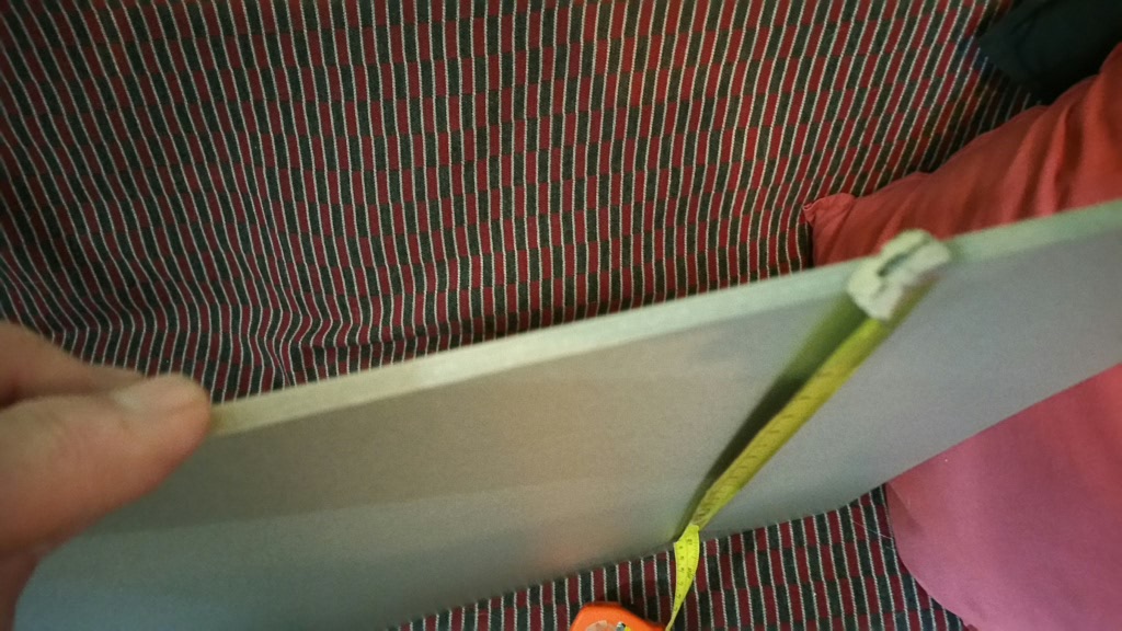

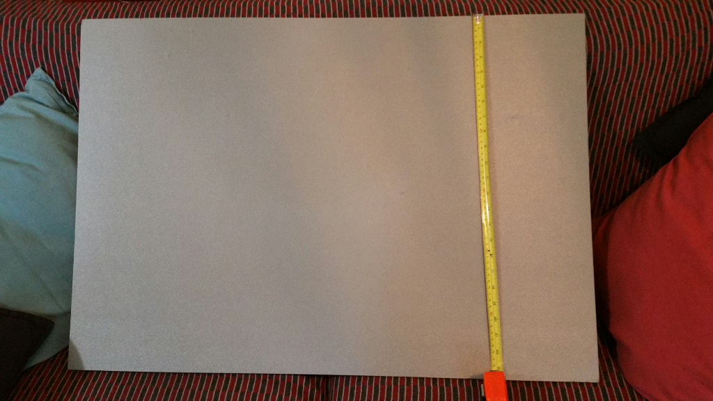

I've found the 5mm xps in the loft.
It is 60cm x86cm .
I think I will only coat around the exciter area first , maybe going all the way across ?
I think zenker mentioned something about this, which I thought was interesting?
Basically I'm just going to mix some epoxy and see how far it stretches?
As thin a coat as possible.
I'll have to do one side at a time, trying not to make a mess 😱
Steve.

Very neat construction! How did you do the curved corners, and how are they attached to the sides? I looked at a polyurethane product, seems to be very highly damped, and the product I saw was too thick. It did occur to me that it might be worthwhile to try a free-form speaker with extra-wide kitchen foil and expanding PU foam in a can. You would have to build a mould to support it initially, but I think it would work. You could play with variable thickness, extra long panels, insetting a stiffer window for the exciter for better hf etc.
Thanks, I really like them too 😀 I assume your question about the curved corners is referring to the balsa frame? What I did was I just cut them out of a 10mm thick sheet of balsa that was wide enough to cover the corner. the balsa is glued directly onto the board with wood glue, while the legs (laser cut 8mm plywood) are attached to the balsa at four points on each side with pieces of eps foam, they are quite loose though, but at least they stand. On the other speaker I just used 3mm thick double sided foam tape. Moulding seems interesting, creates lots of possibilities for sure.

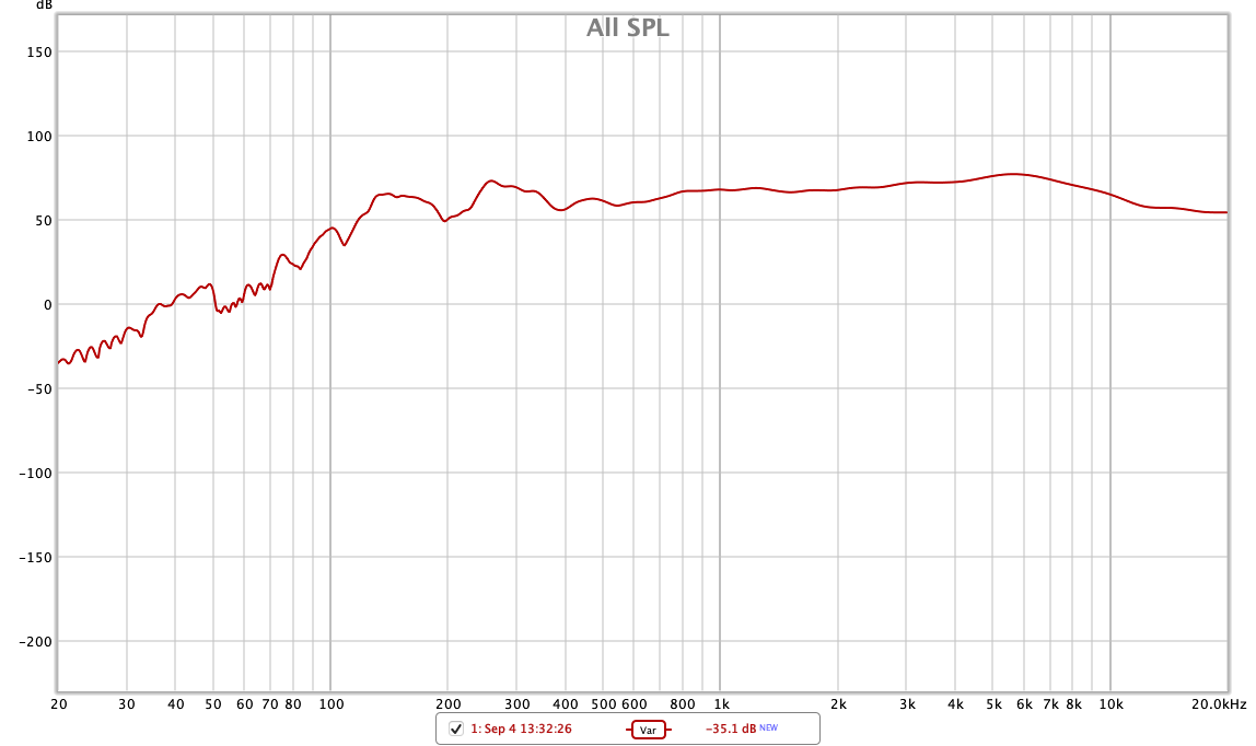

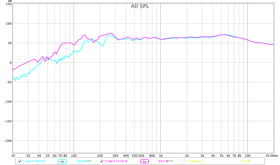

I'm not really sure how heavy the highs are damped. I would say the highs sound pretty good to me. I would assume the material performs differently on different frequencies, no? Maybe the dampening effect is more affecting lower frequencies? I did a measurement (don't have a particularly good mic, so take it with a grain of salt) there is indeed some dampening/reduction in dB between 5kHz and 20kHz. but I'm not sure how much the material is responsible for this, both of my drivers does have this property on the manufacturer's data sheets, the DAEX32EP-4 Thruster is better at mids than the DAEX32U-4 Ultra though.
The cyan is the DML speakers only, while magenta includes my tiny sub. The red is with the paper removed from the front side, seems like it did improve the performance overall, did smooth the response at around 1kHz, but there's a dip at 55Hz.
I would love to try some other material too though, been a while since I've read through this thread, but I'm particularly interested in trying out wood. Balsa end grain seems hard to get by and expensive. But maybe it's a bit more affordable if I produce them myself. I'm imagining a thin veneer sandwich with balsa core. Wondering also if it would be worth testing sheets of balsa that are not endgrain.

I'm afraid it hasn't gone to plan as usual,I made the coating too thick,so have tried to drag it across the panel,should have used a roller!
If I had spread the epoxy thinly with the scraper in the beginning when it was more pliable it would maybe have been better?
Well it's all part of the learning process😀
Steve.
