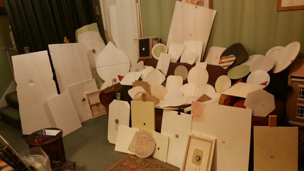

I'm trying to clear out some of the old panels in my room.
These are test panels and are mostly not needed any more,so it's the tip for most of them.
These are the ones I can get to in my room at the moment, there are more behind the curtains and under the stairs and dotted around the house and loft.
It's time to sort out my room for listening to music and not as a work room.
Fun as it has been , it's time for me to relax and enjoy the music.
Steve.

Some Tectonic exciters arrived just before I came away for a few days break, so I will be cracking on in a few days time.
Simon.
