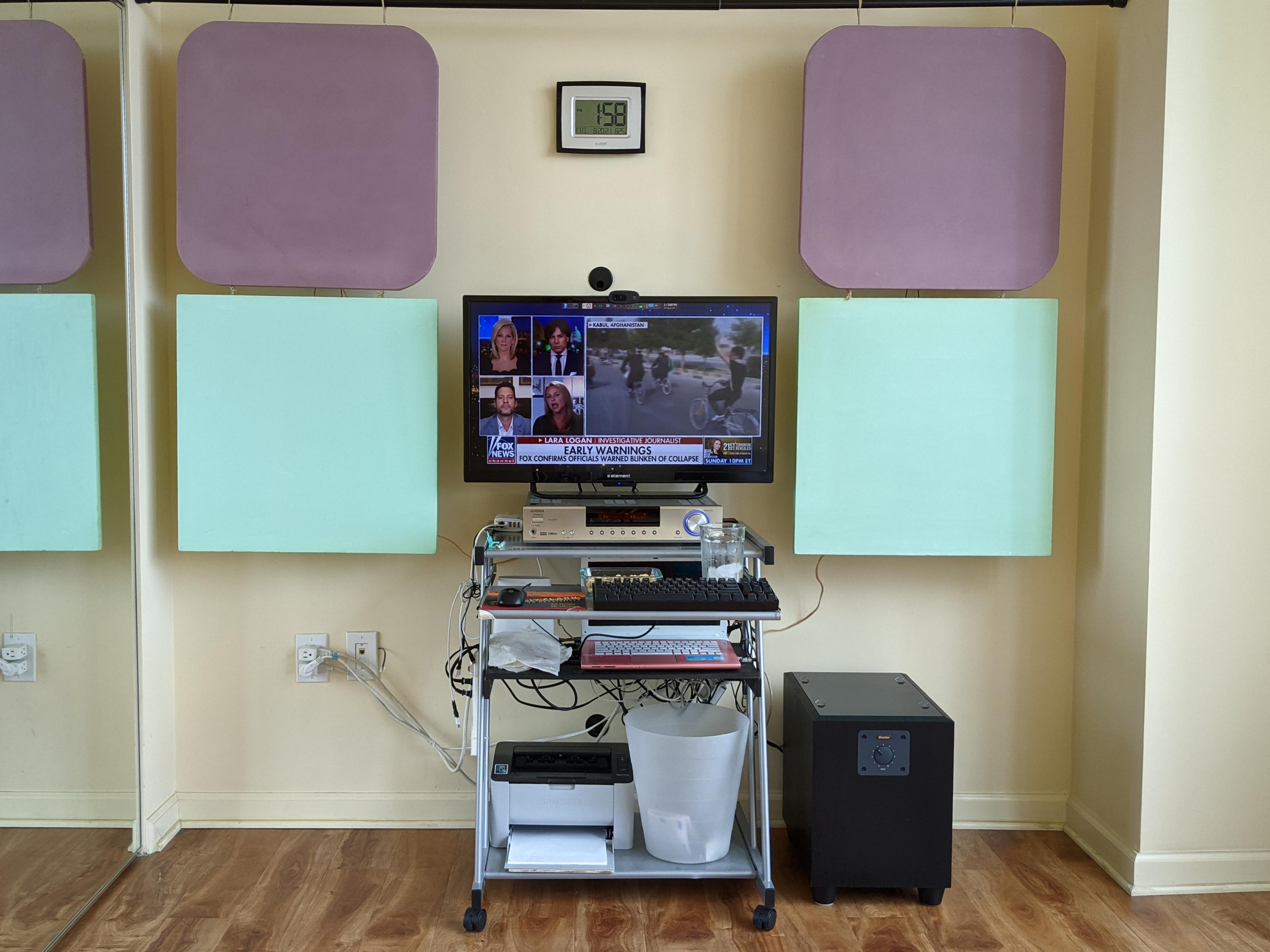

Along the lines of the stretched canvas builds: has anyone tried attaching an exciter to heat shrink plastic over a frame?
Top Flite MonoKote Neon Orange 6''' | Tower Hobbies
