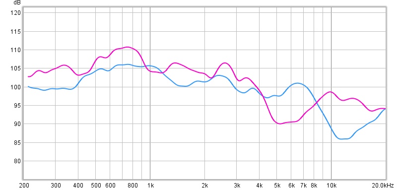

The plot thickens. The attached shows the difference between the 396mm x 565mm panel (pink) and a cut down 396mm x 350mm panel, measured from about the same distance - 30cm or so. The small panel sees the large 15db trough moved out to 12khz or so. I've also tried to use as little double sided sticky stuff as possible. The smaller panel looks easier to EQ.
What I will say though is that having the panel flapping about as it's merely attached to the exciter and nothing else is a little disconcerting.

lordtarquin.
im getting a little confused now ,the plot at 2inches is showing a drop from just below 2k to just below 8k of about 25db ?

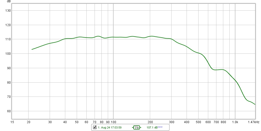

I don't pretend to understand what's going on either. I just know that the system was sounding very good indeed before I blew up an exciter. That was with the 3mm poplar ply panels. There's no way I could get the ply panels reaching 20khz, hence playing with EPS ones. With EQ, they reach 20khz easily.
The smaller panels seem like they are going to work well and be a good fit for my redesigned winged OB speakers. With some EQ, these are flat - near field - from 40hz until I roll them off. They are only 4db down at 30hz. However, one I move the mic to the listening position, I get all sorts of suckouts. Some room treatment may be needed after all...

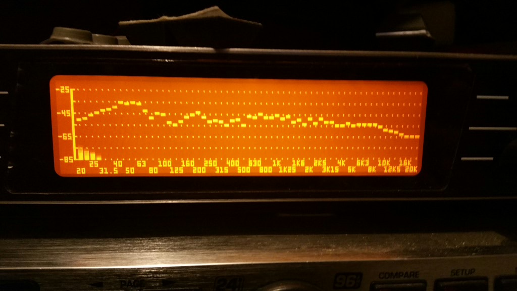

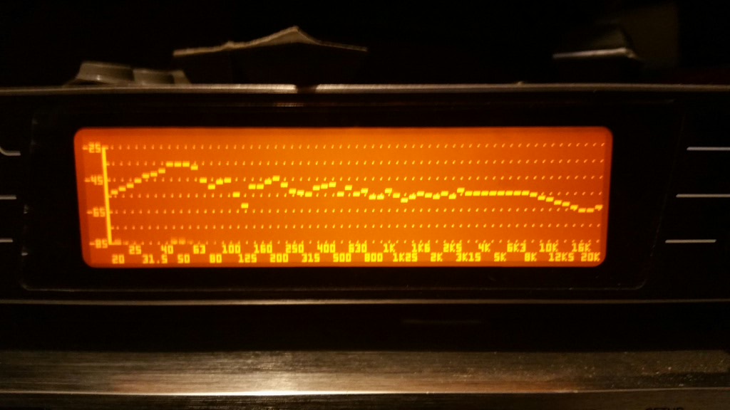

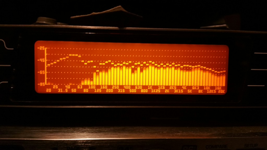

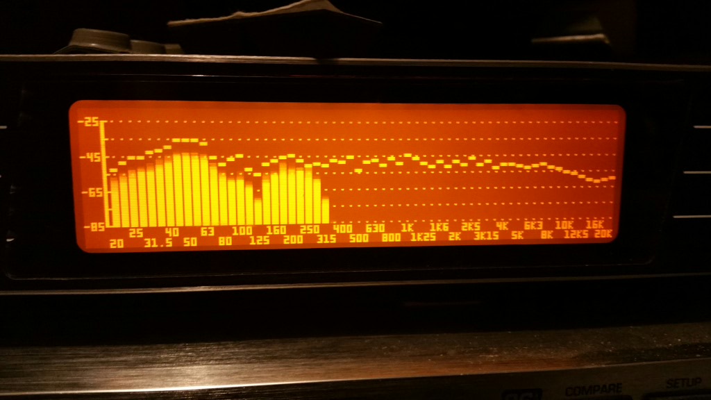

I just mounted two old test panels one was a 16 inch square vh grade panel until I re shaped it,coated in vinyl silk.
The other is about 23inche's by 16inches low grade eps coated in tissue .
All measurements done from 3 metres distance.
The first picture is the low grade eps panel only with tls.
The second is the vh grade eps only with tls.
The third is both running with the tls turned off.
The fourth is the tls with the eps panels turned off.
This audiocircle link is the same 40cm square vh grade panel with just the pva coating ,which I measured way back , can't remember when , notice the high frequency continues on up to 20k with only a small dip.
this is 40cm 10mm thick panel response after mods
NO EQ USED.
Steve.

Lordtarquin.
In the pictures top third from the left and second down from the left, shows the response of a very large eps panel.
The top one shows the room dip in the 80hz to 300hz and the other the response that happened when the TLS and panel cover the same 80hz to 300hz together (overlapping )
The room dip has practically gone.
Normally I have the panels in front of my TLS and use time delay to match them , I also when using small panels , i place them higher up in the room ,above my head level when seated ,this( I think) gives a more natural presentation in the room .
No need to have the tweeter beaming into your ears for that sweet spot.
I prefer to listen to the singers standing in my room not kneeling on the floor.
Some floor standing speakers make it sound like the singers head is poking out of the floor😀
Steve.

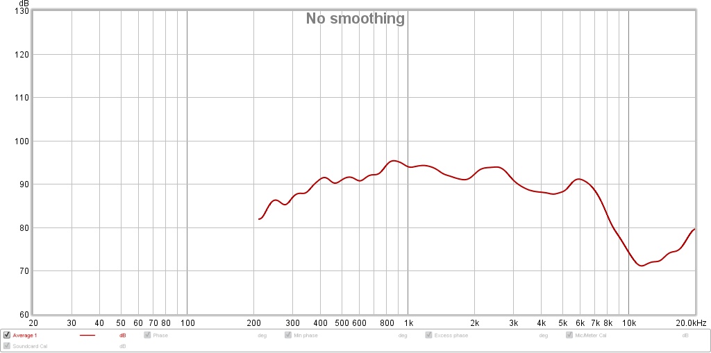

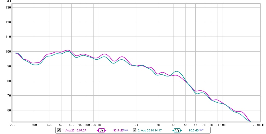

I took a series of measurements yesterday from 1m out to my listening position. Broadly speaking, the curves were identical, with just lower SPL as the distance was increased. The attached image is an average of three readings. I'm increasingly convinced it's the double sided sticky stuff I'm using.
Therefore, yesterday I glued the DA exciter to the smaller 10mm EPS panel. I may get the chance to do some measuring later today.
It may be my system, but I get vocalists above the speakers regardless of speaker height. I do pay a lot of attention to cables - all DIY including mains.

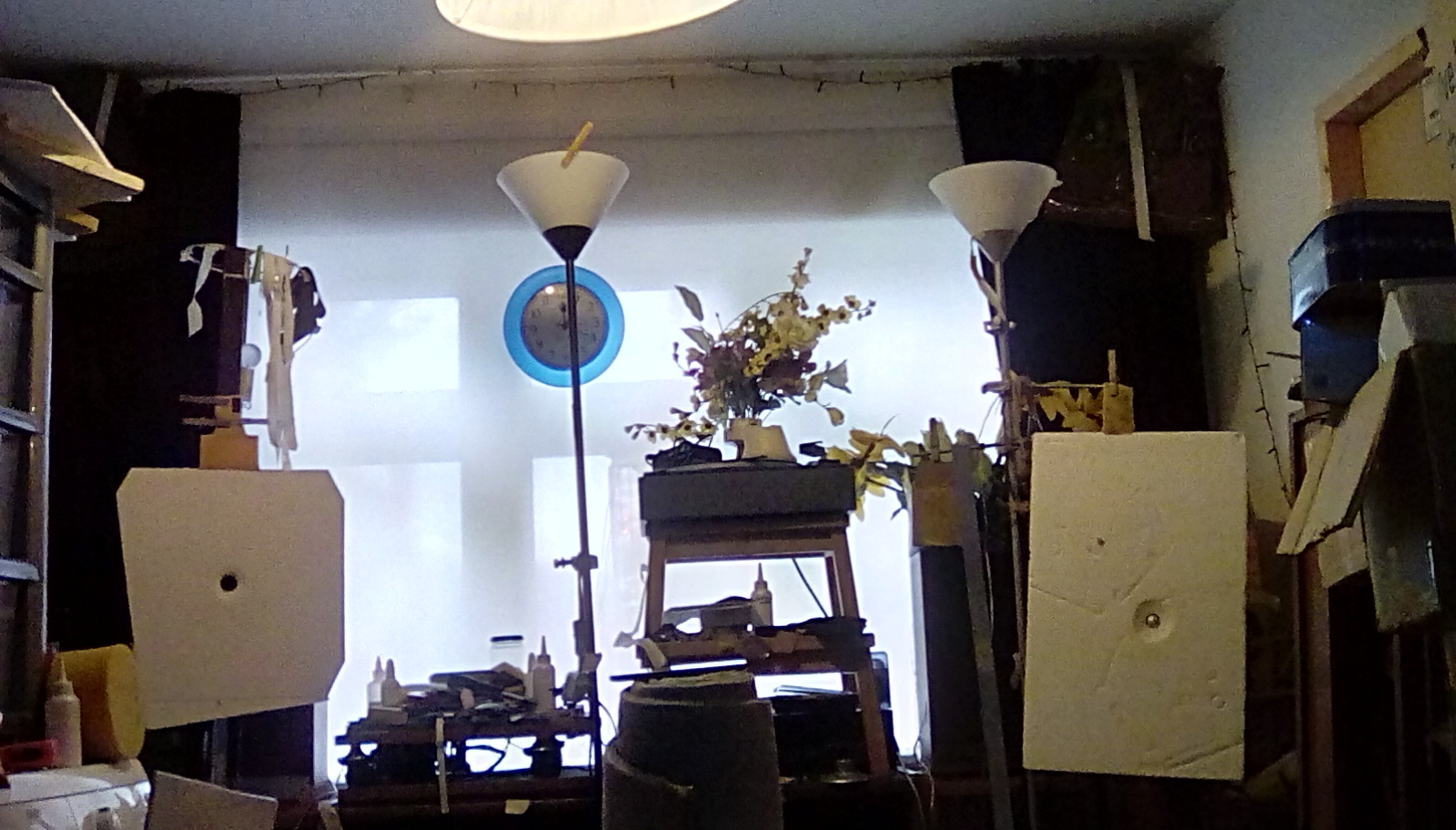

To show the problems I'm having at the moment with my room .here is a photo of the phone sitting on a rolled up rug ,used as a microphone stand, surrounded by boxes and a washing machine.
I can hardly move around the room !
The microphone is picking a lot up from all this junk in the room but hopefully it still sounds good.
Trumpets come across very well on dml panels ,they can go from very quiet to extremely loud, but the dml panels have no problem with this.
No compression, it just let's it out with ease ,
Steve.
