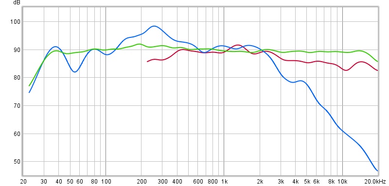

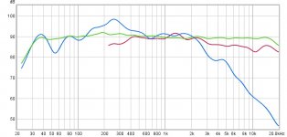

This is where I was before the exciter mishap. Green is the EQed response from my listening position for the left side, Blue for the OB bass driver before EQ, and red for the panel before EQ. The right hand speaker is a little different due to positioning.
The OB bass response curve is obviously rather lumpy. But with EQ gives a far nicer bass than a traditional box speaker.
Any extra efficiency from the EPS panels will give me more wiggle room with EQing.

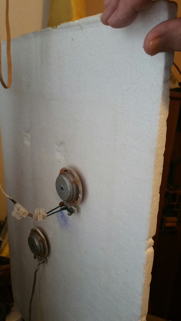

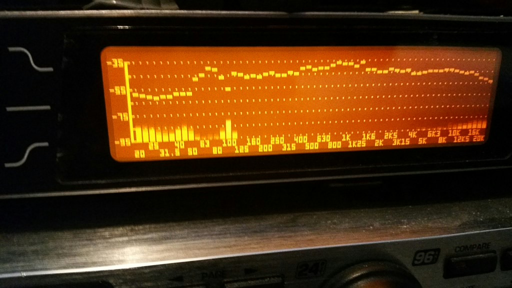

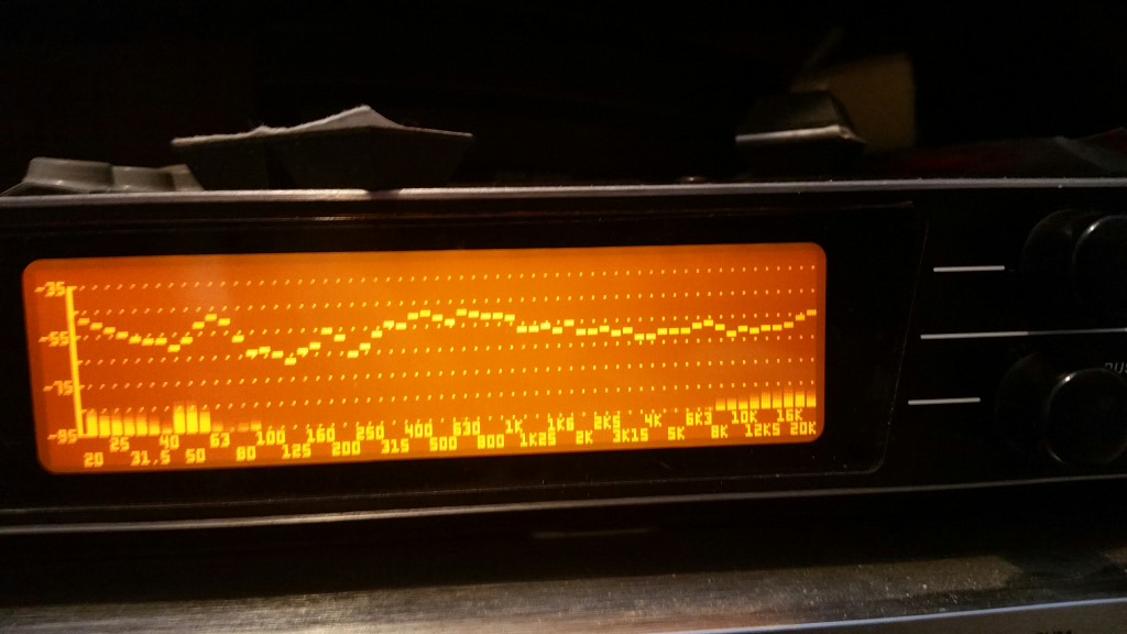

Sorry for these rushed measurements, I manged to find an old 15mm eps panel that I haven't managed to totally destroy yet.
The first picture is of the eps plot I'm not sure what grade it was as it was used for packing but definitely not as high as 70 grade.
The second the naked canvas which would have about the same efficiency as a ply panel maybe a bit more ? And shows the volume drop.

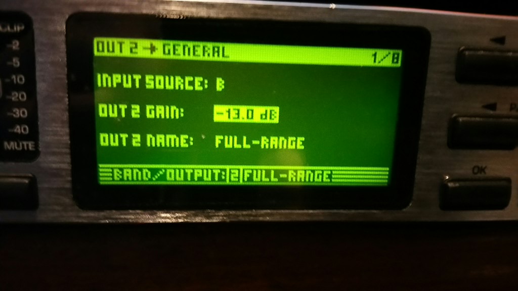

The third pic is of the 13db drop in gain to the eps panel to match the output levels.

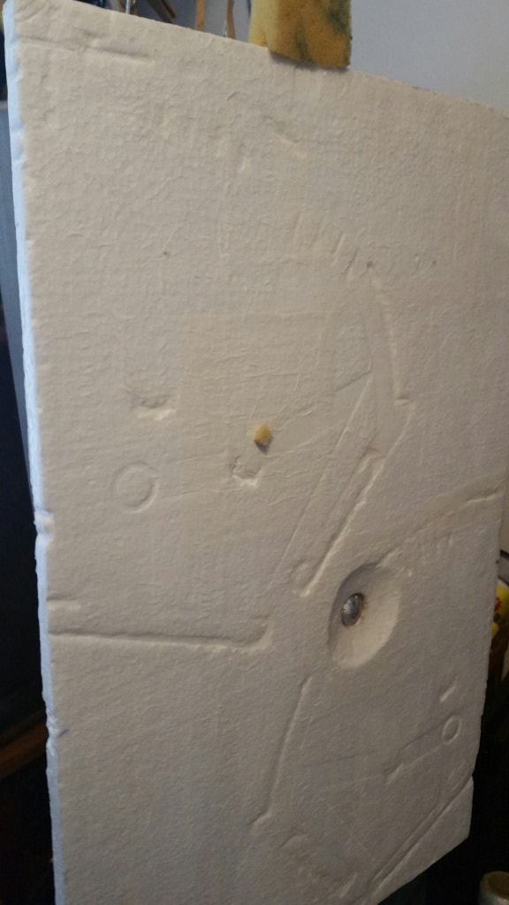

The last two pictures is of the now defunct test panel which is coated in a couple of layers of tissue (bog paper) and pva ,so is pretty heavily damped already.
The top exciter only was used for this test.
Steve

Lordtarquin.
I see the hf peak above 10k that i expect from ply but am a bit mystified by the slow roll off above 2k ?
Do you use the sticky rings supplied with the exciter ?
Could be the exciter itself of course?
And that looks like a big room suckout at about 50hz have you tried to fix this by adjusting the room or using an extra sub?
Steve.

Yes, that room suckout is annoying. The room doubles as my study and photography stuff room. At only 12 x 14 feet, it's on the small side, and with doors in awkward places. I don't have a sub at the moment and may struggle to find room for one.
It could indeed be the exciter accounting for the >2khz falloff. It's not inconsistent with the published frequency response chart for that exciter which shows a marked reduction in output from just below 2k. I used some very sticky double sided material for the fixing. For the final speaker, once my brother has found time to CNC a frame complete for me from 20mm solid black MDF, I'll probably try epoxy glue.
