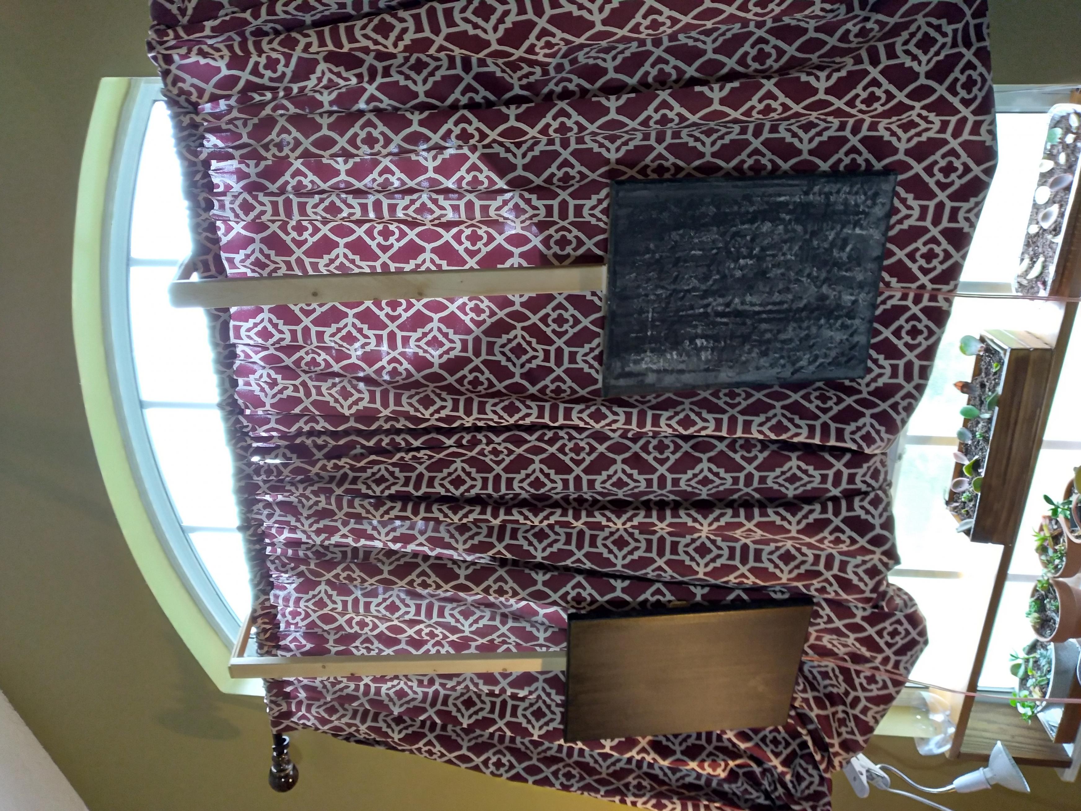

Carlmart,
If you are going to have your DMLs at the wall, you need a damping surface behind them. I have my DMLs in front of my window drapes, suspended from L-frames sitting on the desk in front of the window. I used 1/2" melamine sponges I glued together to make a 15x12" panel to go inside the drapes to further add to the damping. The total distance from the window panes to the front of the DMLs is about a foot, and I have good response down to at least 40Hz. Some variation of this setup might work for you. Alternatively, you could come off the wall either side of the TV, and this might not be too intrusive into the room. Just be sure the DMLs are not touching anything that could vibrate (such as the wires) or restrict their slight movement. I wouldn't think touching the drapes would have much effect on their sound quality.
carlmart,
My panels are 12x16". I am in the process of turning the L-frames upside down and setting them on the desk in front of the window. The ply pieces on which the exciters are mounted are 4x6", and are pieces of wall paneling from which I shaved one of the plies to make them thinner. They are about 3-4mm thick. I used acrylic paint thinned 50% with water to paint them, as I didn't like the look of the white canvas. One panel is black and the other a mottled grey. I will try to make a recording from them soon, but I haven't had much luck getting any volume to speak of when I've tried to use my phone to record. They can easily play 40 Hz.

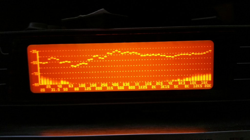

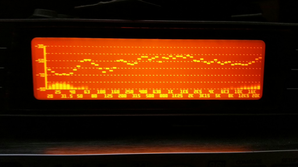

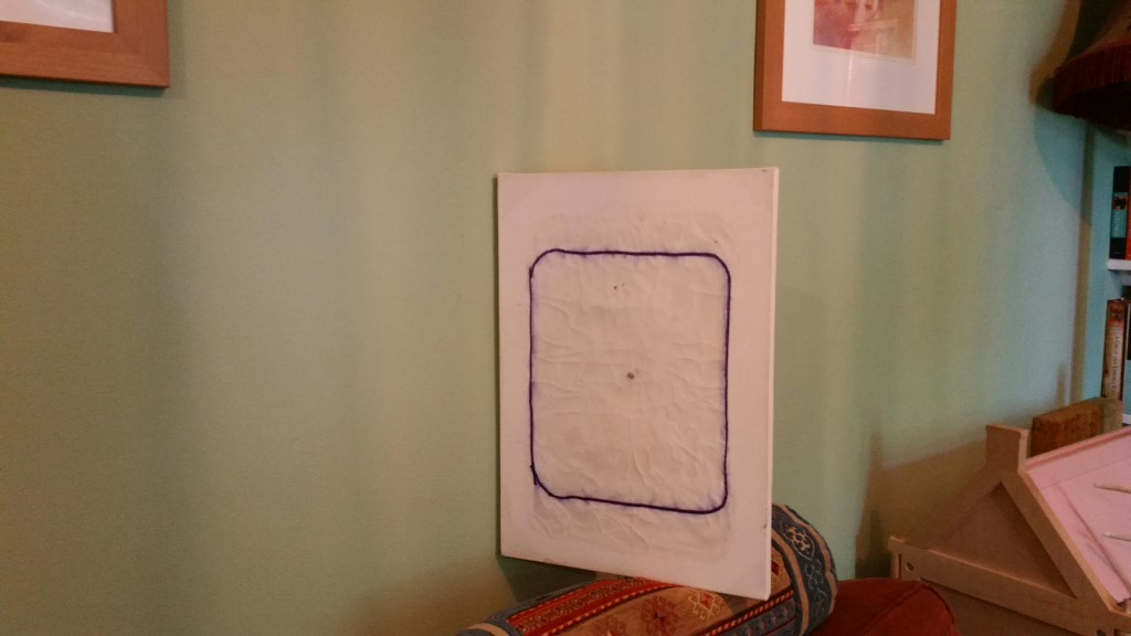

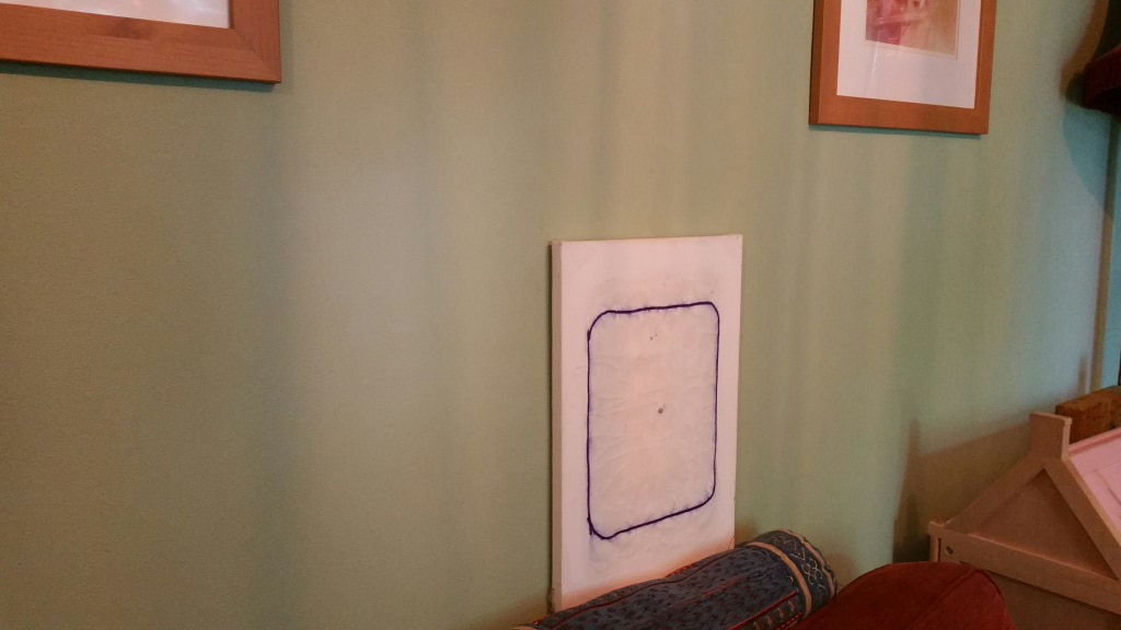

Here's some pictures .
The first is the art panel now with a coat of 50x50 pva on the front, not much change, I hoped it would shink a little more.
The second is the same panel with some wood pushed under the fame to tighten it up a bit.
The response in the 25hz has moved up to 40hz, and filled in the dips up to 125hz , this was at 12inches of course .
Still very weak below 125 hz.
The third picture is of the 6x9 inch veneer panel, very similar to the art panel..
Both OK above 125hz but the in room response of the veneer panel drops a little more so would xo about 150 to 160 .
Steve.

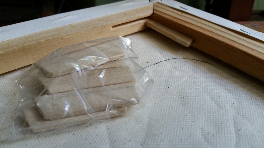

Steve,
I started out in life as an artist/painter.
I learned that one can very easily tighten a canvas by spaying or sponging warm or hot water on the back of the canvas - even a canvas with the front already sized with rabbit skin glue or primed with acrylic or PVA.
Restorers will even do this with old paintings.
That said, one can also get stretcher bars that come with a pair of small wooden keys (triangular wedges) in each corner. One can tap the keys to spread the stretcher bars and tighten the canvas.
Andreas
