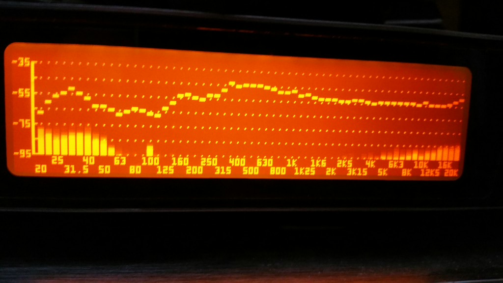

I just took a quick photo of the full frequency response of the naked canvas panel.
This is so I know what happens when I apply the pva mix.
As it is ,you can see that applying a little eq to drop the response in the 500hz region will give you a pretty flat response from 20k down to 150hz.
And surprisingly the low end now goes down to 25hz admittedly this is at 12inches distance.
So the ply could be blocking the response below 40hz are well as increasing it above this?
mmmmmm interesting.
There must be a compromise somewhere?

There is no problem getting down to 40hz with the ply and canvas panel at realistic levels,as long as you do not mount close to the wall ,but it you are into heavy loud rock you will probably have to reduce the LF below 40hz or so,to stop unnecessary exciter excursions.
EQ should not be necessary if designed correctly,
Your microphones should be great for recording your panels😀
But not sure about how accurate they would be for measuring ?
You could download pink noise to your computer ?
Not sure if audacity has test tones ?
