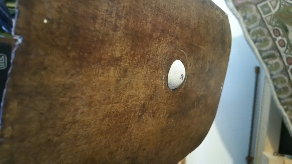

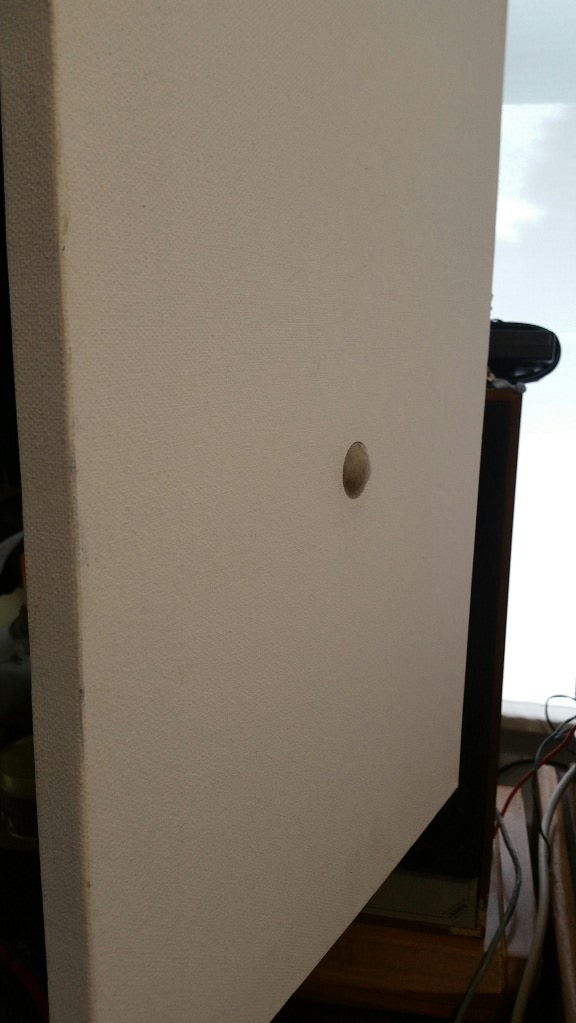

Xrk971.
Yes, I thought I would start from the basic panel and go from there.
While cutting a hole in the centre of the panel I noticed that the exciter was not properly glued to the panel(hence the ringing).
It looks like the canvas soaked away the glue, should have primed the surface first 🙄
Something to remember.

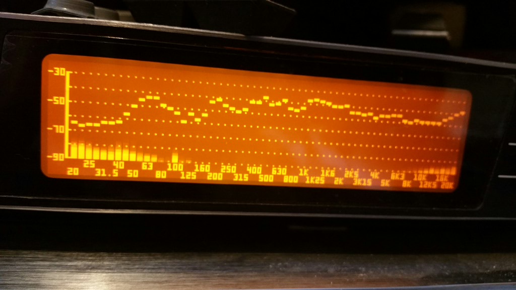

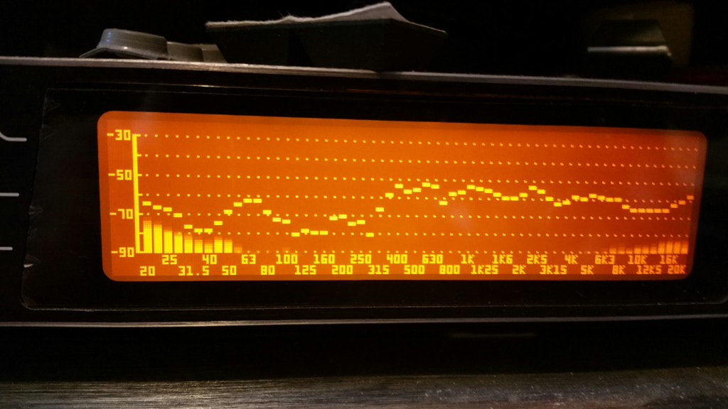

Xrk971.
I only glued the panel late last night with a dome in the middle so the hf should improve a little bit more with time.
First picture is the fabric dome not so much a tweeter more a dust cone.
This will hopefully prevent cavity noise and reduce distortions within the cone are?
Second picture is the full range response.
The third picture is the old now floppy cascamite panel full range response, all the cracks don't seem to affect the performance but the lack of ply does reduce the low end below 300hz.
So probably next I'll try coating the panel in pva and see what happens, if anything?

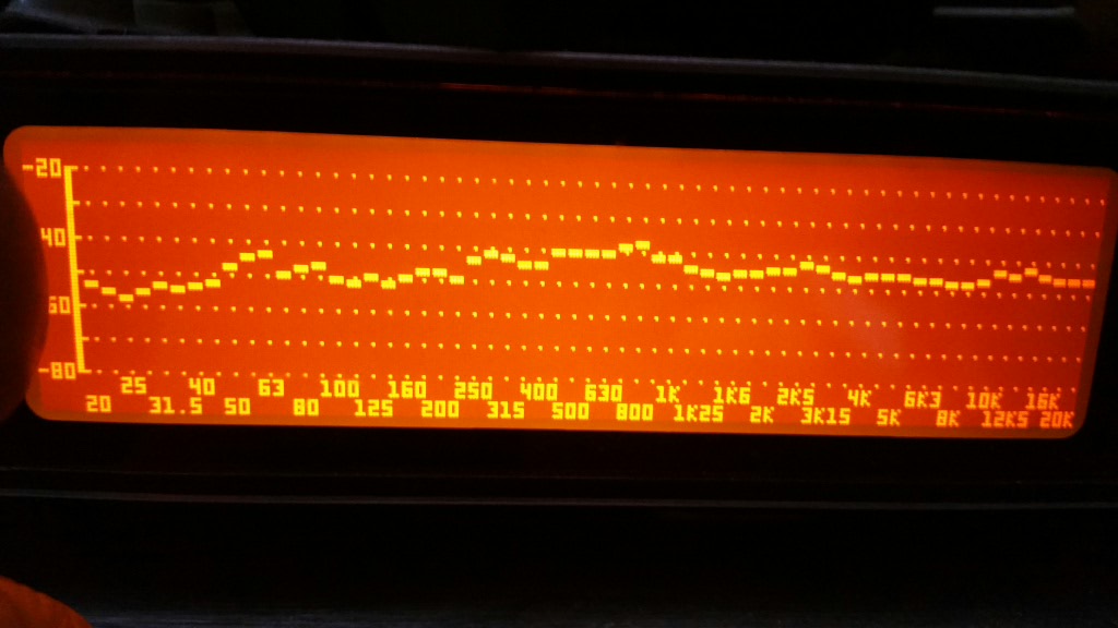

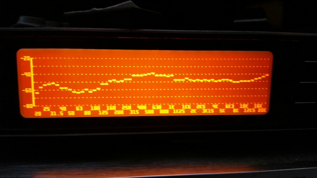

I've just attached a new fabric dome to my veneer panel ,replacing the tissue and pva dome..
First impressions are very promising, a very clean and detailed sound, although not the flattest of responses I've ever had .
Amazingly it still has a usable response down to 40hz (which I would never use it down to) which I can hear rumbling in the background.
This 1mm thickness of veneer could do well on a canvas panel ? With a little bit of gigery poker to make sure to keep the sound ?
With such good sounding small panels, i think it's getting harder to justify large panels in a normal domestic environment ?
The first picture is full range at 12inches.
The second picture is also full range but at 12ft.
Lastly the panel with dome come dust cover ?
