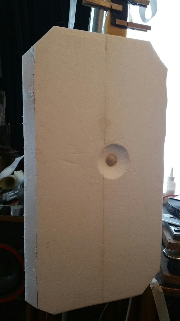

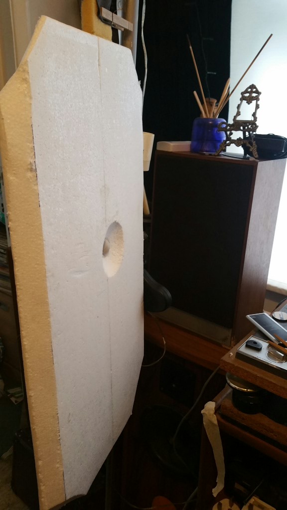

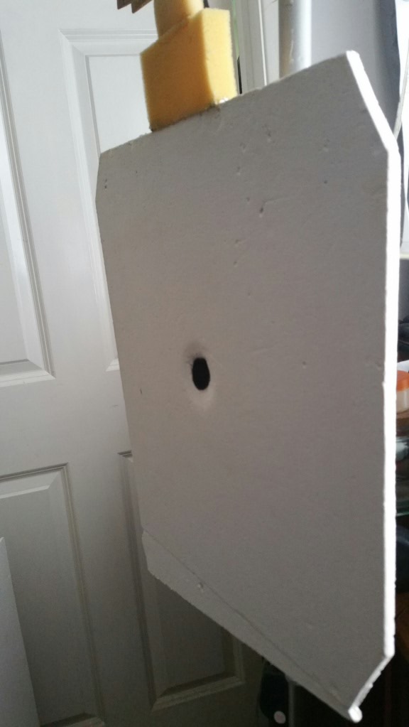

A quick picture of the chopped about eps panel.

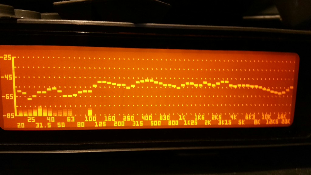

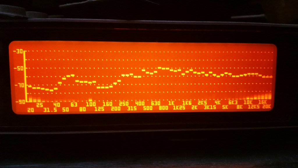

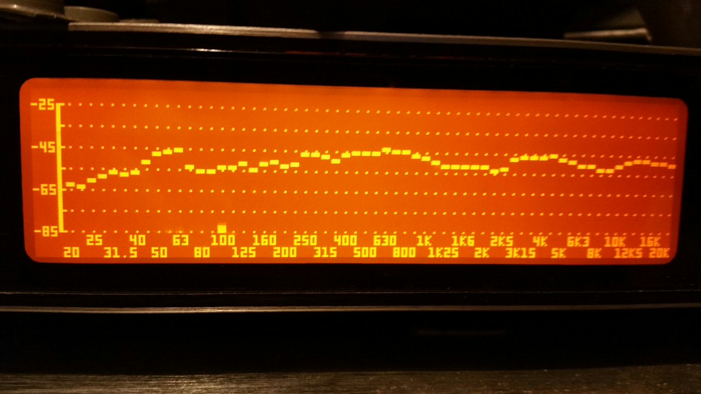

The change in response after all the alterations so far.
All taken from the side angle
The first picture shows that the peak is now a smooth extended hump with a better all round response.
But in the second picture which was of the back angle , the response is only slightly better than the original response ?
The third picture gives a better view of the carnage !
Steve.

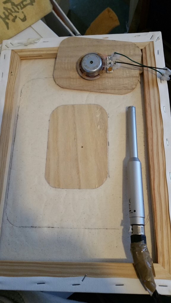

57buick.
It would be very interesting to see how a very large canvas panel performs.
Would the large areas of canvas become uncontrollable(wobble)?
Are you hoping to produce more LF from a larger panel ?
I only tested my canvas panels on the walls but found moving one edge away from the surface brought back the LF lost from the close mounting to the surface.
You have actually just made me think that ceiling mounting a pair of canvas panels can be an extra option.
Lowering one edge towards my seating area,this could even be a flexible mounting allowing adjustments?
Anyway,back to reality.
I'm thinking that there might be an optimum size for for best performance,such as in the patent I posted,it could be that less is sometimes more ?
My smaller panels approx 16x12 inches have a very strong in room response down to 40hz as shown in my plots.
And that is with a 10watt exciter.
I would also recommend a brace to support the exciter and small ply panel.
My ply panel was a 6x4inch 2mm balsa ply test panel which had a good FR down to about 600hz before attaching to the canvas,this I think is important.
What ever you do good luck and keep us posted.
Very interesting.
Steve.
Ps.
I used ordinary pva to glue the panel to the canvas, plus coating the canvas with no problems.
I'm not going to be able get that panel off of the canvas without major damage being caused.
I'm thinking about trying .0092" aluminum flashing glued to the front of a smaller 3/4" xps sheet and the exciter mounted on the front side of panel.
Maybe 16x 20 flashing over 13x17 foam and the foams bevel cut on my saw so the thickness transitions where the foam ends.
Hoping there's less damping of the highs with the aluminum and exciter in front but it's still light and efficient like just foam?
Want to make that and a plain foam panel of the same size and compare. Maybe later in the week I'm insanely busy

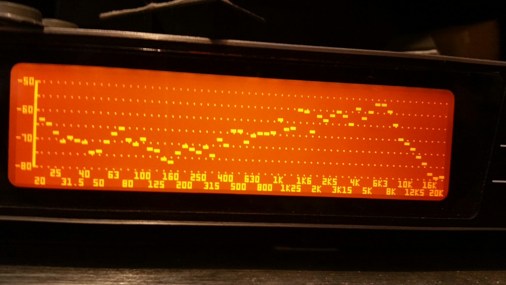

I'm just posting some pictures before I get too confused which they are?
I have taken quite a few 😀
The first pic is of an old eps HD grade 1cm panel with a flat mesh covering the center of the exciter area.
The third pic is of the response of the panel(sorry I got them in the wrong order).
The second is the response of the canvas art panel with just the thin veneer still stuck on to the canvas, the low end below about 300 hz has dropped of somewhat.
But this is not a problem for me as I use the TLS for this area.
The hf and midrange holds up well, more to come on this when I get the time.
Steve.

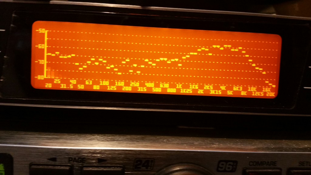

In the first picture I've managed to smooth out the response a little on the canvas panel without eq, this is at 12inches in front of the panel.
The second picture is the response at least 3m into the room, as you can see the room suckout has taken its toll below about 200hz ,as I say no problem for me, but it would be nice to get the low end response back that the 2mm ply gave.
But I am quite enjoying the mid and high performance so far,I spent most of the first day going through my cd collection.
The second day I just couldn't get the sound right it just sounded off ?
Today I noticed that one of the switches on my sub amp had somehow got tripped, I thought I was going mad and that what I had heard the first day must have been my imagination 😕
I'm not sure where to go from now ? Is it the cascamite that is helping the sound ?if so I've got problems as cascamite is very brittle and cracks badly over time.
How much is the very thin veneer?
The only thing I can think of close to cascamite is maybe fibreglass which is pretty messy.
Epoxy maybe to thick?
I'll have to think about it.
I'm getting side tracked again 🙄
Steve.
