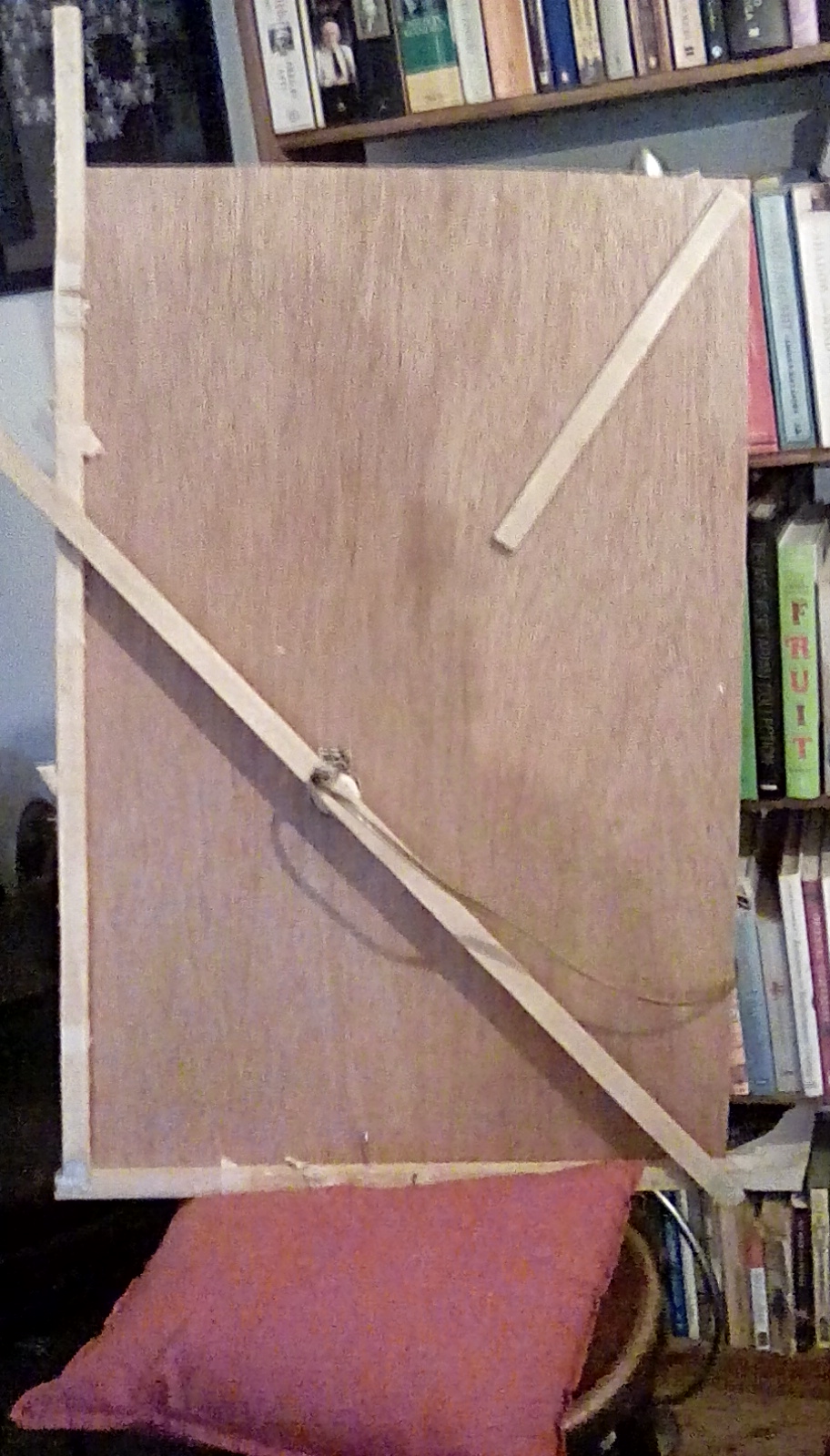

On the subject of corners flapping, this is a photo I found of my problem panel and the way I stopped the free corner from flapping.
Maybe rounding the corner could have done the job just as well ?
but the flapping was very bad,so I'm not sure ?
steve.
steve.
I should point out that the reason the flapping was made worse was the clamping of the two sides and the spine.
This created a sort of whiplash affect , a bit like holding a very long stick at one end and shaking it with the other hand,similar to a fishing rod.
All part of the learning curve 😀
Steve.

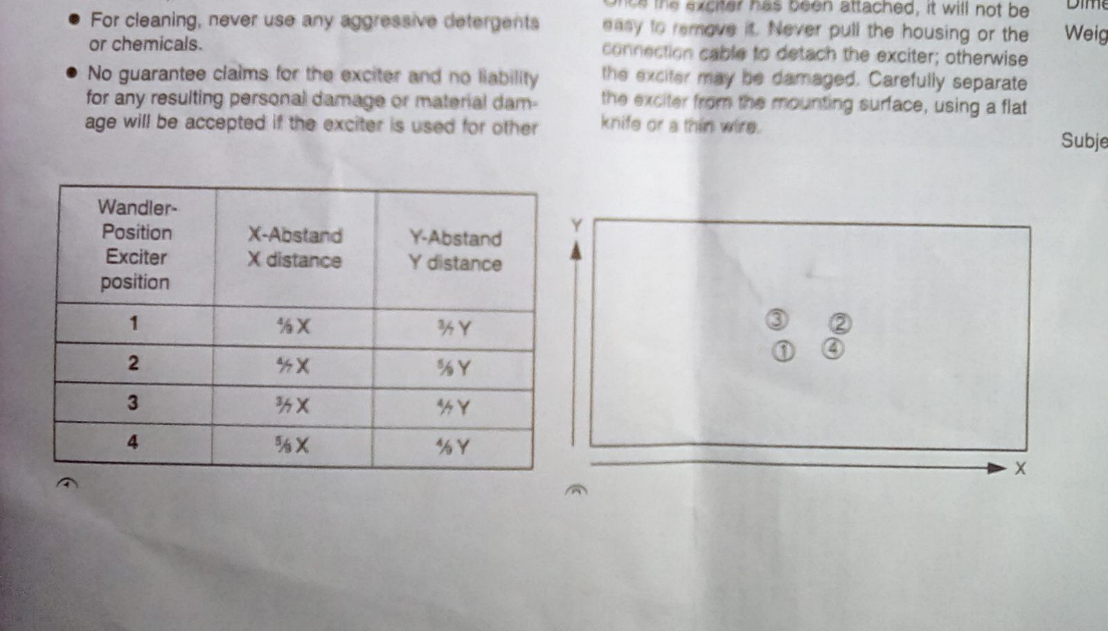

2 exciters on each form board, advice please
I have 4Ohm exciters and plan to use 2 on each 2x2 ft form board from HD, will use serial connection. My amplifier is rated at 8Ohms 100W/ch. My question is
1. will it be better to use larger board, perhaps 2x3' ?
2. is there any recommendation on where to mount the exciters on the panel.
thanks,
thanks,

Gychang.
NXT positions for mounting exciters.
Parts express have a different ratio.
Some use a two thirds method.
Take your pick ?
Steve.
thanks, not an exact science...😕
In my testing of exciter positions, not scientif and only based on my hearing, I found that there does not seem to be any real difference when using just a single excitor on excitor positioning.
I've tried the golden and silver positions of NXT, the 2 fifths/3 fifths positions of parts express, the 1/3 2/3 position mentioned by a very early experimenter (back in 2005 I believe his paper is still available in one of the long DML threads, though don't ask me where.) And I finally did a critical listening test by using a panel sitting horizontally flat held up barely by resting the four corners on 4 separate kitchen table chairs. I then visually divided the panel into 4 seperate and equal quadrants. Technically all 4 quadrants should test the same and I simply wanted to cut down on all the possible locations to test. I placed the exciter on top of the panel surface in one quadrant and slowly moved the excitor across the surface stopping every centimeter or so to listen to the output. After several hours of listening to this slow moment across the panel qaudrant in all directions, I came to the stunning conclusion that I could not reliably hear any difference in the sound level coming from any point in the quadrant. I listened especially to all the supposed nodal points mentioned by the above "scientific measurements" and simply could not with any accuracy at all hear any differences though I should have been able to hear loudness differences at the nodal points. It was just too subtle for my hearing (and yes my hearing is not the best and my top end goes up to only about 14-15K). There were a couple times I thought I could hear a slight difference in some areas that fell into the 2 fifths/3 fifth's paradigm but repeated testing just didn't pan out. From what I've read there should be a noticeable loudness difference at the nodal points but I could not hear it with any predictability.
As for further details, I tried this using the Dayton 24W excitor both with no extra weight on it and with a little extra weight on it (of course no permanent mounting of the excitor was done at any position.) I played white noise through the excitor which should have given me equal levels of sound from 20-20Khz across the spectrum so that I would potentially hit any resonant frequency node on the panel if there was one.
Needless to say I was surprised that I could not in any way reliably pick a spot in the quadrant that was "best". There may be but it must be extremely subtle and nothing like those chandra plate setups where the nodal points are explicit and very discernible. If I had more time and patience I would have put some sand or sugar across the panel and see if there where any visible nodal points.
But the more I thought about it, the more I was thinking that the chandra plate examples were always using single freq's not a broad spectrum of freq's like I used and more what you would expect from music itself. I'm definitely no expert in this field and just playing around so take what I say with the usual grain of salt, anecdotal info...
My bottom line right now is that I'm not seeing the difference that any of the mentioned mounting points is any better than another in real world usage, so I just stick to using the general area around where the above measurements claim to be best (i.e., if you plotted all three of those points mentioned and then drew a circle around them you would see they all fit into a pretty general small area and I just stick to that.)
Hows that for the scientific method lol...

Gychang and geosand.
This patent explains why the NXT positions are used.
And a lot more.
It's not about volume but the spreading of frequencies for a smoother response,with less dips and peaks
Steve.
US20060159293A1 - Acoustic device
- Google Patents
And a lot more.

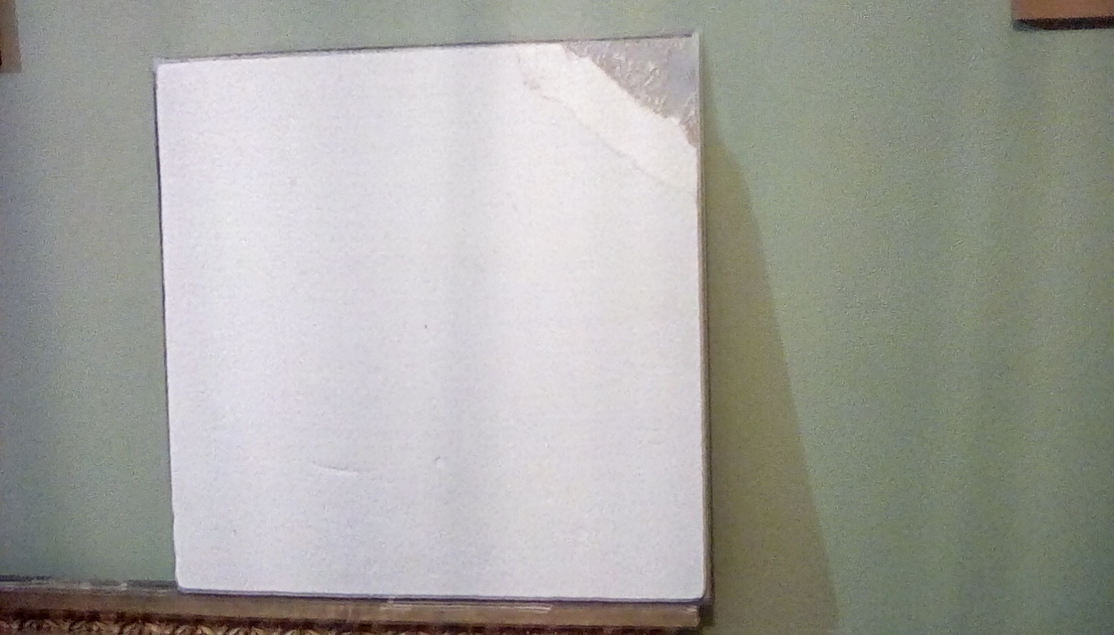

Whyme1.
This is a very old panel that has been bashed around a bit over the years.
It is 0.5 mmm Ali and 5mmm eps glued together.
Should have thrown it away years ago.
This is a heavy over damped panel.
Steve.

Whyme1.
The speaker in the photo is a BES .
Which is a sort of hybrid which has a bass mid ,a mid and a piezoelectric tweeter.
There is no sheet Ali involved .
The large panel is pretty thick in the centre exciter area and thins out towards the ear shape .
Steve.
