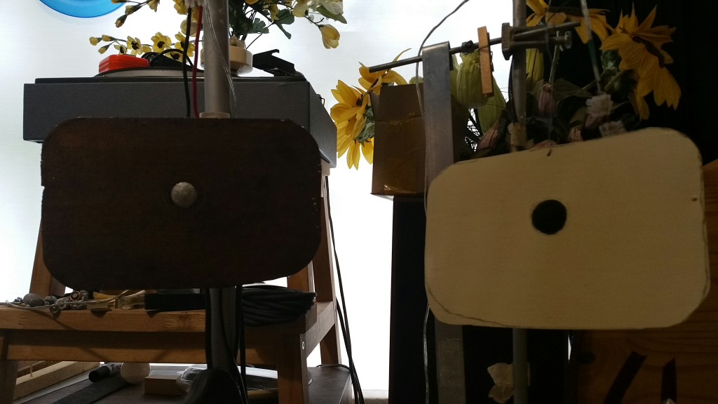

Something I did notice a couple of days ago, while cutting up one of my old card panels to match the basswood in size and shape.
I level matched the two panels close up by ear and deq, but when listening to music the card panel sounded thinner or lacking ?
So I was turning up the volume to correct the balance , but it still didn't sound correct ?
The only difference between the two panels apart from the materials was that the basswood had its long edge at the top and the card had the short edge at the top.
After remembering a comment my friend made (a couple of years ago now,have not seen him because of covid 🙁 doesn't time fly ) about preferring the sound of his panels on their side,I turned the card panel on its side to match the basswood, and hay presto the imbalance was corrected.
Obviously turning a large panel on its side isn't going to be conviniant for everyone ,but I will probably at some time test this out just to see what happens?
I have noticed that pro panels seem to be mounted on their side,so now I think I know why ?
I think in one of the nxt patents they mention making panels 5% out of square, maybe in the future I will be doing this with a slight twist, we shall see ?
My microphone was picking up slight differences in response as were my ears , but nothing too drastic but all the same interesting.
Just thought I'd share this,in case it is of any use to anyone?
Turning the panel on its side is another freebie that could improve things ,maybe ?

rounding corners
It does not really matter on if you round or scallop the edges since it is only the longitudinal motion that generates sound.Transverse waves do not generate sound.There seems to be a lot of confusion in what waves generate sound. It like in the early days of nuclear physics where the electrons orbit the nucleus of the atom. It's a simple model but is wrong. For electromechanical sound generation it a piston motion that generates sound and not any transverse waves that are traveling on the surface. Sorry for the reality check but its physics:ashamed:
Hi Tagis,
The corners here can make a difference because as the thread title is called Distributed Mode Loudspeaker (DML), and not pistonic mode loudspeaker. A sharp corner vs a 0.5in radius might not be too different, but a 3in radius probably will have an effect. This is because the traveling longitudinal waves is what makes the membrane vibrate. Even for traditional drivers in pistonic mode, when they go past pistonic mode and enter breakup mode, it is indeed the transverse modes that dominate the sound. That’s exactly how DMLs operate from the get go. If they were pistonic, they would act as a dipole but in fact act more like an Omni. So the best way to see this is to simulate it in FEA an look at the transverse modes and how shapes and corners affect it.
